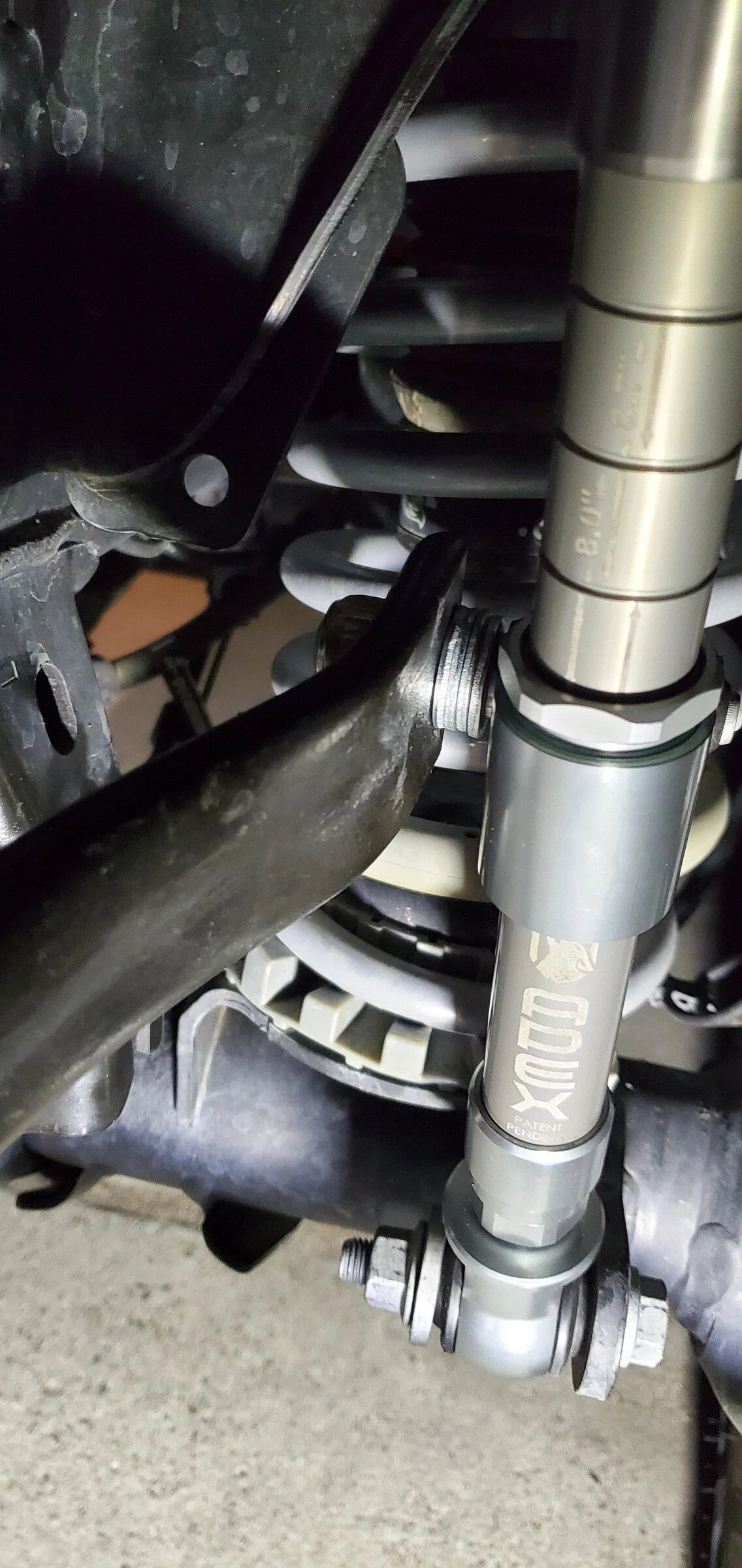

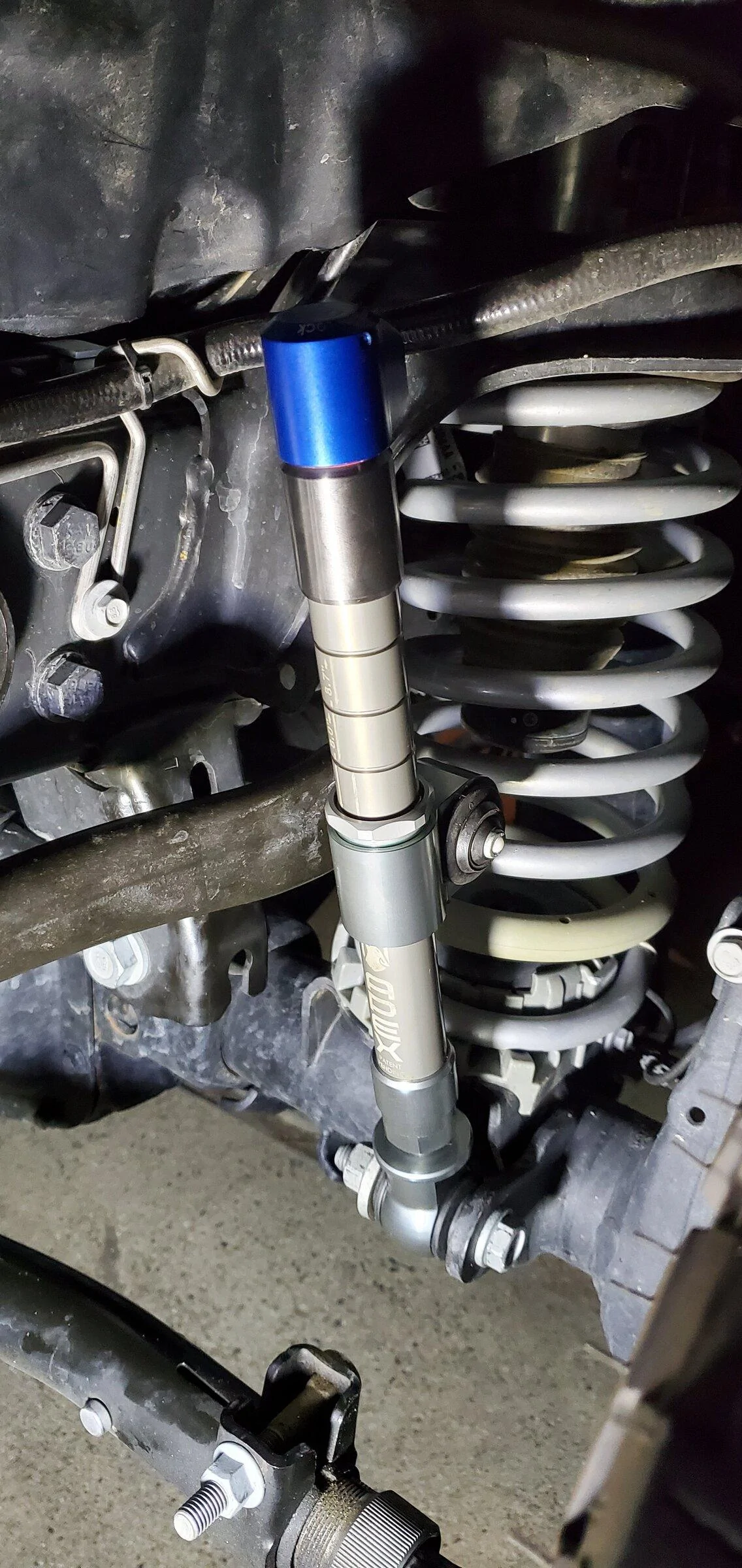

Got them in. More of a pain in the ass than I thought. Some notes on a stock Mojave:
1. Mojave end links are 5" center to center. The shortest length on the 8.0 autoLynx is 6.5" so I used that. It put the swaybar up beyond parallel but not much.
2. They say in instructions to rotate the wolf logo to the front, so the lock knob faces forward when unlocked. I guess my knob wasn't put on right. You can fix it by loosening the two Allen screws on the sides of the blue knobs. The knob is spring loaded so hold it while you do this and keep holding it while you orient it correctly.
3. I couldn't get both autoLynx on while locked. I put the first one on after raising the swaybar up since the link was now 1 5" longer. Bolted it on and torqued. The other link wouldn't line up so I unlocked the mounted one, raised the swaybar, and mounted the second link. After it was installed, I locked the unlocked side, went for a drive, and it relocked itself.
4. I used 4 of their washers per side. If I didn't the link would be tilted, a lot, towards the center of the truck. They say that is fine but I put the washers on and lined it up nice.

It looks like your knob when locked is facing rear, it should be facing front, although I’m tired so I could be wrong. Mine were specific passenger and driver side, …….Jack
It's unlocked rear locked front. Without me adjusting it, it would have been locked left unlocked right.

Oh, ok. It’s me being tired!….Jack
