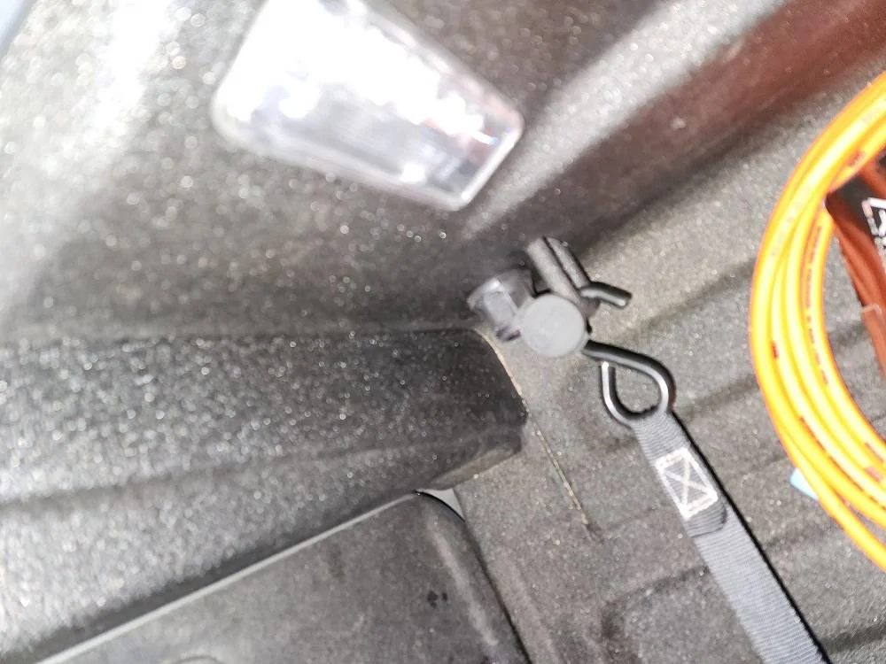

2021 Jeep Gladiator Willys
It was a pita to tighten from the back.
Jeep Gladiator ARB Twin Compressor Installed -- mounted under bed, above spare 20230906_113624
