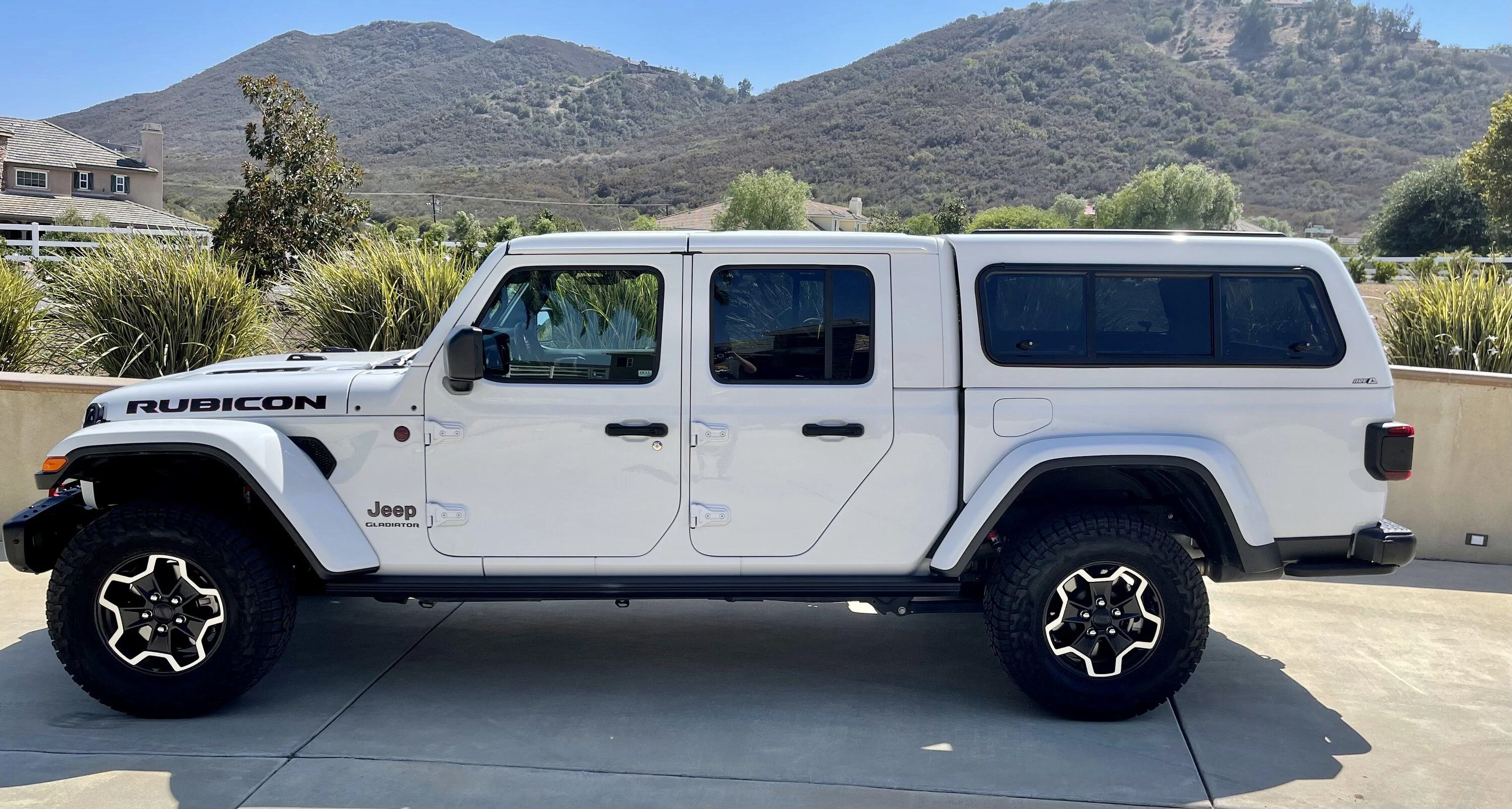

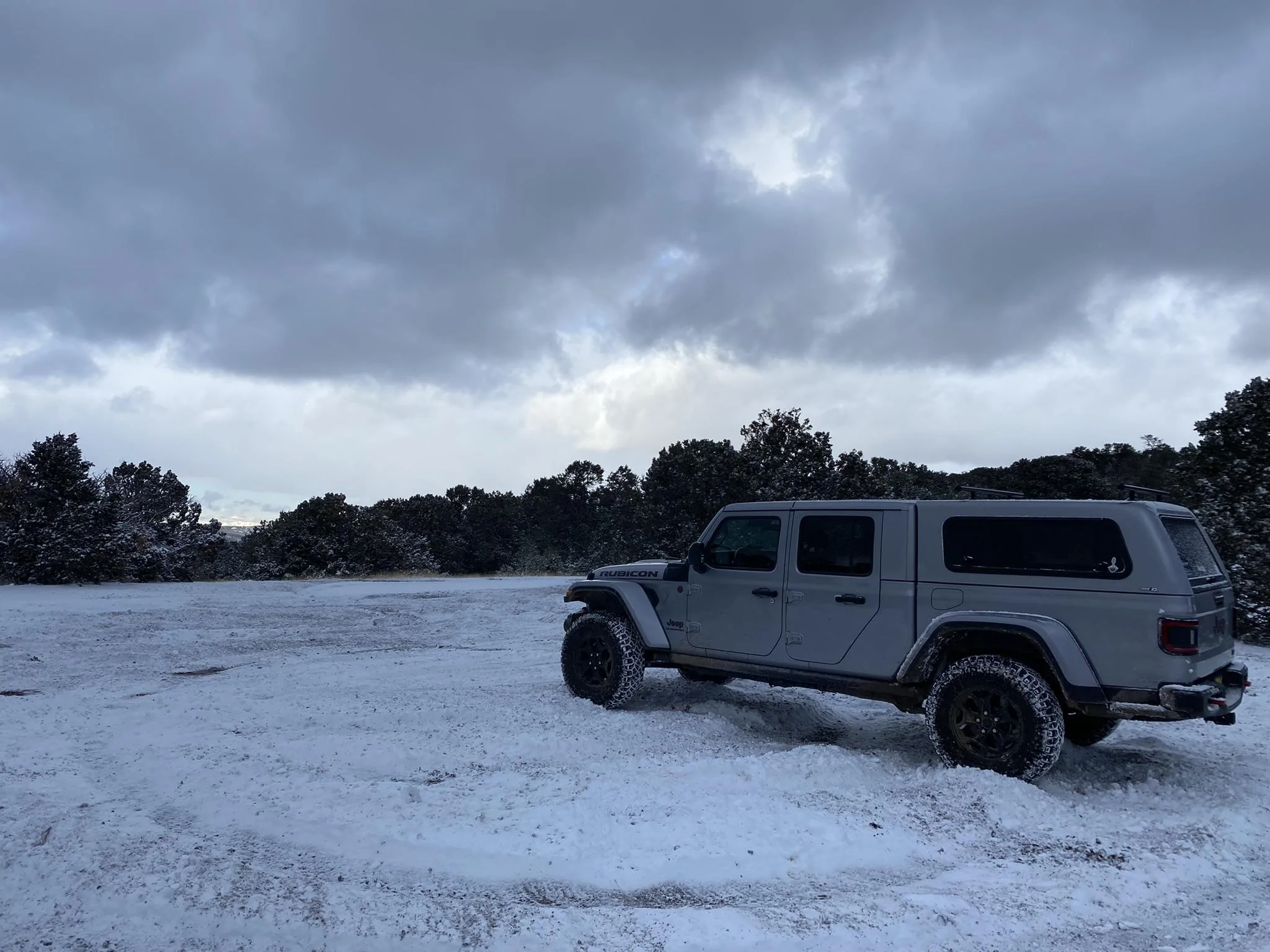

I did not have to do anything to the stock Rubicon suspension(pretty soft). I ran it like this for a year and it never dropped because of it. They only weigh about 175 lbs.
Jeep Gladiator ARE Bed Cap Topper weight requires upgrading to taller rear springs / spring spacers? BC190FBE-583F-497F-B202-CB9BAA622069
After AEV 2.5” lift:
Jeep Gladiator ARE Bed Cap Topper weight requires upgrading to taller rear springs / spring spacers? D2650FE9-C931-46CC-A9E7-342F1D3F2A06
Nice looking truck. Rubicon springs are pretty soft. I hauled 900 pounds of bricks and bottomed out pretty good on my driveway lumps and bumps.

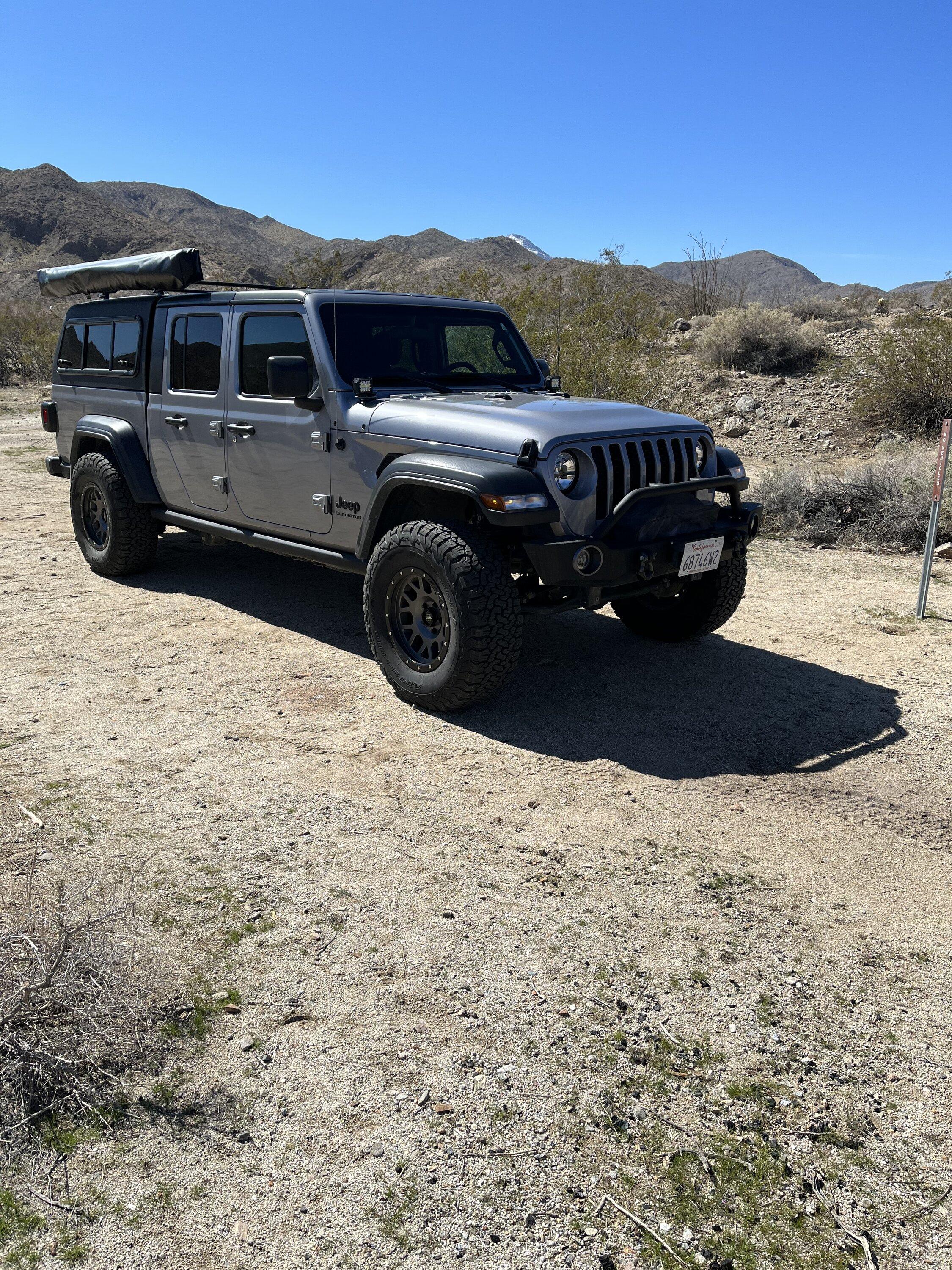

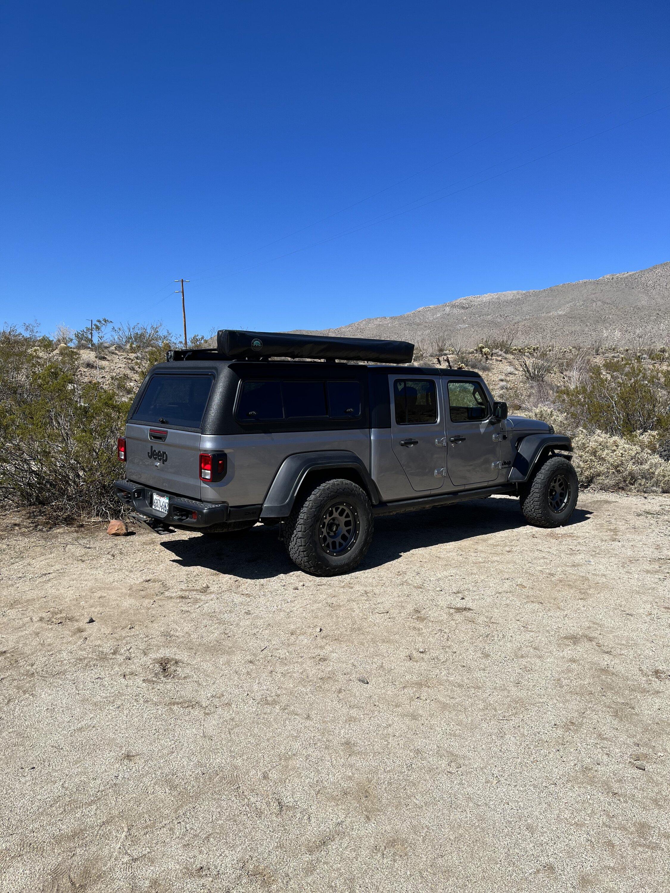

mine sits level with the shell on...Teraflex 2.5 front springs, arms etc- stock Max Toe rear springs and spacer- I do get a very slight squat when fully loaded down for camping but never hit the bump stops.
Jeep Gladiator ARE Bed Cap Topper weight requires upgrading to taller rear springs / spring spacers? tempImageSkuN71
Jeep Gladiator ARE Bed Cap Topper weight requires upgrading to taller rear springs / spring spacers? tempImageQCqUzE

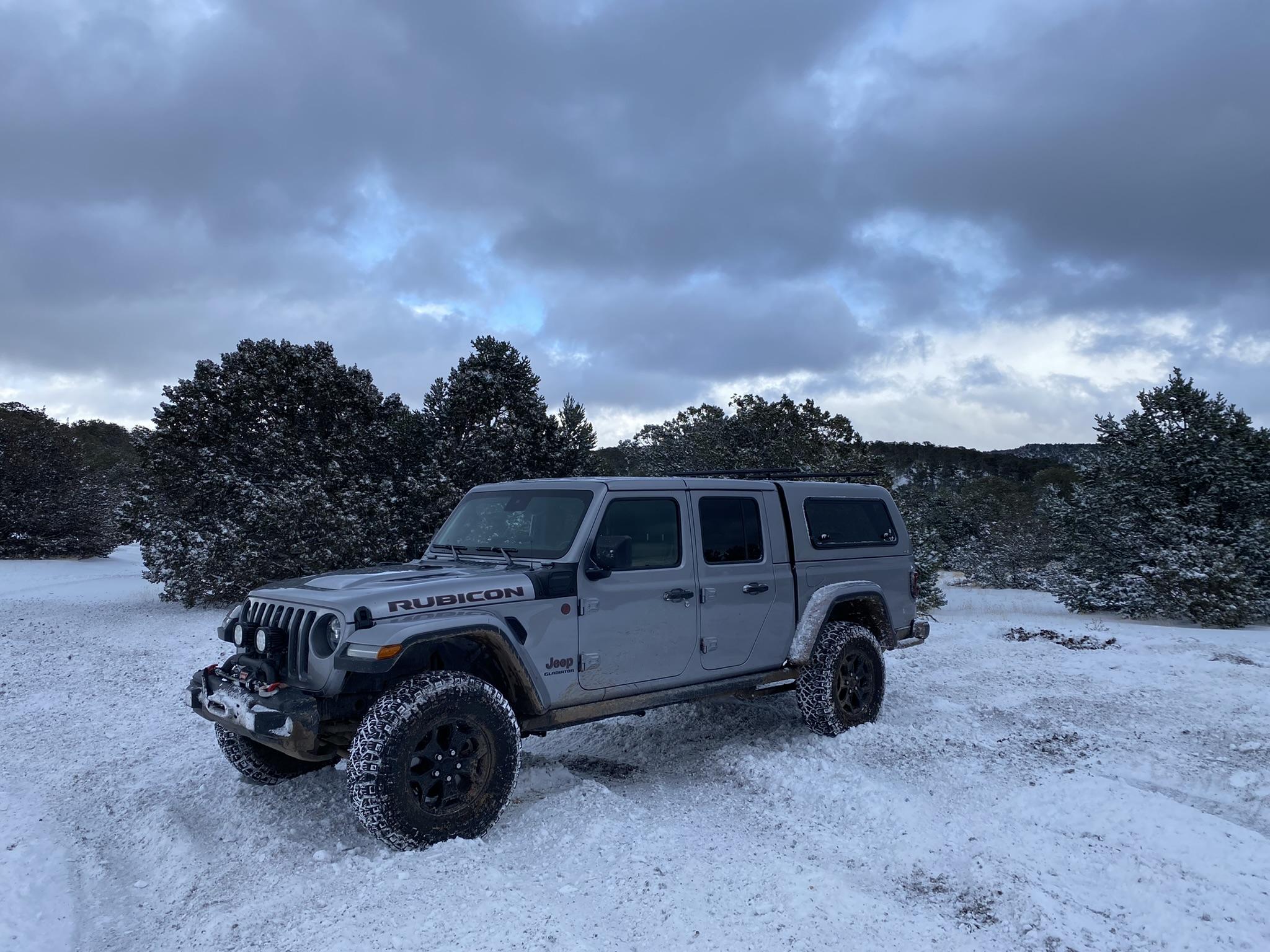

Mine didn’t need any leveling after the cap was added. Rubicon on stock suspension with Tera flex leveling.
Jeep Gladiator ARE Bed Cap Topper weight requires upgrading to taller rear springs / spring spacers? 55FA506F-5B84-4DE4-85B4-3A54C12F3961
Jeep Gladiator ARE Bed Cap Topper weight requires upgrading to taller rear springs / spring spacers? 664222E1-CF99-4C8A-915D-3B88B0F3C5A4

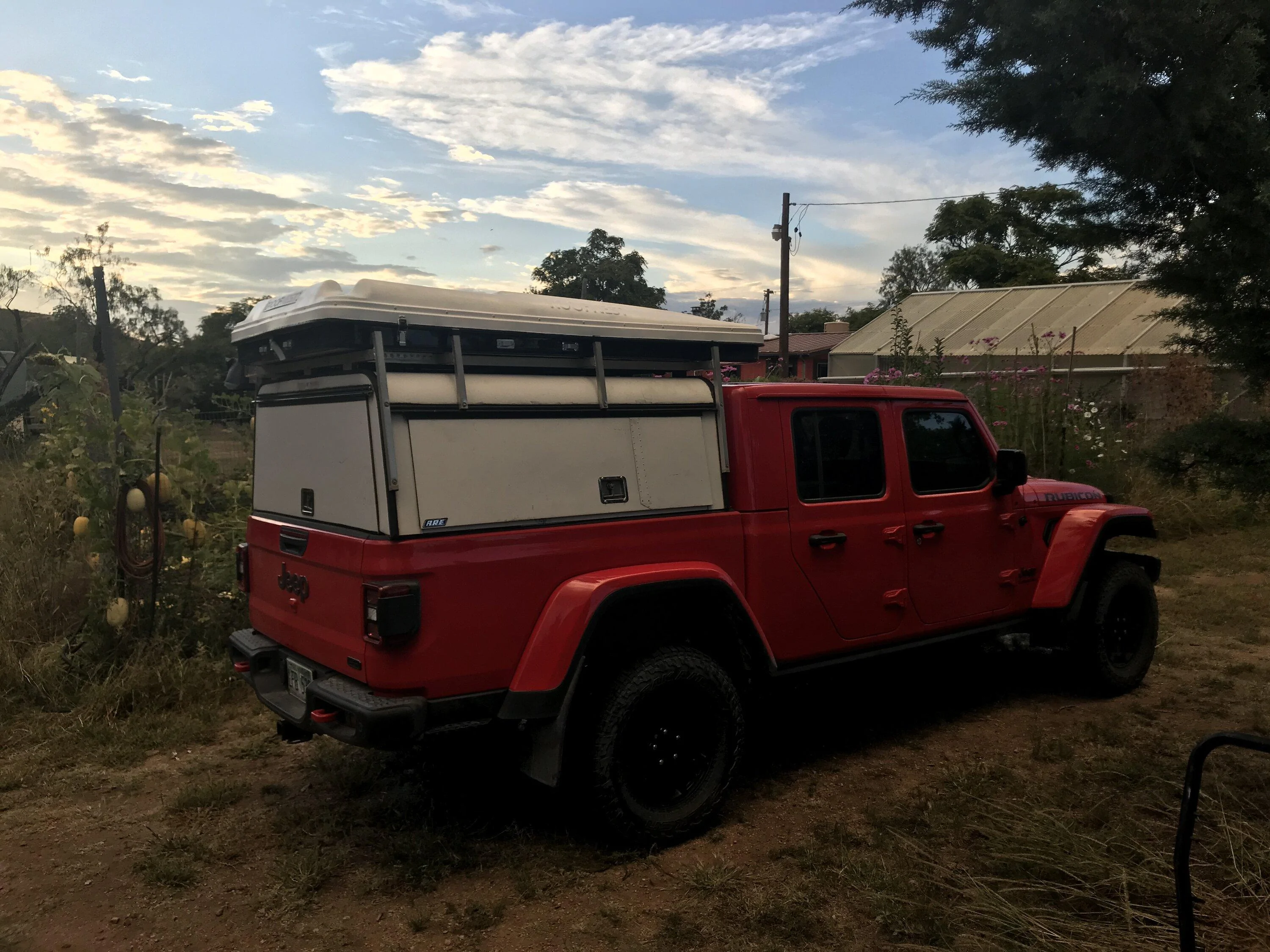

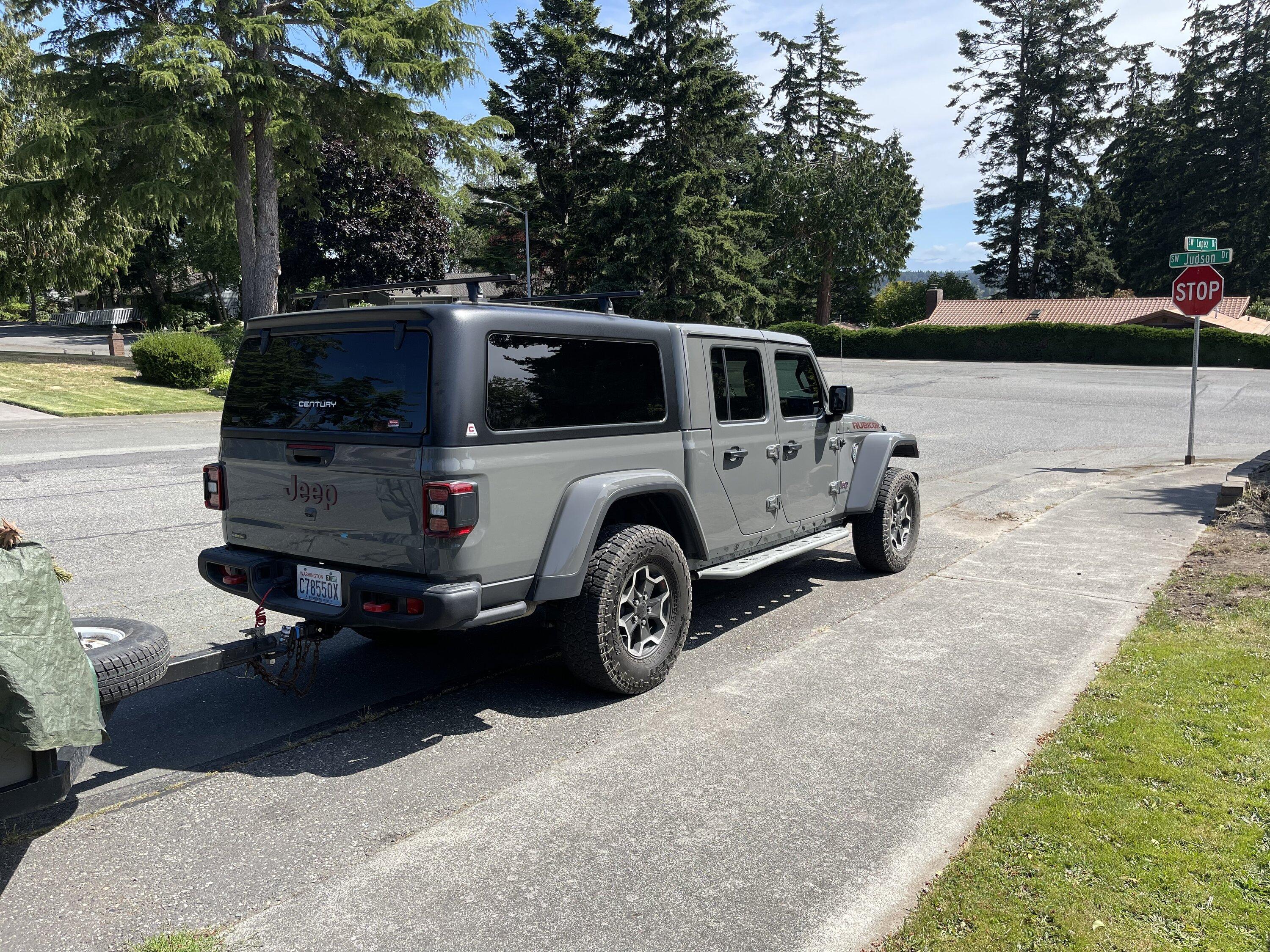

Sorry to hijack….
how are you guys mounting your canopies? The leer/century mounts suck in my opinion….Washboard roads- even when going fast enough to “smooth” out the bumps, leaves me with having to recenter the canopy tighten down the mounts etc.
I might be going with through bolts here soon… (through the canopy and through the bed rails…..)
just curious if anyone has come up with a better solution before I resort to a crude but simple answer.
Thanks! ???
edit- photo added. If I could do my top over again I would go with the go fast racing camper setup…. Will likely go this rout next year anyway…

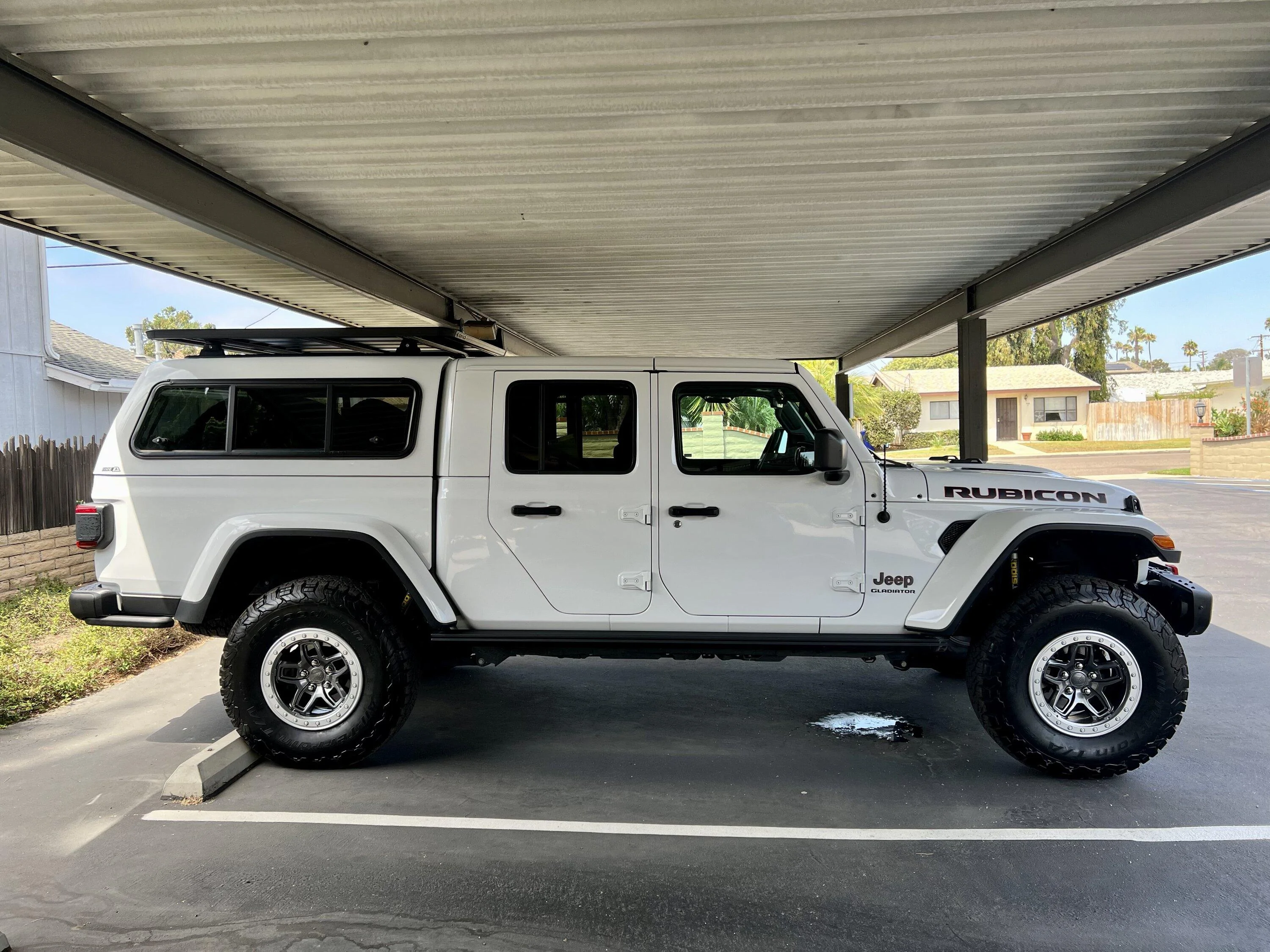

One nice thing about the topper (Alu-Cab here), is that the extra weight leveled out the height in the rear to match the front. No need to purchase a leveling kit here (stock JTR). Or it was an overpriced leveling kit…depends on how you look at it, lol.

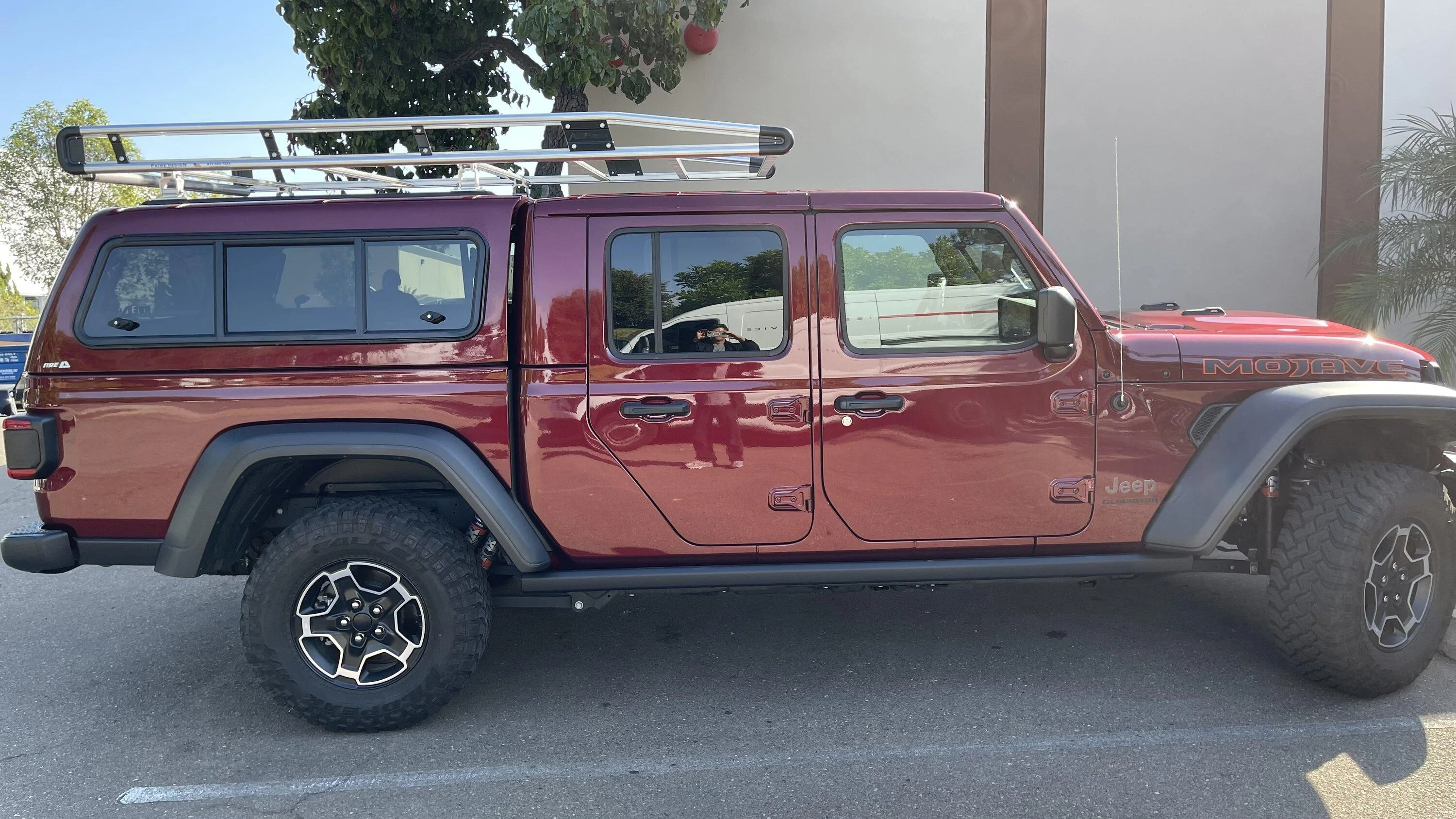

The ARE cap plus approx 65 lbs rack did not affect the rake on my stock everything Mojave at all. Thank God the front is still an inch lower than the rear.
Jeep Gladiator ARE Bed Cap Topper weight requires upgrading to taller rear springs / spring spacers? 5348757E-2DAD-4D34-88D9-0C58E6A7B42A
