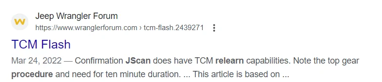

JSCAN, and possibly AlfaOBD should do such a thing.
I've found various references, and have seen it in JSCAN itself. Not positive if it's for the 8 speed or not.
