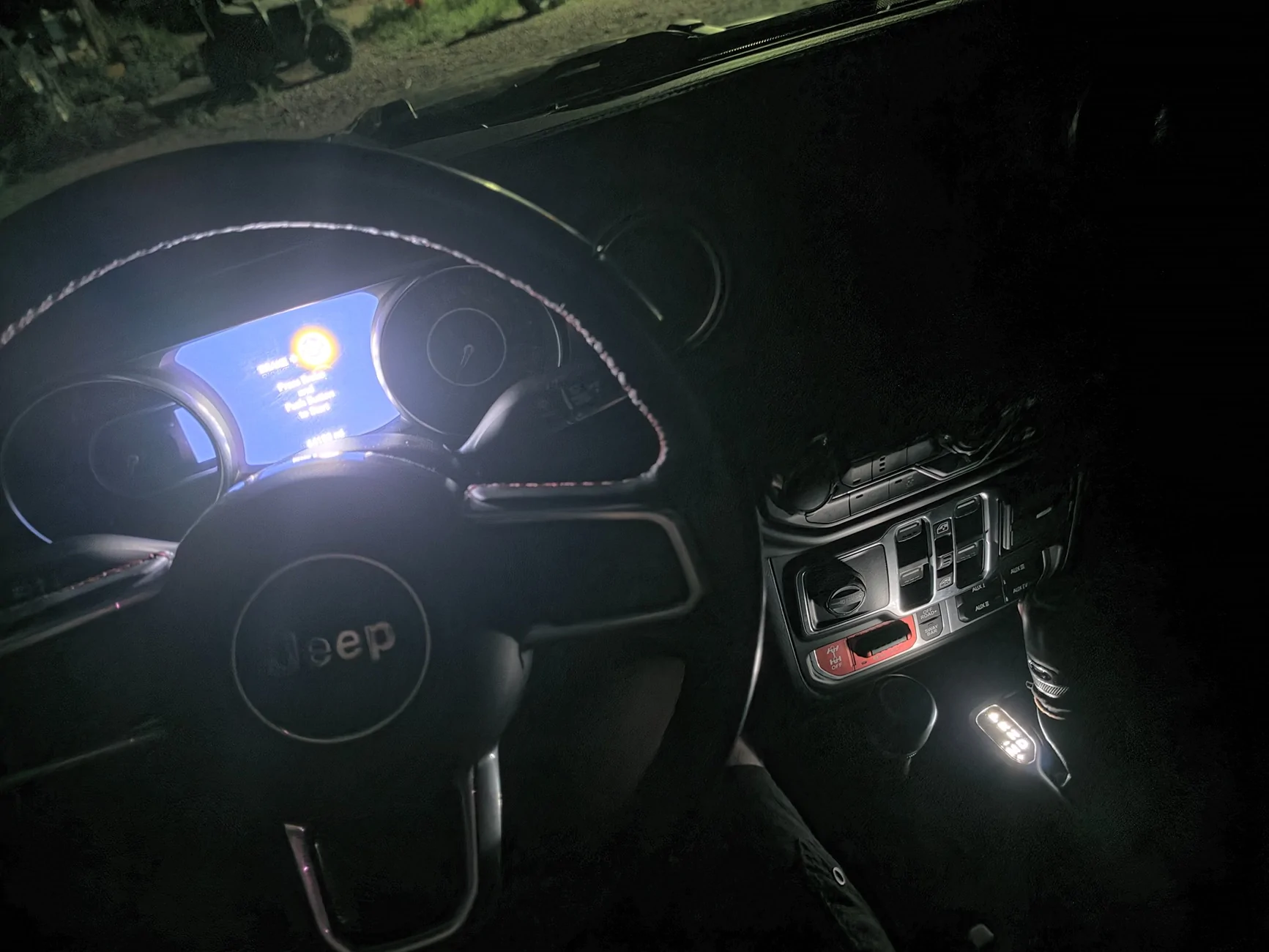

Yeah I have the doors locked currently. And key fob over 100ft away. I'll take a picture of the dash lights that are staying on.

Hmmmm….module malfunction …or, I’m now thinking the dash is staying awake due to a settings option in the dash. If anyone knows, @StanH knows the settings better than anyone! (Throwing up the bat light again!)

Does the dash stay lit forever or shuts off after select time, every time? You’ll definitely want to keep a charger on that battery till you figure it out.
