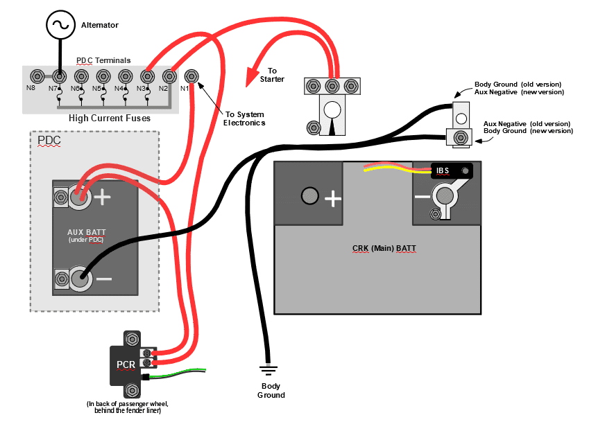

Three years ago I deleted the aux and simply ran the aux cables to the main batt terminals. Been working like a champ ever since. I doubt that is the problem. Though I did attach the aux negative to the main rather than tape it off as this person did.
Could have worded it better I guess but I was more worried about something ground or touching that may have toasted something like the fuse array.
More than one way to skin a cat when it comes to the Aux Battery disable/delete. Some are just cleaner than others IMHO.

You did what? There are 2 cables on the positive of the aux battery. Note that the positive of the main and the positives on the aux do not got to the same post on the fuse buss.
Jeep Gladiator Aux battery delete now issues IMG_8419
249
40,587
54,247
I never understood that fuse bit. Why?
They make things so complicated.

I would cut the guy some slack. Probably one of the first posts on it back in 2018 after the JL launch and it was pretty much BETA testing back then figuring things out.
Most to include me would evolve from using a fused jumper from N1 to N2 to a non fused jumper from N1 to N3.
He still has the good idea of having a fused jumper with eyelets and couple wing nuts in a trail bag in case one of the fuse array legs blows as a temp patch until a new fuse array can be sourced and installed.
I was just wondering why the complexity, not a smackdown. Nothing taken off of that has a fuse, and N1 has no fuse going to it.
I carry a large gator clip. It will connect two adjacent posts. (and can be handy for some other things).
I already have wingnuts on a couple of those posts as that's where I have connected the power steps and such. I don't like a lot of wire going to the positive battery post and since those are hot all the time, they are perfect posts for small amperage accessories (won't use the one for the EHPS or the fan)
I also tend to not deal much with the Wrangler side - very very different attitude, and there's still a whole lot of believe that the aux battery ALWAYS, and I mean ALWAYS goes bad, and it ALWAYS takes out the main, and the main never ever goes bad first, it can't possibly, among some other weird beliefs there that just won't die. It's a different bunch. I avoided doing much discussion on the Sunrider there because of some of the crap they are hooked on - and even when presented with quotes and pictures from Bestop - they just can't believe it.
When I encountered my “battery” problem, all I had was a high voltage reading off the alternator all the time. I was sure it was that damn “aux killing the main”. I was proved wrong.
My 2 year old Optima main was going south taking out the aux. Taking out the aux, leaving its entrails in place taped up and zip tied, main battery replaced, fixed it.
just looking at the diagram, and not yet doing any research, it appears that you are feeding power from N3 to N1. I’ll have to look it up to see how N1 is otherwise fused.
If you find a fuse between the auxiliary battery positive and N1, let us know. I've not seen one in the schematics (from FCA) but then, I've not looked at every single line in those, either. It appears to be direct - but, the schematics would show if there's a fuse somewhere.
(OR, a fusible link which was very common in the past)
