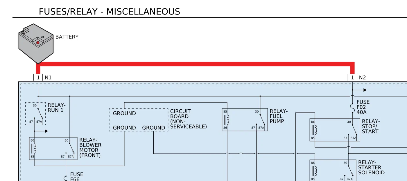

If you find a fuse between the auxiliary battery positive and N1, let us know. I've not seen one in the schematics (from FCA) but then, I've not looked at every single line in those, either. It appears to be direct - but, the schematics would show if there's a fuse somewhere.
(OR, a fusible link which was very common in the past)
I’m thinking as I’m writing and it’s not going well. I bet F42 is for the power to operate the relay, not the power being passed through. If that is true, then you are right.

Looks direct to me! Battery positive to N1 and N2
Yes, F42 is for the relay that operates the PCR that separates the two batteries.
The relay that F42 is handlig is on the PCB in the PDC
F42 feeds PCR control relay on the PCB.
When the PCR control relay is energized, it feeds the coil of the PCR and it opens the circuit.
F42 pulled, then when the PCM closes the PCR control relay, it can't feed power to the PCR itself even though the contacts are closed. The PCM sees nothing wrong because it has energized the coil of the PCR control relay, but there's no power going through the control relay on down to the PCR.
(love this stuff)
It's a relay that operates a larger relay. The PCR Control Relay feeds power to the coil of the PCR itself as the PCM can't handle that one directly, but can handle the smaller PCR control relay on the board in the PDC.
