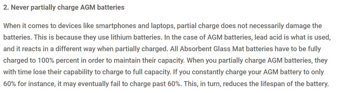

From one site -
discharging and leaving the battery discharged can cause harm and shorten life in AGM batteries. Have you heard about sulfation? It's not pretty stuff. Riding your vehicle often, can keep the battery in top condition. If you're not going to use the battery for a week or more at a time, we highly recommend a charger maintainer (also called a trickle charger) to keep the battery from discharging
And from another site on batteries and the EXACT thing I've been talking about -
By now, many sailors have enjoyed their first long weekend on the boat this year, and some may have noticed that the expensive absorbed glass mat (AGM) battery they bought last season or the year before isn’t holding a charge like it did when new. There are many things that can lead to reduced battery capacity in an AGM battery, but most often the cause is due to poor maintenance and charging regimen.
Battery manufacturers want their batteries recharged to 100-percent state of charge after each discharge. In reality, few cruising boats (or any boats kept on a mooring) return their batteries to 100-percent state of charge after each cycle. This typical battery use, or abuse, is called partial state of charge operation, and if it continues, a sailor can see his AGM battery perform noticeably worse than a less costly, deep-cycle flooded battery bank. This isn’t the battery’s fault; it is just a lack of understanding of how to properly care for an AGM battery.
and from the same people, exactly as I said -
Here are some tips that came out of our test that can help you prolong the life of your AGM battery.
Charge to full as often as possible, this point cannot be over emphasized.
Get back to at least 80-85 percent state of charge (full capacity) with each charge cycle and get to 100 percent state of charge as soon as you can thereafter.
12.4 volts is NOT 80%. In fact, it's more like 60-65% depending on the battery. This means if you are not getting back up to 12.5 or better, you are leaving it under 80% and shortening its life.

These don't develop a memory like that, it's a different process.
From one site -
