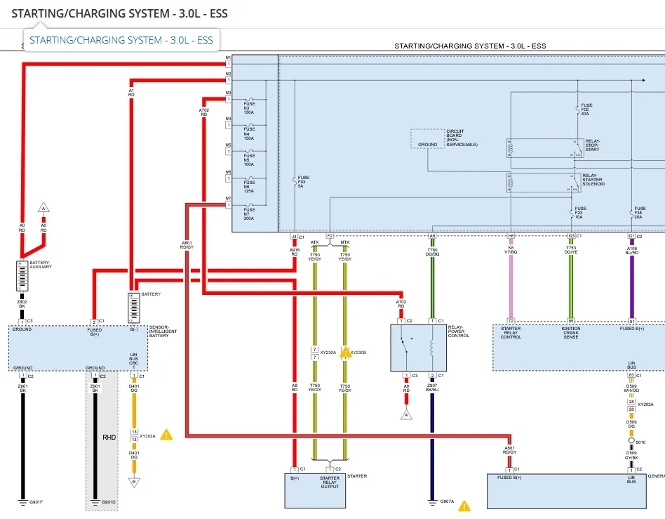

My kiddo (who works at local dealer) says that he sees the pin issue quite often when customers try to do the aux battery themselves. Tho I hear him talking about bent pins ALL the time and all over the Jeep lineup in general.
I started having battery issues again last week and again dead aux battery. Its around 2 yrs old.
Today we removed the aux battery and routed the aux battery cables back to the main battery. Easiy job because its diesel and dont have to mess around this the fusebox. This will keep the existing PCR system wiring the same. We have chatted with techs around the shop and everybody agrees this should be fine.

if im reading this right, the aux delete can be done two ways?
1. connect aux positive to main and tape (or remove) aux negative
2. The jumper option from N1 to N2 so no aux positive cable is needed on the main and tape (or remove) aux negative.
Removing the aux battery is completely up to the owner. It can be left in but its extra weight at the same time.

You don't need to use a jumper at all if doing the "delete". You can simply pull the aux negative from the IBS and pull F42.
That's it.
Only time to do cable moves is if removing the aux battery. Then you could simply tape up the leads down there. The moving of cables is not needed nor is the jumper
