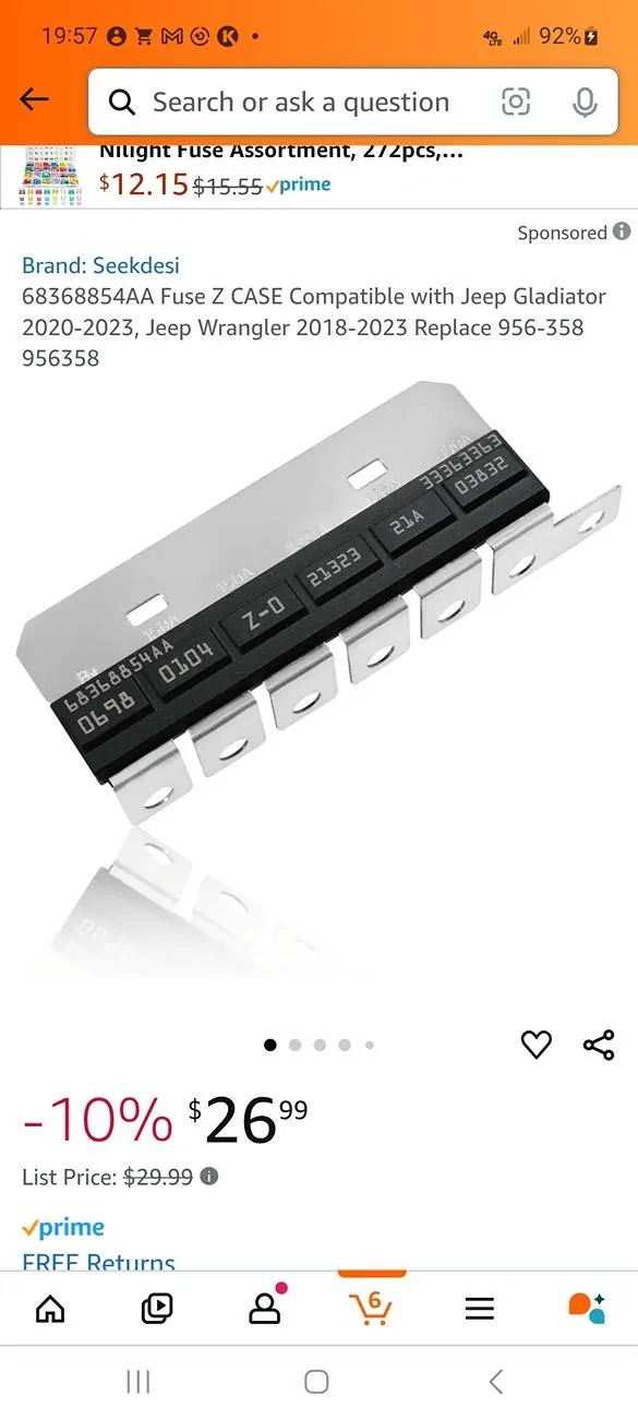

I am now up to speed on the "N" fuse array. I will purchase just in case. . Any recommendations for part? They seem to be pricey.
Amazon has it fairly cheap and fast shipping.
Jeep Gladiator Aux Battery Problems Screenshot_20241222_195744_Amazon Shopping
Been there recently myself. It fried the 150 amp. A lot of frustration with it. On top of vehicle shut on hwy loss of power steering, brakes trying to pull transmission release strap as disco of dashboard lights, wipers in traffic. If I would have seen a Jeep engineer who developed that s### I would have beat him to death on the spot. Likely would still want to beat his ### today. Oh the warning was on way to buy replacement batteries. The "news flash" of bad battery was it stopped running at stop sign and a ESS even shut off and no restart.
Not trying to cost a sales for our resident Mopar contact here.

Thanks for the information. Unfortunately I have already ordered a couple from Mopar Wholesale parts. On this one I wanted OEM parts from MOPAR. I do thank you.

I ordered it since a week later a friend of mine had his fried when his battery failed parked in driveway. A 2020 Overland. Since both of us are Ret. best to keep on budget for expenses. At least myself, he's not overly concerned as I am.
