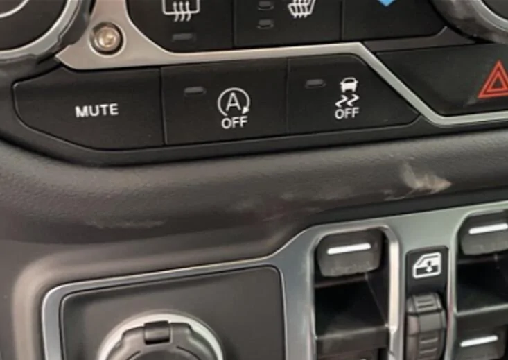

Which light? A warning in the cluster - or on the ESS disable button on the center of the dash?
Pulling the fuse won't negate a true ESS error.
I'm curious, without reading every post yet - which of the two ground cables that run to the top of the IBS on the main battery did you disconnect and isolate? They changed that cable in about 22 model year. The truck may still start and operate fine on the aux battery alone if you removed the wrong ground cable of the two at the top of the IBS.
Is the light here? Or a similar shaped error light on the dash/cluster?
Thank you. The warning symbol in the instrument cluster along with the service system message. The entire connection on both the battery terminal post when reinstalling the new batteries.
