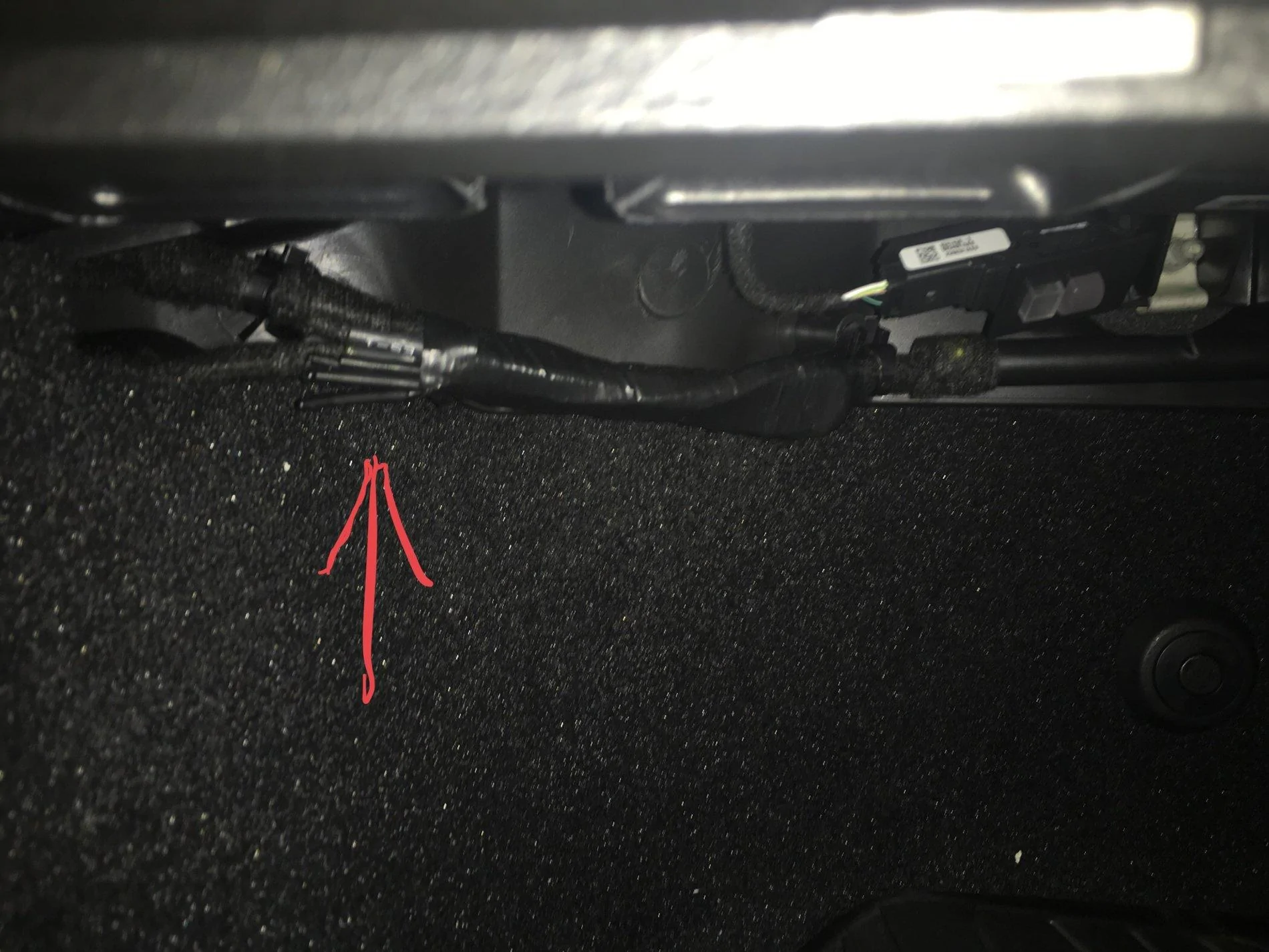

Anybody know if the wiring for the switches is in place on models without the switch group?

I'm pretty sure it is not.
If you have a Gladiator without the switch group, you can verify the wiring by removing the paneling on the passenger side and look under there. It is pretty easily accessible.
My guess would be there is no wiring - it just feels like a lot of work on their part.

There is no panel needing removal... the cabin aux switch wiring ends are peeking out just above the carpet edge of the passenger foot well.
Stop by a dealer and take a look at a known non switch equipped model to verify.

I’m really not all that hopeful its there. Wishful thinking I guess.
Turns out I should be able to check today.
It was not on the JL. Others in the JL forum said it was a monster job to add the aux switch panel and wiring.

It’s not on JT either, just confirmed. My thought process was maybe it was part of the wiring harness and could be a cost saver to just have 1 harness across all trims.
