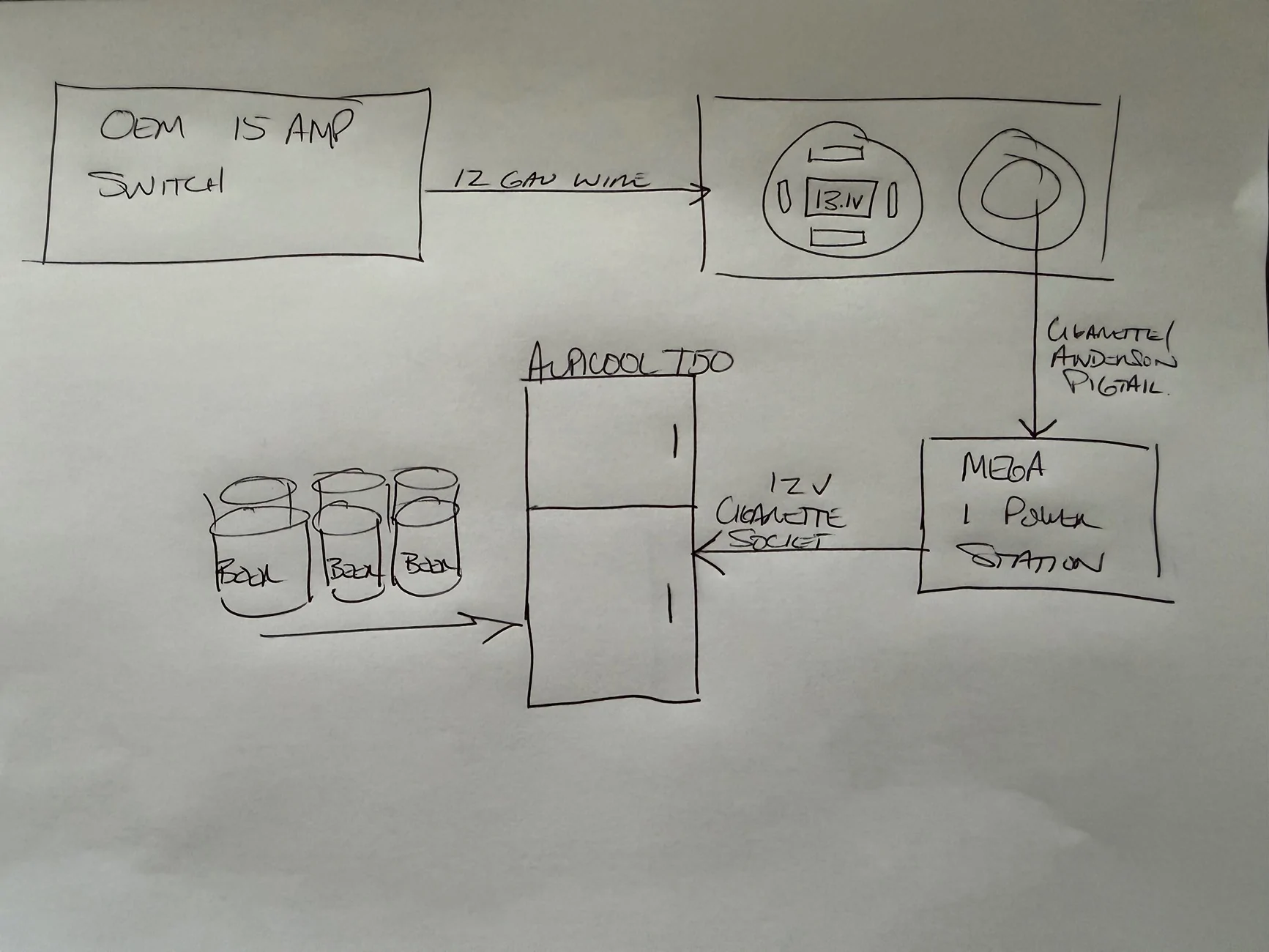

Great art work!!!
ItsmeMrWright
Steven
Apr 17, 2025
91
85
So Cal
2025 Jeep Gladiator Nighthawk
Electrical Estimator
You're too kind.
And a shitty liar. :P
Seriously, I was a 30 year career sparky, never much dabbled in DC, my only advice would be to use one size heavier conductors to minimize voltage drop. And don't drink crappy beer.......:)

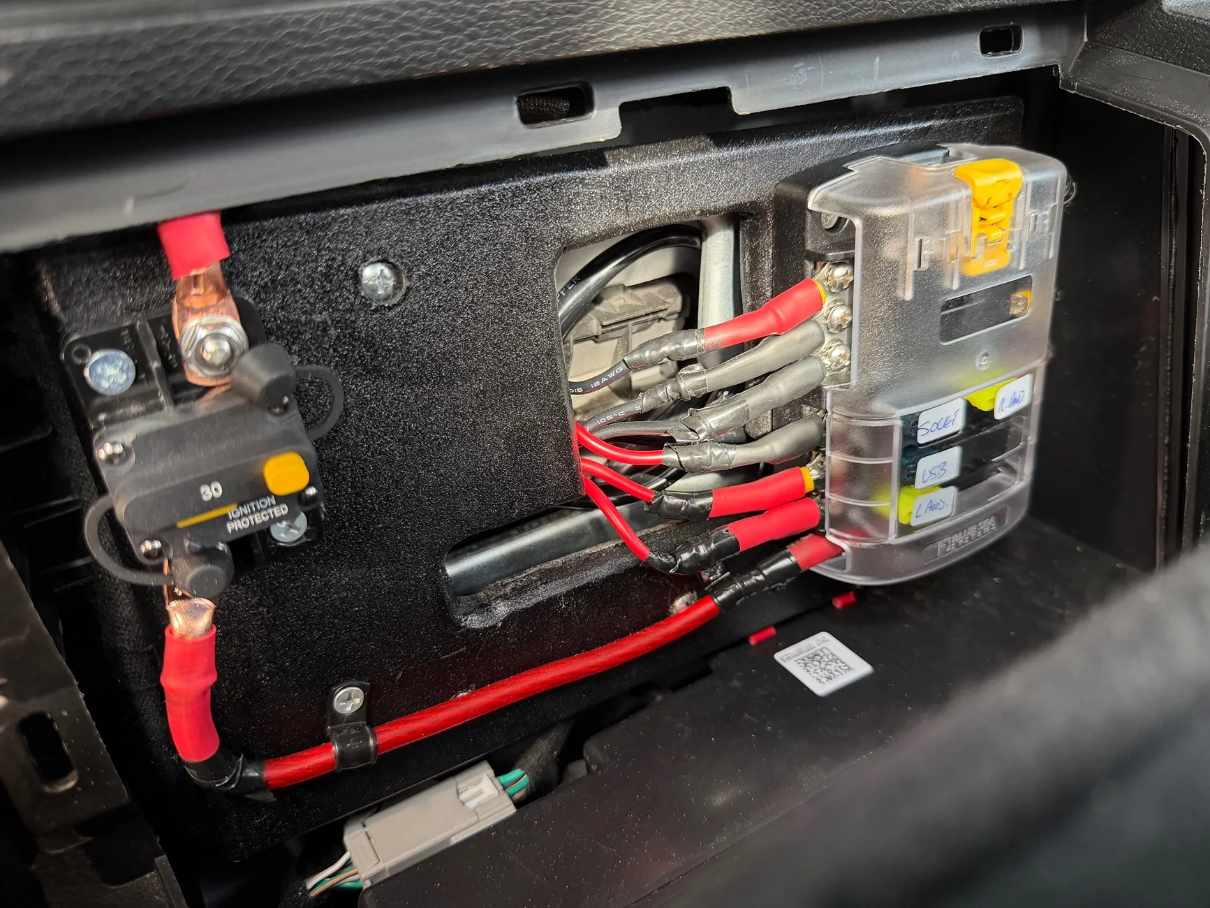

@ItsmeMrWright LOL! Much appreciated on the diagram. I have some 12v experience from years back designing, selling and installing car audio and lighting but it aint saying much.
As I'm playing out various scenarios, i am thinking about changing this to the 40a switched fuse.
Ive run my idea through a couple chatbots and that keeps suggesting using Powerpole 45's would be the better way to ensure nothing works its way loose and remains safe. I'm okay with that.
In this scenario I'd use a Blue Sea 5025 as a sub panel. Chat bots keep saying to use a 30a inline breaker before it hits the panel. If i'm not mistaken, that should theoretically trip BEFORE the OEM switch 40a in the fuse panel and be a quick reset rather than getting under the hood and trying to find a replacement.
Anyway, 8ga from battery to breaker, breaker to panel. From the panel to a plate with 12ga, the following fuses/sockets:
1. 20a, PP45/PP45 -- Mega 1 DC input
2. 15a, PP45/proprietary plug -- Fridge input (PP45 and proprietary plug wires are available on Amazon)
3. 15a, Cigarette Socket
4. 10a, USB charging plug (dual C)
5. Spare
6. Spare
The Mega 1 and Fridge would never be on the same circuit except for in pass through mode.
When I'm just running to Costco and not using the Mega 1, the fridge can plug direct into the PP45 on the panel (or the cigarette plug)
The most i could call down at any given time reasonably would be 30a between the Mega and the USB-C charger but the reality is the USB is only when the Mega ISN'T onboard. Plus having a 20a on a PP45 may come in handy for a portable compressor down the road.

That seems pretty well thought out. I would carry certain fuses and use shrink wrap tubing on all crimped connectors. I would even go so far as maybe adding a solder joint to them.
Thanks and agree. I'm trying to build as much redundancy into the setup as i can. I don't care if my battery dies but if my beer gets warm?

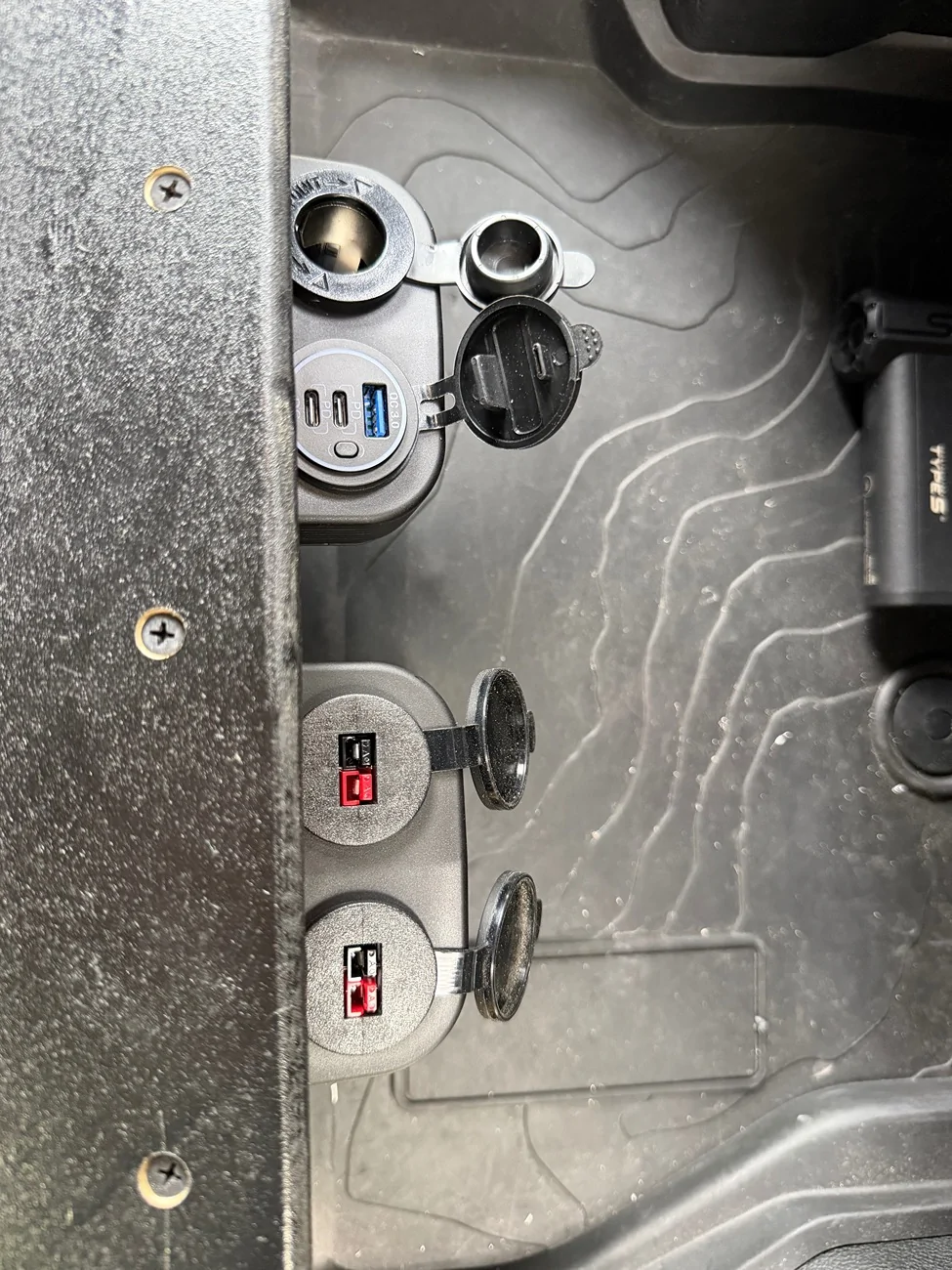

Update:
It works!
I installed it and tried with just the fridge around town initially. I just got back from a road trip from MD > VT/NY and ran the full battery backup setup with almost zero issues. (one of my Powerpole connectors may have worked its way loose, I'll tear into it later this week. Fortunately I have a second PP45 that worked fine)
I connected the power station to the PP45, then the fridge via the cig socket plug to the power station. I wanted to stress test the concept and aside from the above, no issues.
I tied into the 40a line under the glove box and grounded it to the factory posts nearby. I used an 8 gauge amplifier kit and wrapped all wires with TESA tape. They were fished along the sill and back up behind the passenger seat to the cubby behind it. I removed the cubby and made a quick panel to mount the breaker and sub panel. There are 2 20a and 2 15a circuits. The 20a both go to PP45's and the 15's feed a USB and socket respectively.

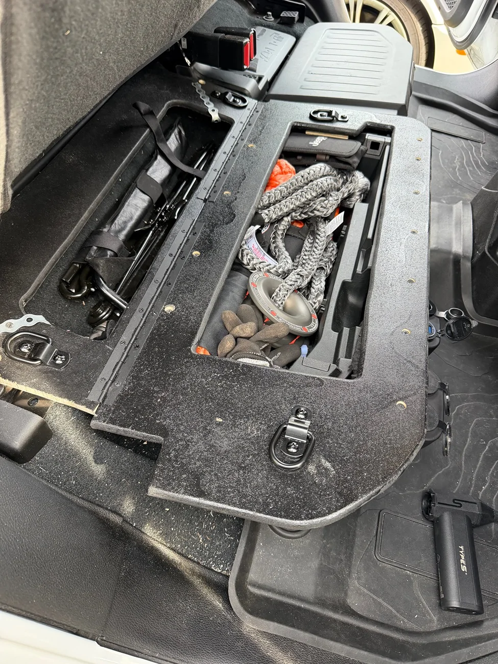

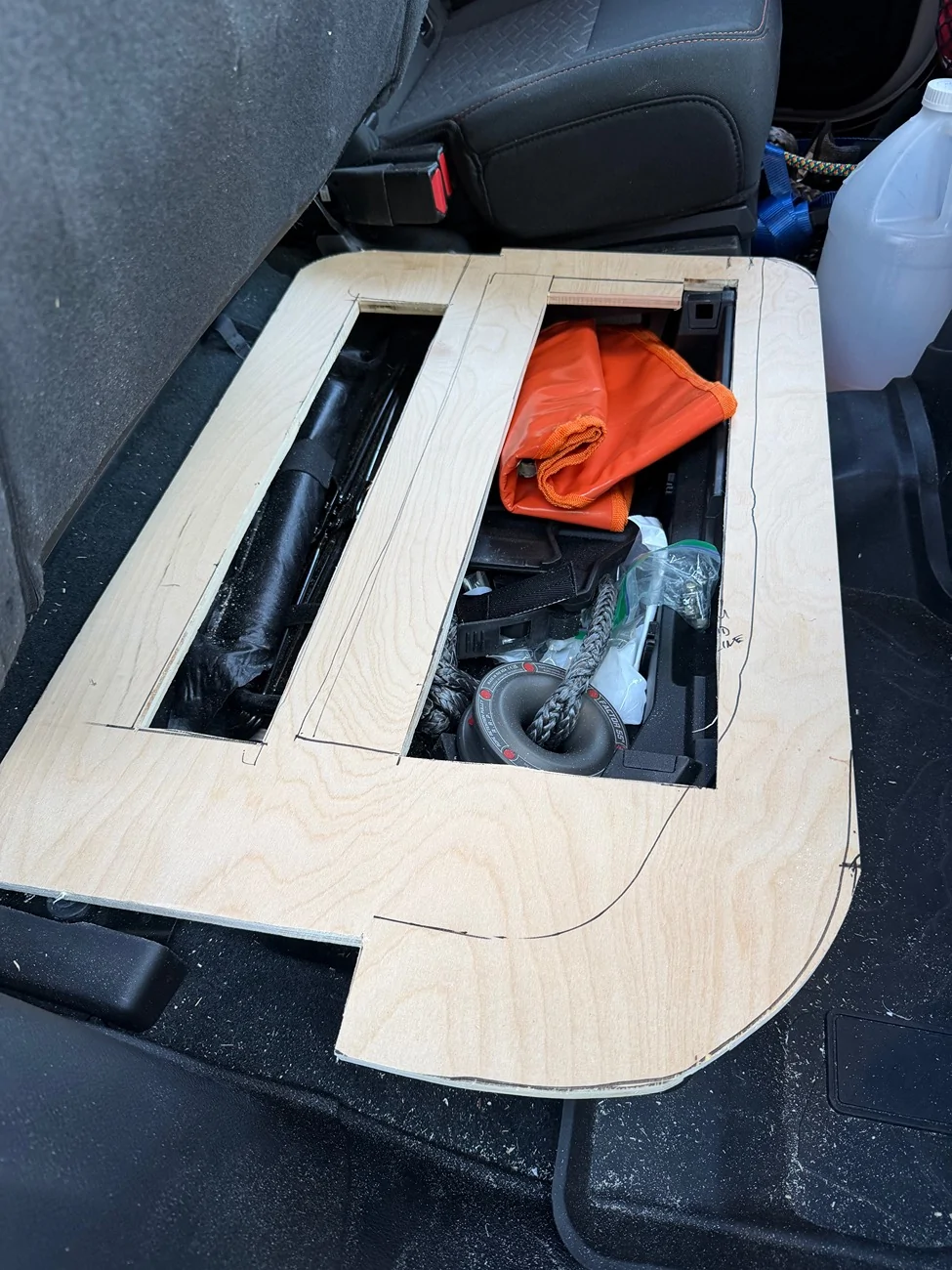

I used cardboard to make a rough template. The base is 1/2" birch ply. I did a lot of test fitting and scribing to get it "right."
Jeep Gladiator Aux Switch + Power Station + Fridge = Cold Beer? IMG_1180
I found that the 60% seat wasn't sitting down and level with the 40% side. @Toytech01 said he used a grinder to get the fit right. I chose to grab a couple piano hinges from Home Depot to mimic the angle. It worked. I did 2 coats of bedliner and a couple flat black Rustoleum. This way the base would have a little grip for the fridge. I installed rings to mount it but to be fair for a road trip its not necessary. The front seat wedges in pretty tight and the unit really only would move (I think) in a rollover.
I considered installing doors over the gear cubbies but that really isn't necessary.
The biggest issue I ran into was the final platform wouldn't line up with both seat mounting bolts. I really didn't want to redo the whole thing. The decision was made to mount the back to the factory bolts using metal strapping. It doesn't move and gave me a little more flexibility on placement to get the seat bottom level with the other side.

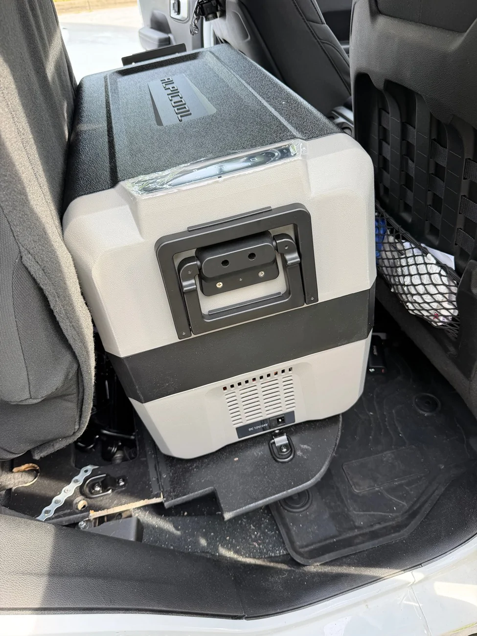

Installed, the fridge fits perfectly.
Jeep Gladiator Aux Switch + Power Station + Fridge = Cold Beer? IMG_1212
Ultimately the system worked as I intended (minus whatever was wrong with the one PP45 plug).
The battery pack sits behind the driver's seat and has plenty of room for ventilation.
The pack and fridge have apps for monitoring and control. I was able to eyeball them on the road off my phone and make sure everything was working fine.
I found the fridge on full send mode (no eco) dropped the battery level from 85% to 50% overnight. I didn't realize it wasn't actively charging until a few hours on the road and it had dropped to 18%.
Had I been in Eco Mode like when camping the levels probably wouldn't have been so low.
Once I plugged the station into the other PP45 at 18% it charged back up to about 30% over 2.5 hours.
Overall the whole thing worked as I hoped and will get tested out on a real camping trip next week.

There are a couple points I meant to make in the other posts:
The Alpicool fridge: https://a.co/d/0bUCaYvZ
It's a 50L and fits through the door but barely. If the door was off or the strap and retaining bar were removed it wouldn't be more than a thought. I bought it on AZN on sale for $230 over Memorial Day weekend, the same fridge is now $100 more.
I should have bought the 65L version since the only dimensional change is that it's taller than the 50L. Weight might have become a problem though.
The Mega 1 battery operates around 89-95 degrees on pass through and standalone and up to 101 on 12v when charging. Operating temp range maxes at 104 and storage temp 140. To be safe when I was away from the truck I kept the windows vented to allow a little air flow.
The fridge doesn't have the most accurate thermostat. I tested it with a remote probe prior to the trip and found I needed to set the temp around 3 degrees lower than my target to get where I wanted it. It does freeze remarkably well.
I am ordering the insulated cover for it ahead of the next trip. Hopefully that should cut down on my power consumption while off grid.
