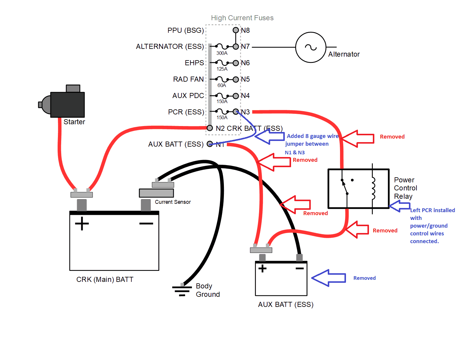

getting ready to do the mod, was going to follow this post and pull fuse 42 as well. Hopefully i can remove all the dead cables to and reduce the mess of wires there.
https://www.jeepgladiatorforum.com/...-admin-warning-no-politics.23705/post-1132146
I recall a post a few years back where someone did the same thing and had pictures
my big confusion is some folks talk about jumping n1 and n2 and the diagram in the link you are bridging n1 and n3.. SO what is right?
you do not need to jump N1 N3 with this approach, hence why it is called the jumperless aux battery bypass.

There are two positive cables from your auxiliary battery you cannot just remove these and do nothing else. An easy work around if you want the auxiliary battery gone would be to hook these two positive cables together or do the jumper between N1 and N3. The easy route is just disconnecting the negative cable and pull fuse 42 and leave the auxiliary battery in place.

Surgery was successful, it feels great to get all those extra wires removed and back to a traditionally 1 pos/1 neg setup.
I did the N1-N3 bridge aux delete mod and used a razor to carefully cut the electrical tape and wrapping to separate all the wires for the AUX battery. Chased the wires down to the fender where the PMC lives and disconnected them from the PCM terminals. ALL GONE!
I pulled the #42 fuse as a cherry on top to make sure the PCM is offline. I am also running a auto stop eliminator add in to remember my off setting.
Needed to replace my main battery as it was starting to go, and gave me a good opportunity for some house keeping.
As a bonus, I successfully cloned my ecoD ECU and installed the clone ECU for testing since I was into that area. And everything started up with not errors!
Here is the diagram I used posted by @Hootbro
Jeep Gladiator Auxiliary Battery Delete Poll 1724039554234-z2

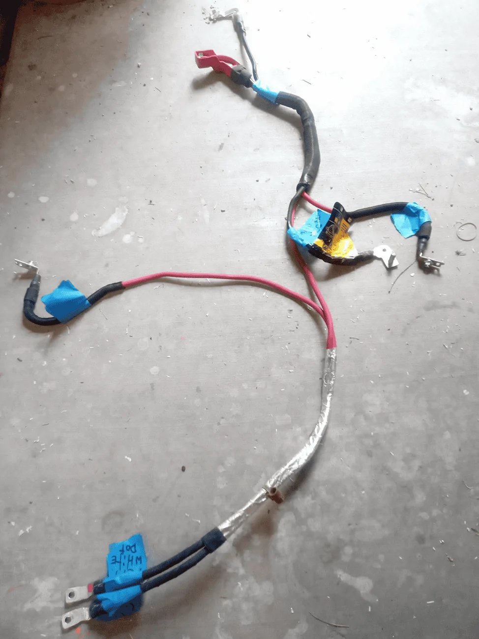

Here is a photo of the exercised spaghetti monster. Later Aux....
Jeep Gladiator Auxiliary Battery Delete Poll 1724265574017-as

Yeah it personally bugs me to just leave it there. Is there a recommended wire gauge for the jumper between N1 and N3?

8gauge, i had some winch cable left so i used that or if feeling creative you can use either the N1 or N3 lead cut one end off and put a lug on it to bridge N3.

The other option would be to bolt the two auxiliary battery positive cables together down at the auxiliary battery. I could save a whopping 11 pounds 😂
The 2 pos cables at the aux battery are already bonded, look at the photo above where the red cover is, there are 2 cables crimpted to 1 lug.
You could disconnect the 2 lugs at the PCM and bond them, that would act like convoluted N1/N3 bridge.
