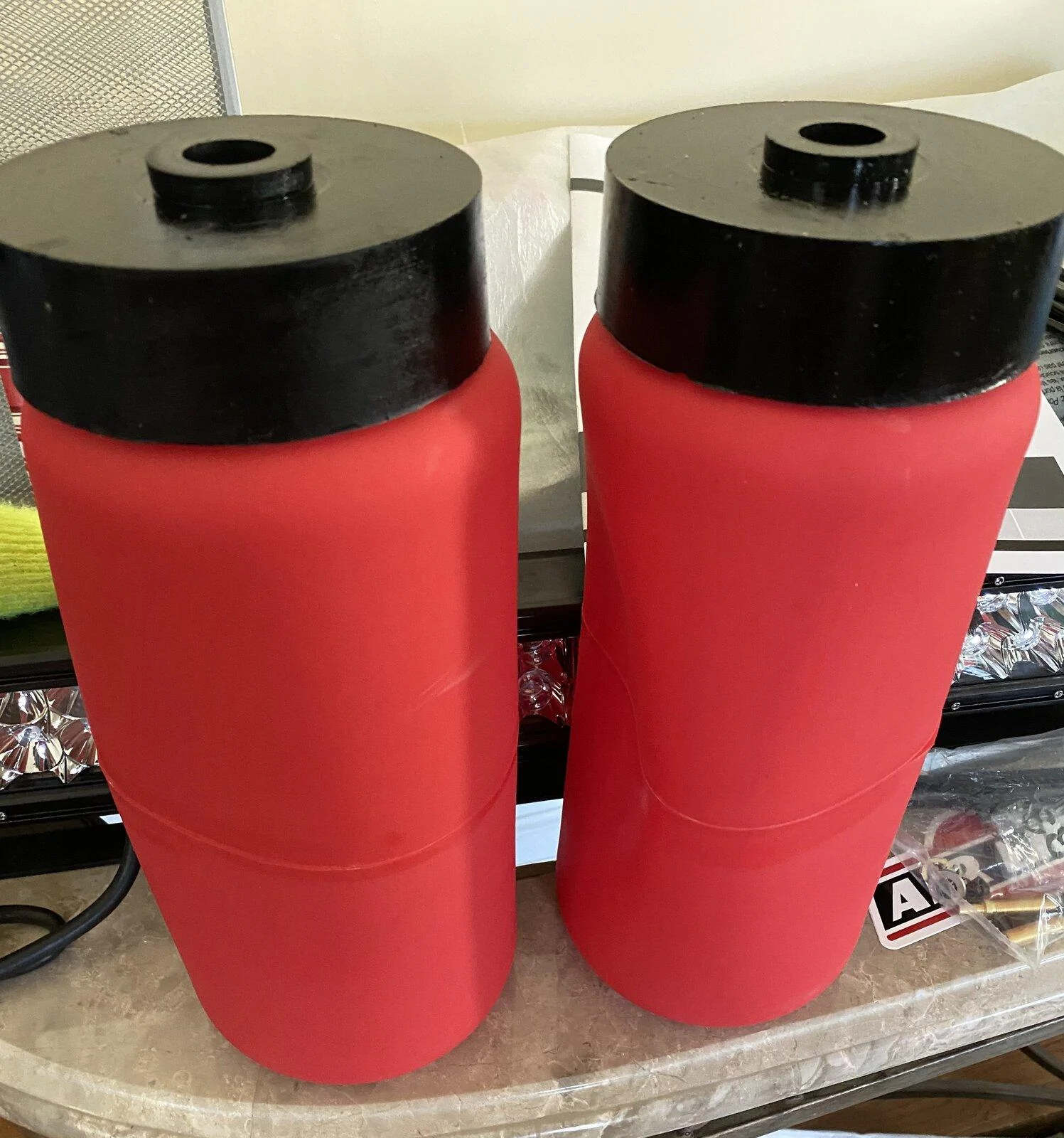

I had the EXACT issue when installing the same airbags - even the same conversation with Nick.
The bags did not fill the space at all when jacked up.
Thought for sure I would loose the lower plug.
He assured me they would be ok.
Been installed for more than a year and no issues at all - work like they are supposed to.
I never put more than 20psi as 10-15 is usually more than enough.
Hope that helps...

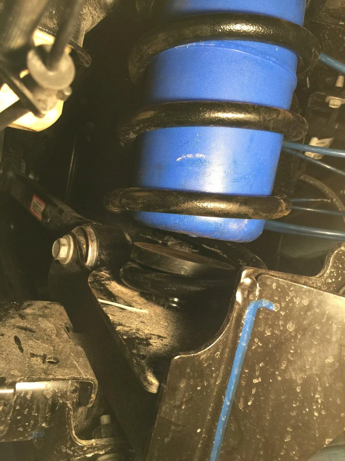

They are very easy to install once you know the trick. It took me a little bit to get it down on my Ram 1500 but once I did it took moments. Then I added some on my sons Ram1500 in just about 10 minutes.
You remove the cap on the air fitting, then press it down with your knee on a hard surface. Then fold up the sides and have some zip ties ready to cinch it down. Maybe in three locations. The top and bottom will fold to the outside, and it will finish looking like a red or black or blue hot dog bun. Replace the cap. Lifting the rear some from the hitch will let the springs stretch open more and you simply slip them in, air fitting up. Then snip the zip ties and remove the cap and they will go back to their normal shape. Then add the air lines and your done.

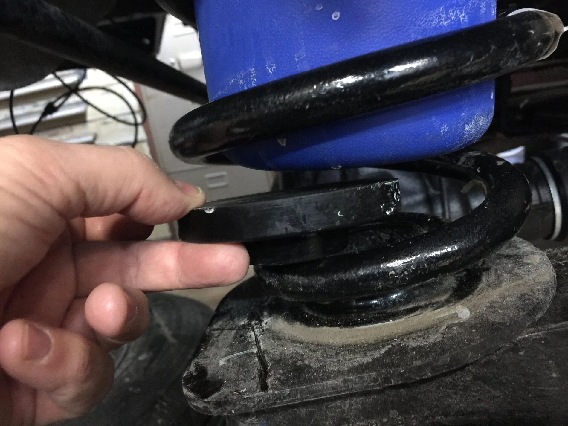

I installed a set of Firestone airbags purchased from truckspring.com.
One of the bags ruptured after about a week (around 15psi).
I contacted truckspring.com and they said not their problem and that I should contact Firestone, who refused to take a phone call...
So AVOID Firestone at all costs. There is in essence no warranty on these products.
I will get some pictures up of the bags that I had to use a reciprocating saw to cut out of the springs.
