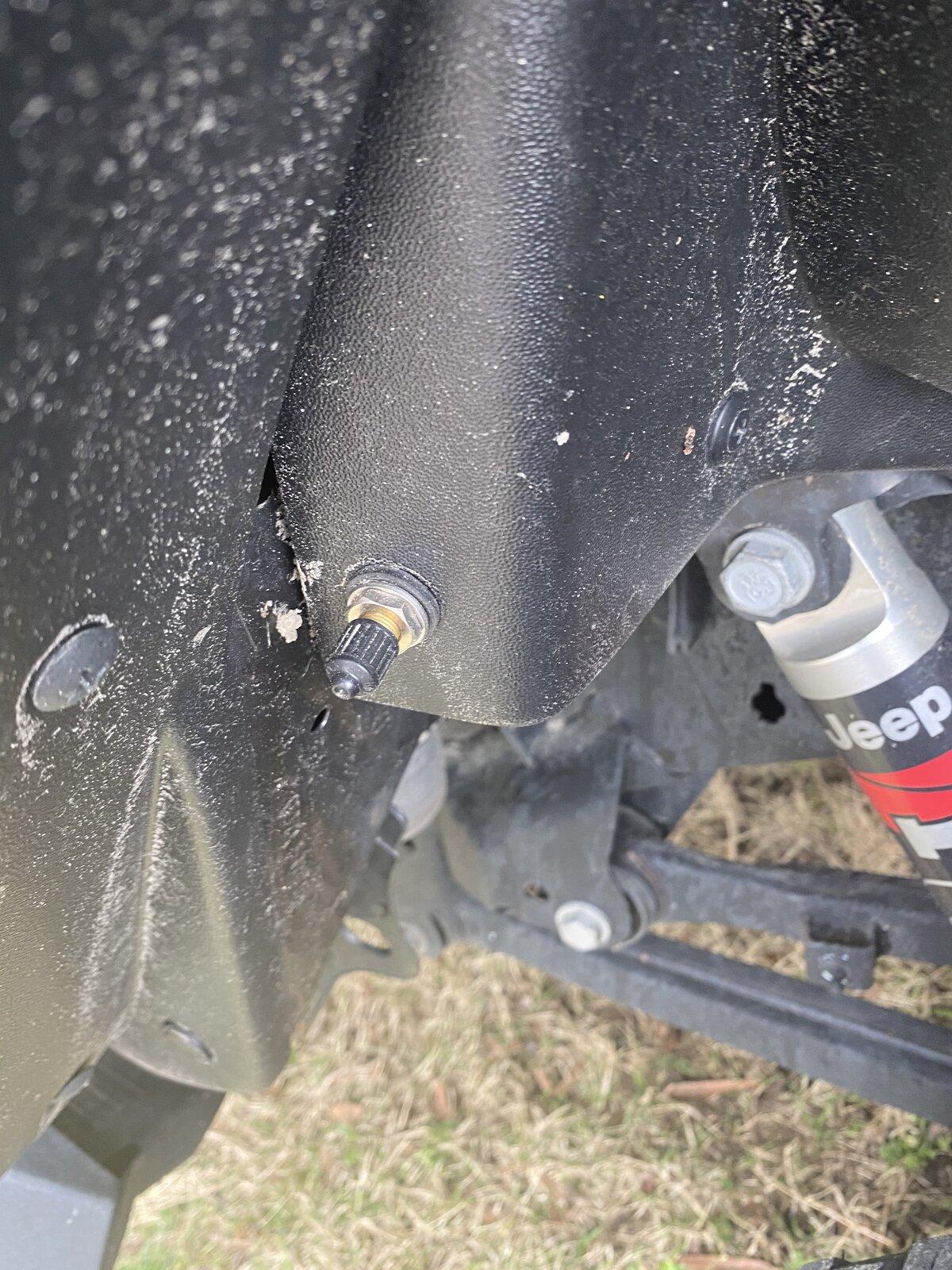

DO you have any photos of the air bags in place?
Do they fit snug top to bottom or just press against the springs horizontally?
I'm not looking fo lift - only to keep the sag to a min and stop the bouncing/softness.

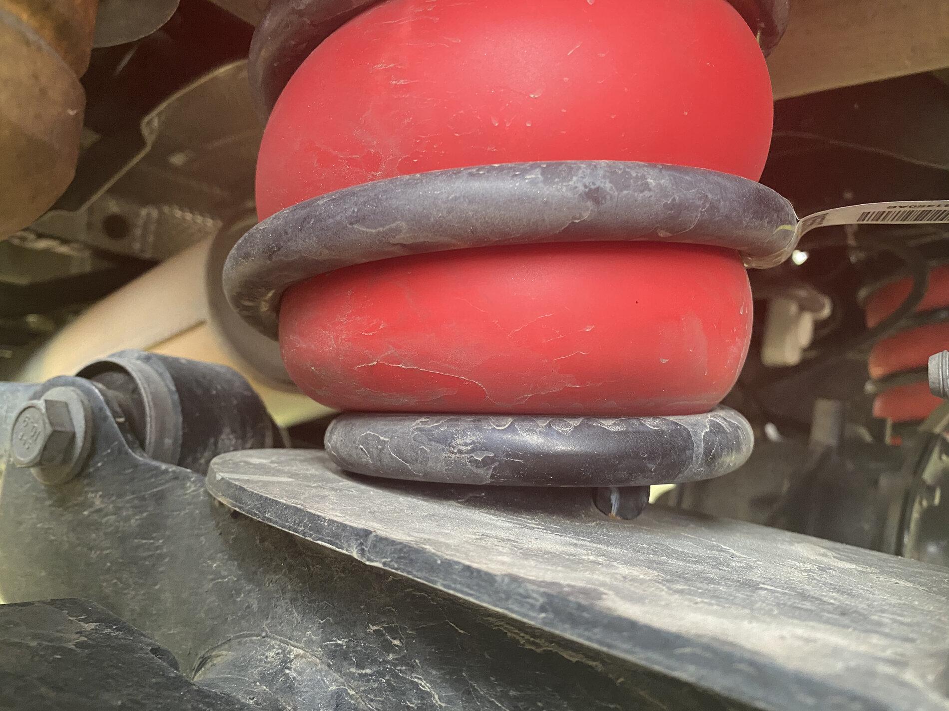

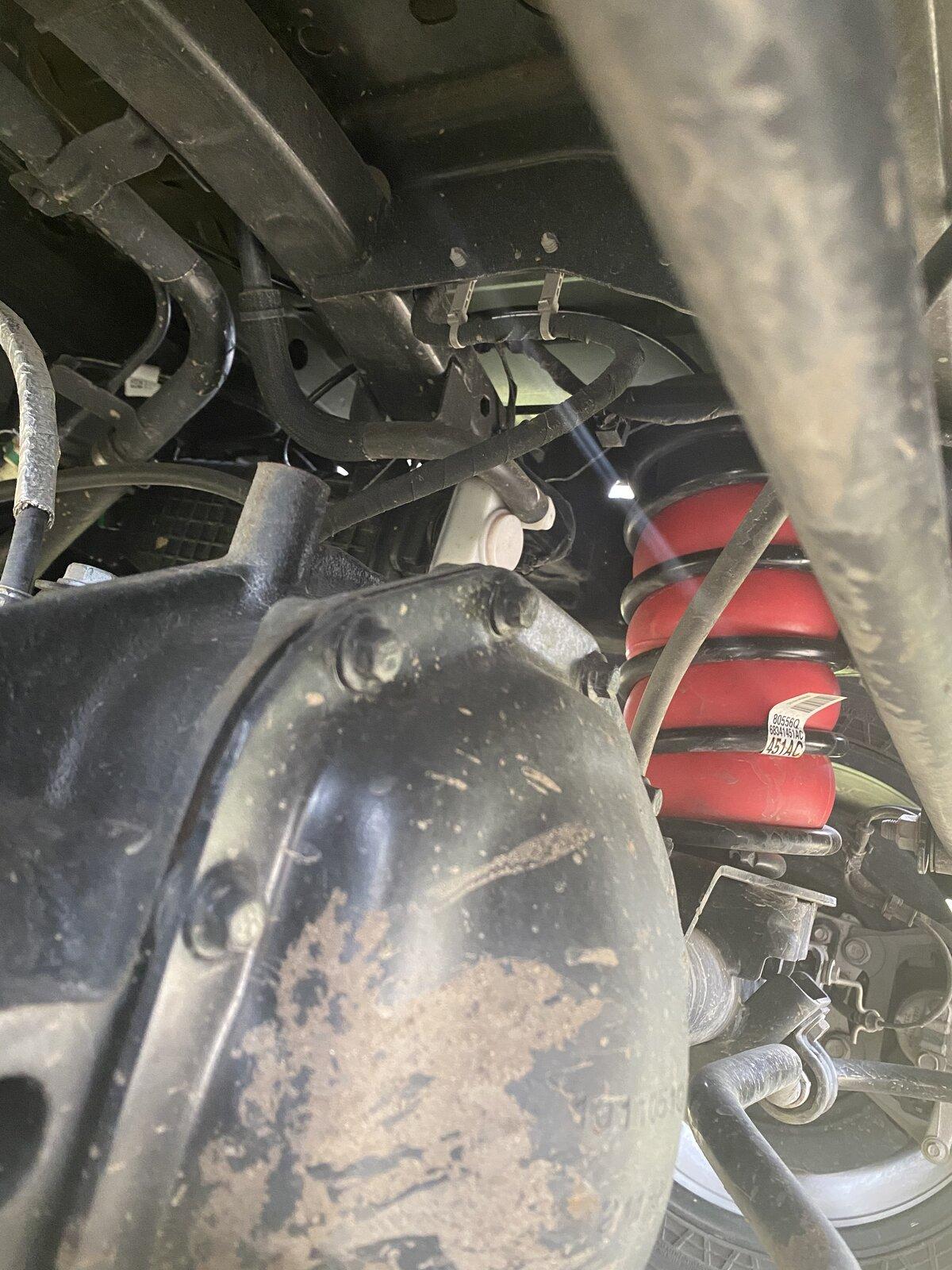

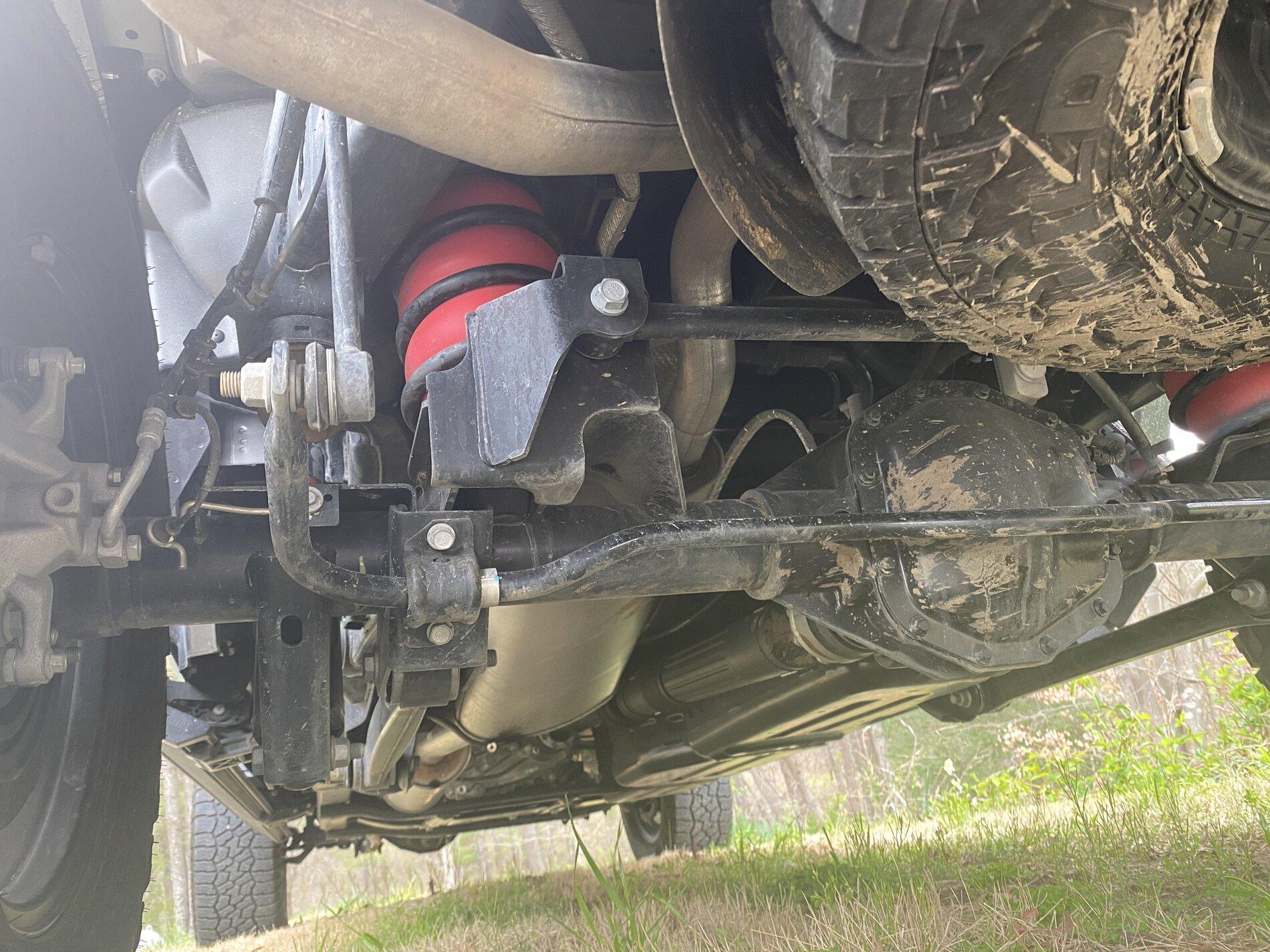

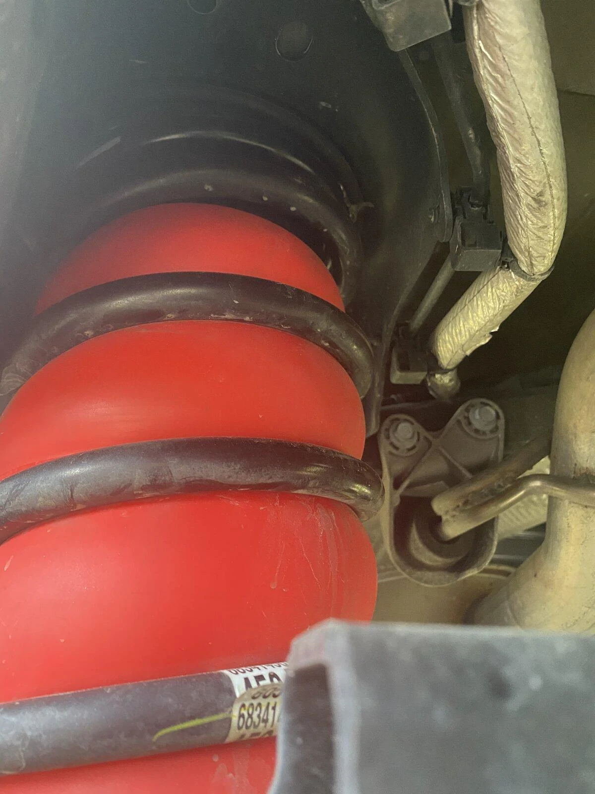

They are not quite all the way to the top. Definitely not snug.
I don’t see where it indicates any trim level at all so I’m thinking it would fit all stock springs. I have a rubicon launch edition.
Mostly pressing out horizontally. ( Old school spring supports did the same concept with rubber squares between the coils. )
Just took a couple pieces a gravel stuck to my arm climbing under for the pics. Hope they help and worth my agony crawling over gravel lol lol.

Wow. Looks really good.
Thanks for the pictures

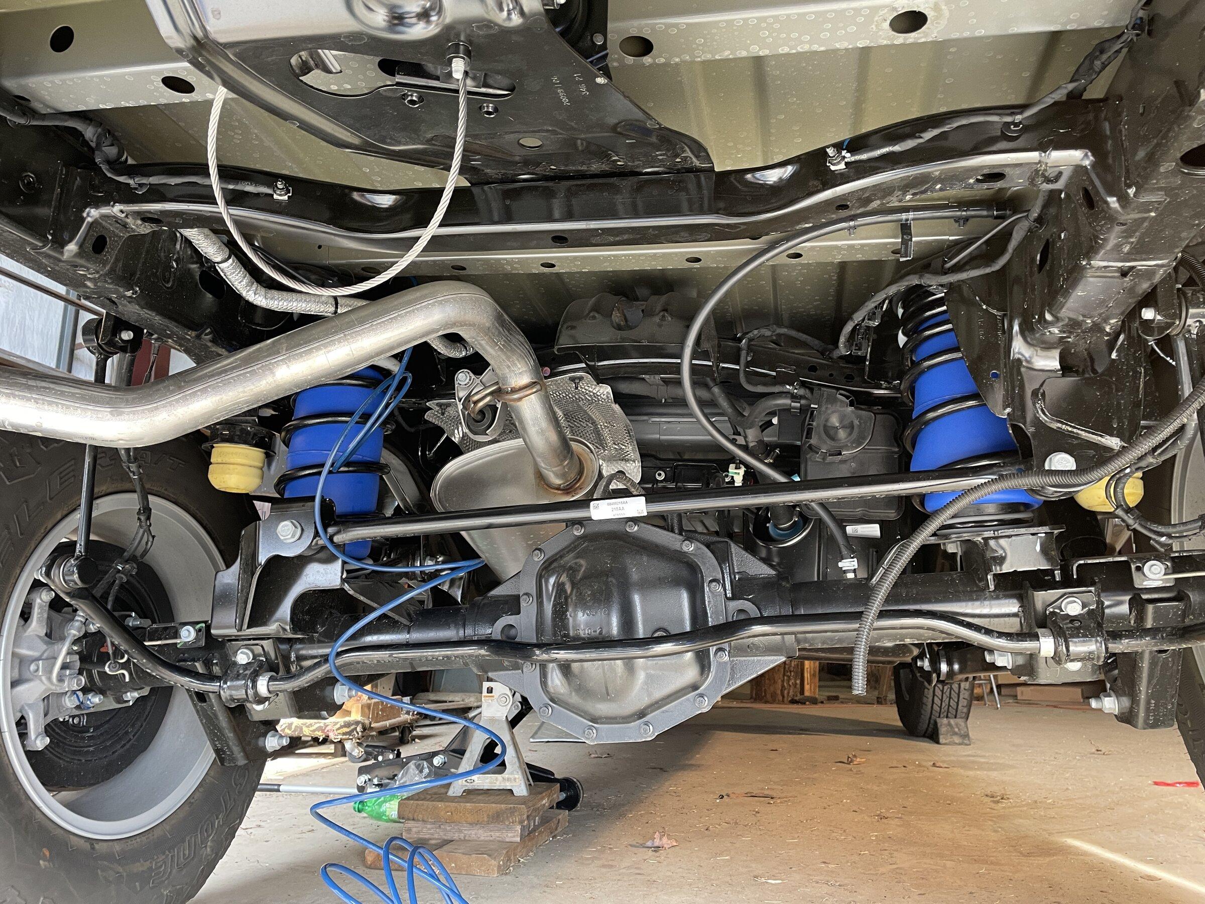

Just put in a set of firestones. They fit snug to the bottom, a bit of a gap at the top, but can't do anything up there anyway. I fit the lines to the bags before I fed them in, and pressure tested them. Then I just had to check and fix leaks at the push-to-fits.
@BaliMawr Which kit did you use? Are you lifted?
