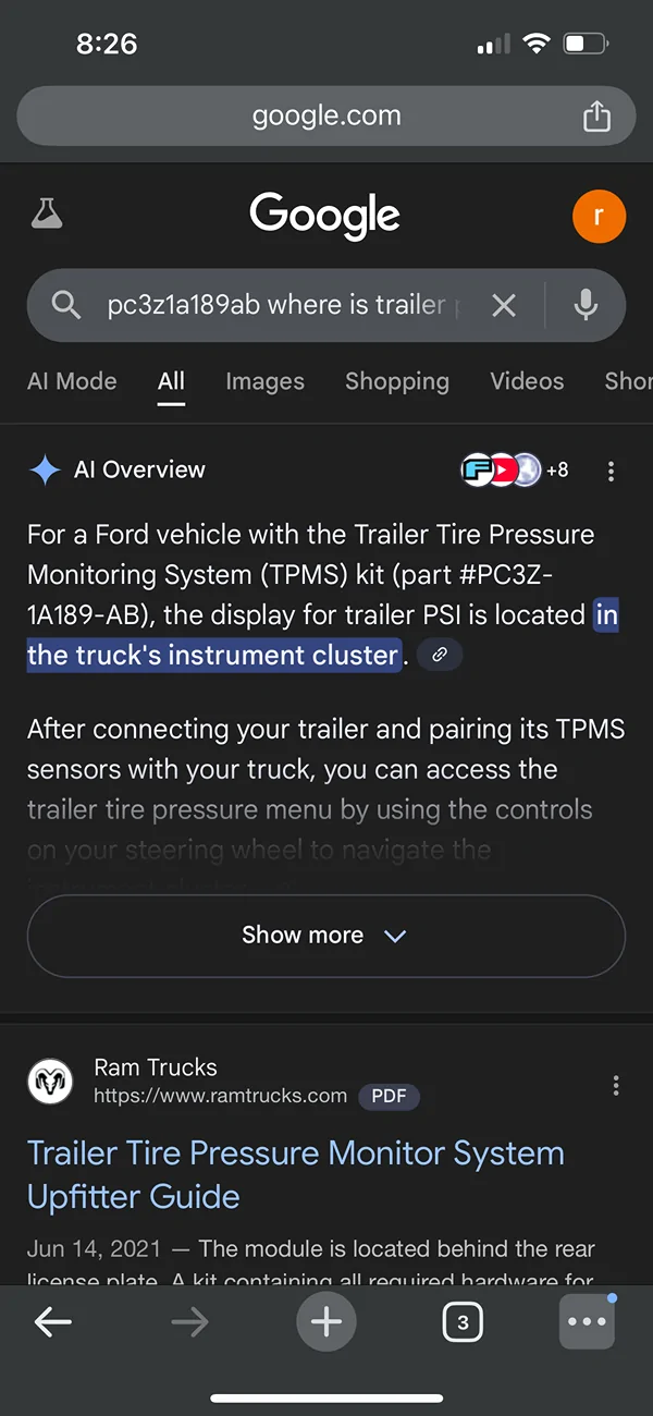

I’m not familiar with it, but it appears it’s displayed in the cluster.
Then they have the system, BCM, already set up to handle and display it.
So far, Jeep hasn't made such changes - (as of 2025, anyway)
Not surprised at all with Ford trucks - they are the leader in such things and have inserted technology beyond others for years.
