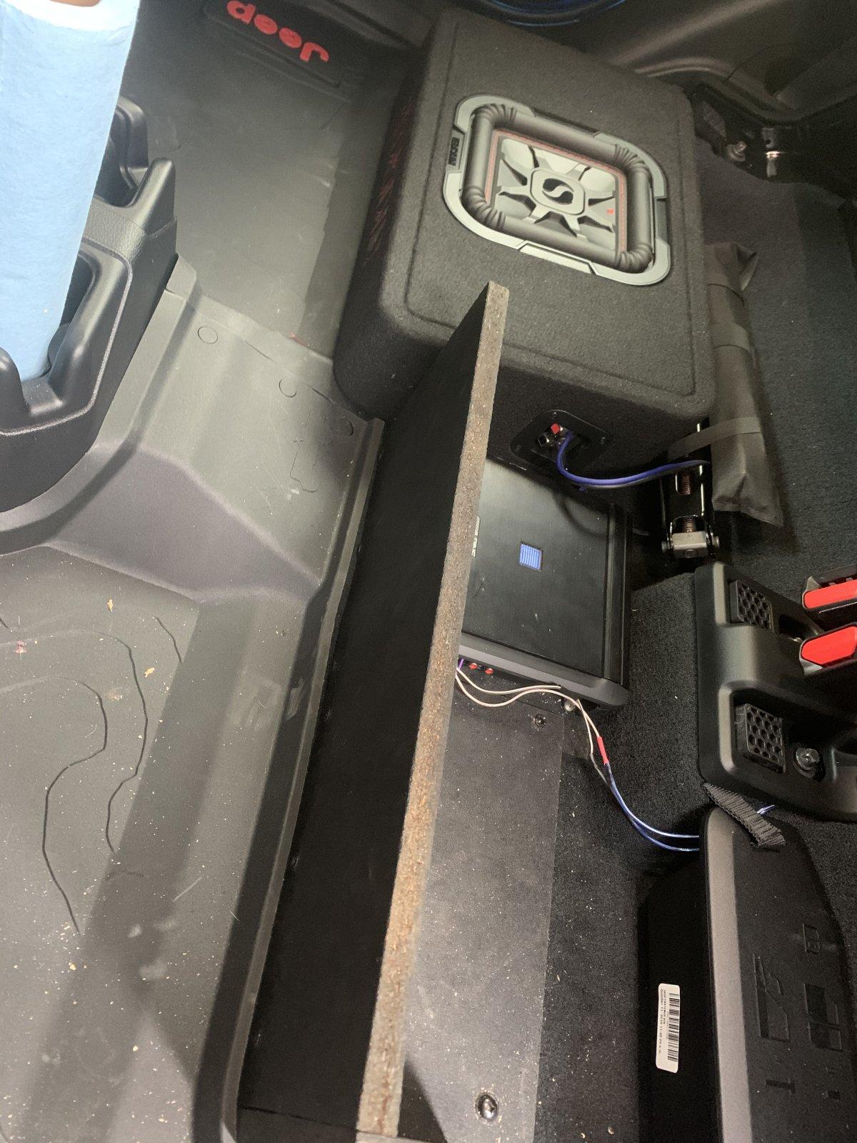

The alpine in the JT is the second best stock system I’ve had (first being in an Acura).
however, I found the bass lacking. I added an 8” kicker sub that fills in the gap nicely.
I don’t regret the alpine package, but if you’re the type to tinker with audio, you could probably build something comparable with deeper bass

To add the sub did you have to add an amp and some sort of controller for the sub or could the stock stereo handle the addition? Or did you swap the stock sub?
Puttyandnapalm
D
Aug 11, 2019
330
304
Cumberland, MD
2020 Hydro blue gladiator overland
Casino
My amp accepts speaker level input, so I tapped into the stock subwoofer. That was easy compared to running the power wire from the battery though....
