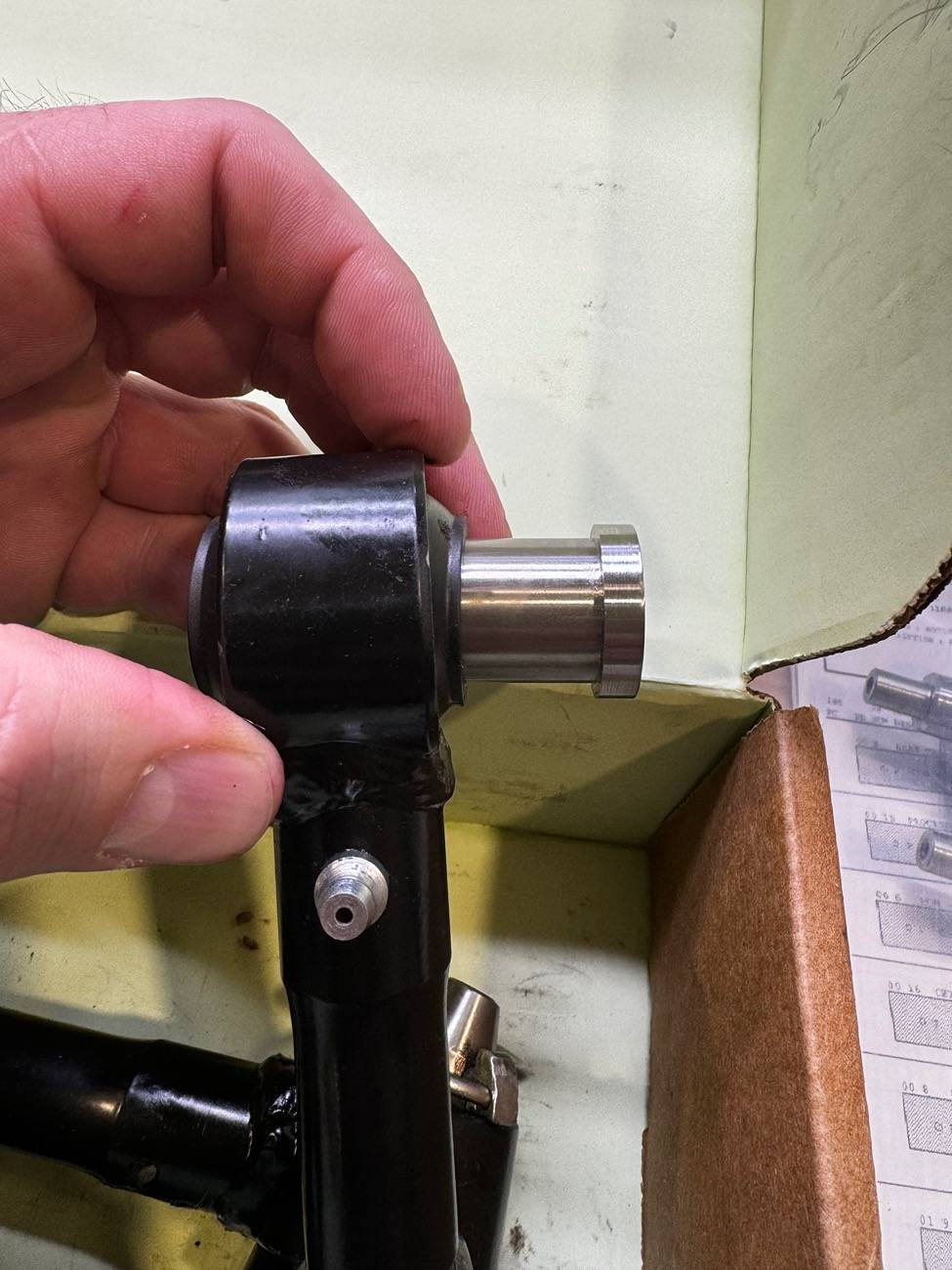

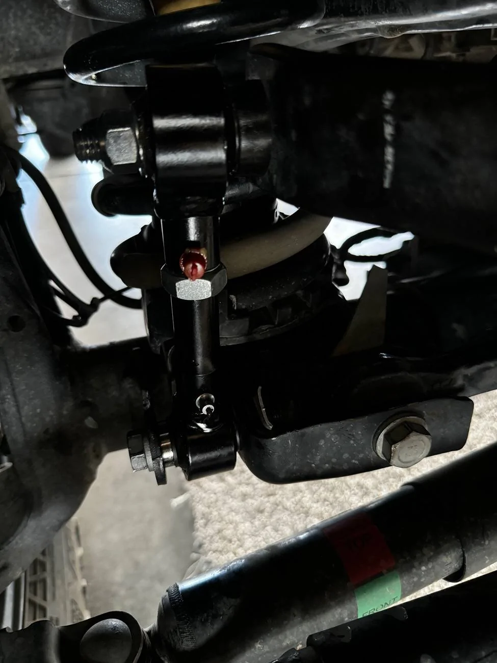

I have the JKS disconnects. I got them for $60 on Facebook marketplace. I would not have bought them otherwise. They require you to cut one of the passenger side brackets off your axle to work properly. I made a bushing so that I would not have to do that. and I have to unbolt the passenger side to disconnect. If you can afford it, buy the apex. looks a lot easier.
Or you can find a cheap Rubicon take off front sway bar and wire it in. There is also a device that you can buy to use the factory Rubicon sway bar manually.
Yeah i wasn't thrilled about cutting that mounting tab off either. But I did it anyway. I kept the tab in case i ever need to weld it back on for something like the Apex system. Nice job on the bushing.
Thanks.
