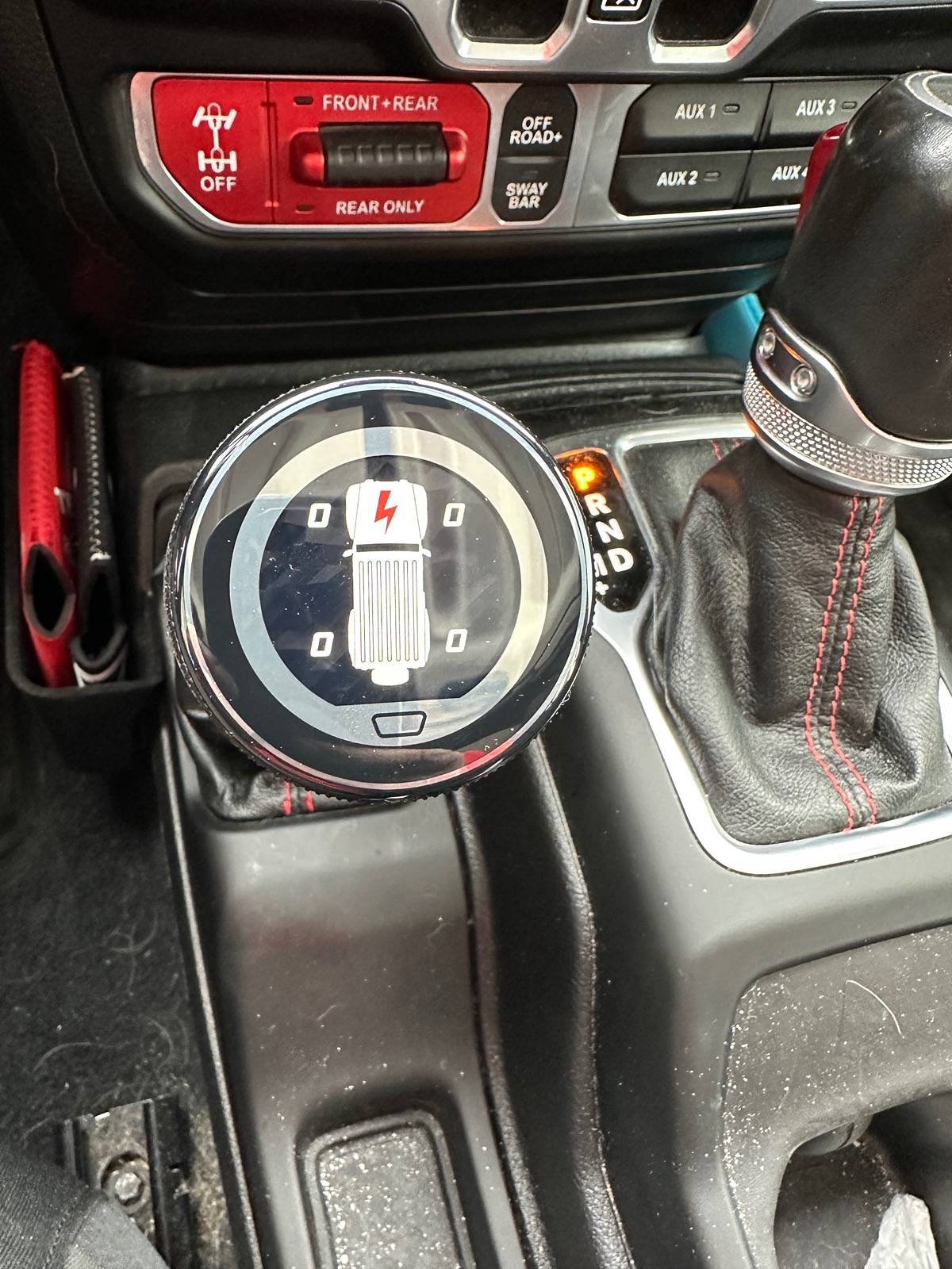

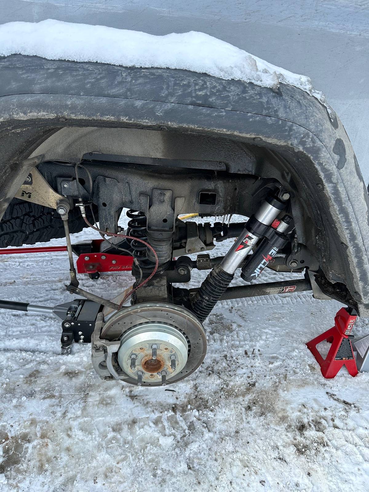

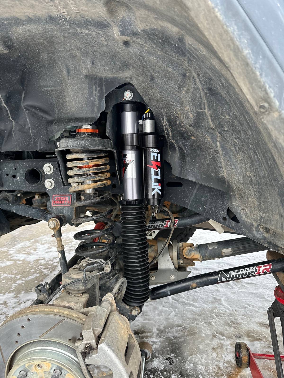

As someone that has Eclik shocks on my JT, mixing electronics with shocks is a game changer. It makes manual adjustable shocks so rudimentary in comparison. It genuinely improves the vehicle so dramatically, it’s difficult to believe without experiencing it. It has added true Mohave desert running capabilities to my rubicon. On the road, I can do u turns with my foot on the floor and take 60mph curves at 80 without body roll. For rock crawling, it’s more stable and capable than it ever was, as it automatically adjusts for off camber, climbs, descents, drop-offs, etc. I very much like Fred Williams, but he doesn’t exactly sell this as well as he could. I’ll be very interested to see these sway bar links in action. Thanks for posting this.

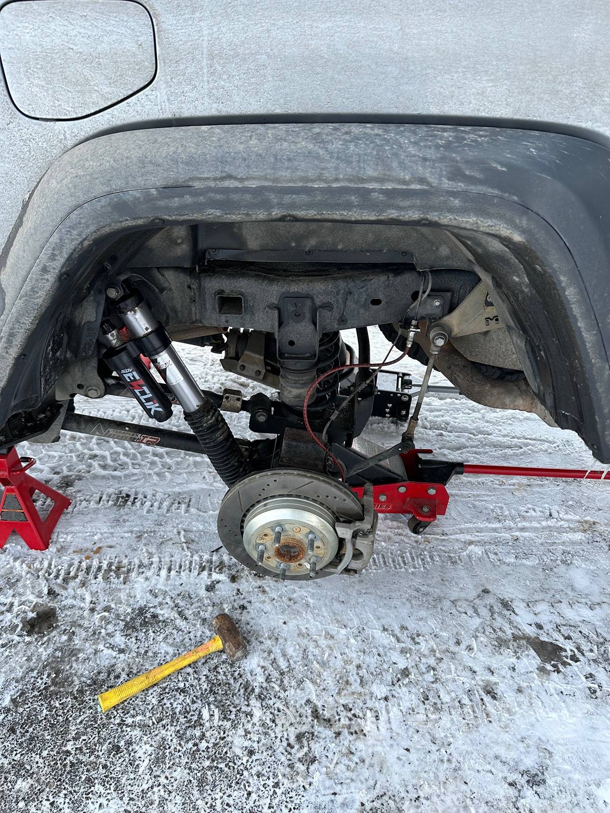

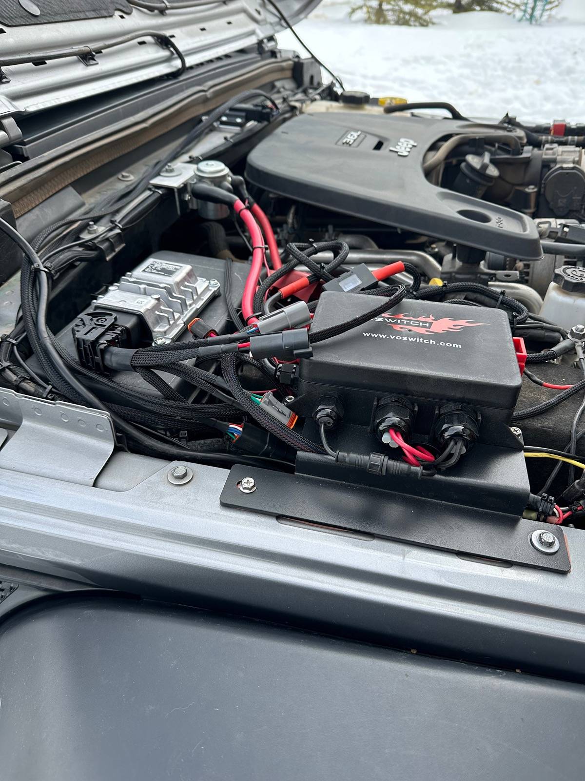

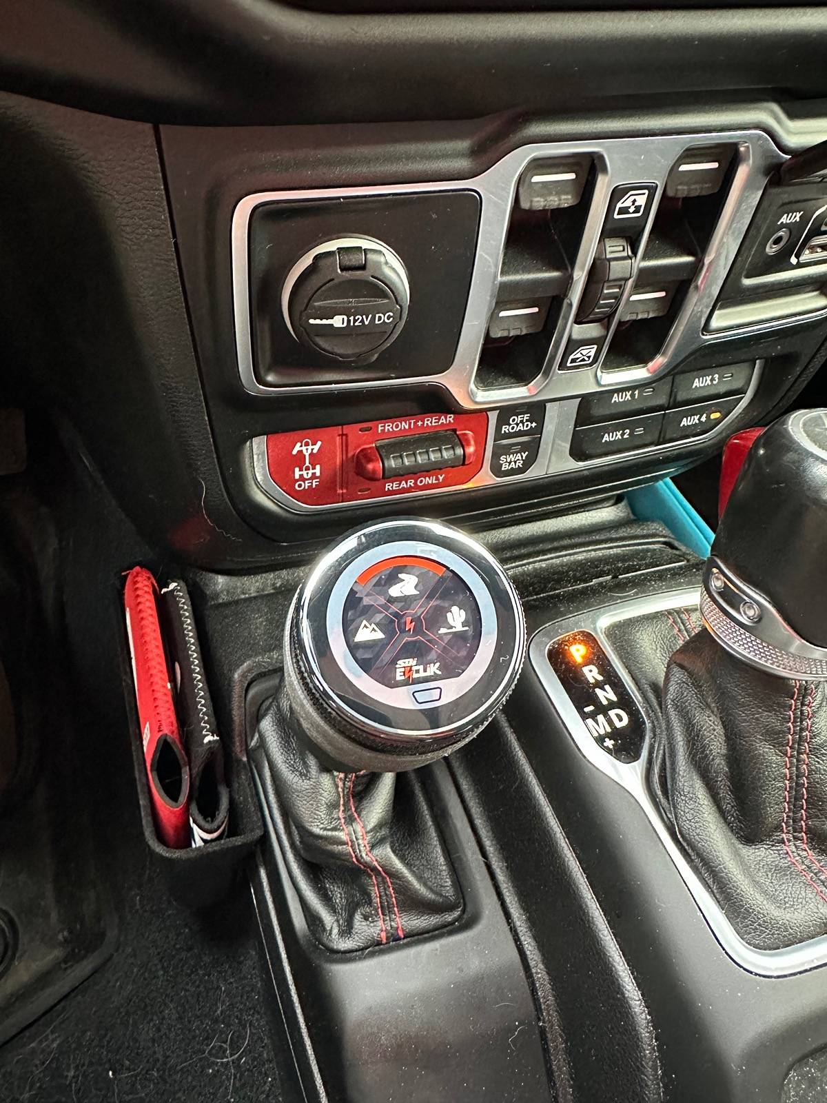

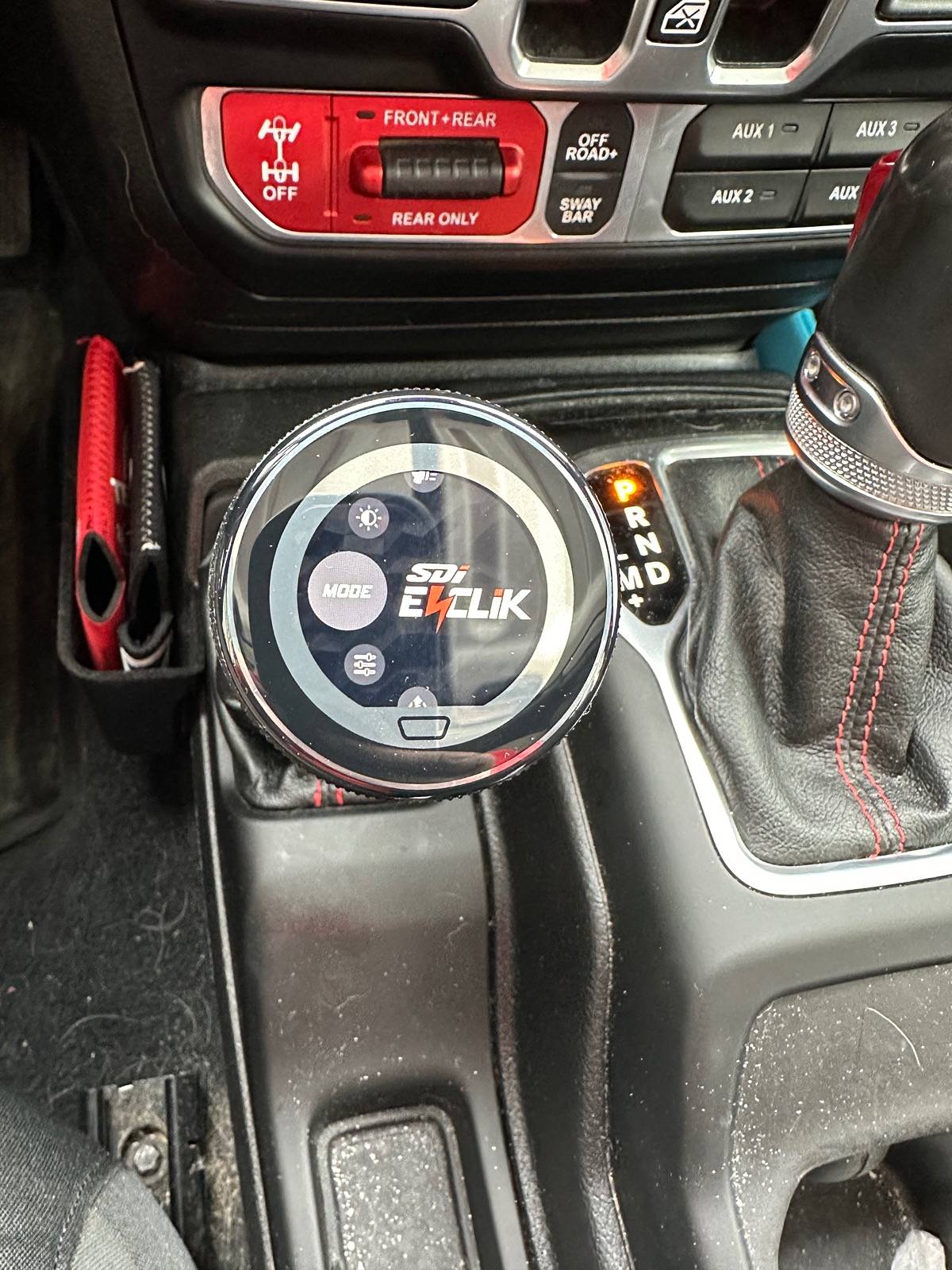

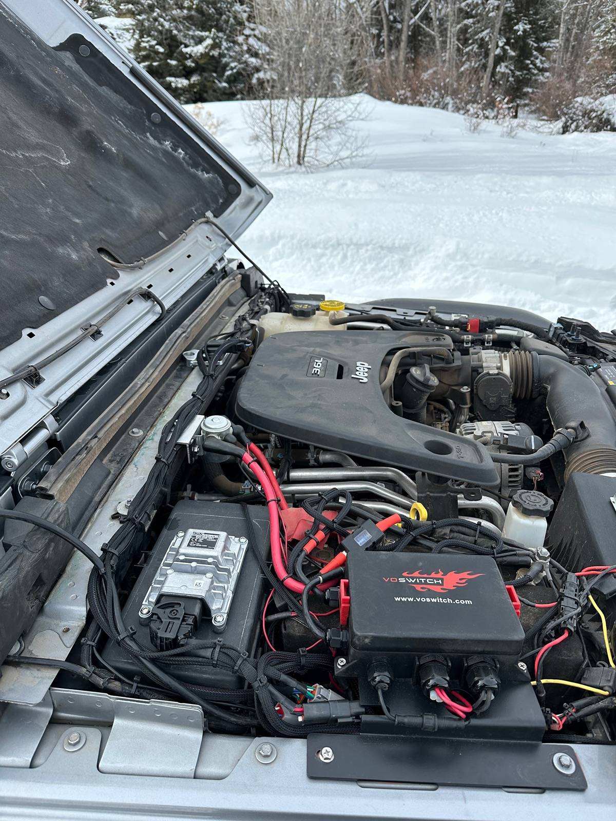

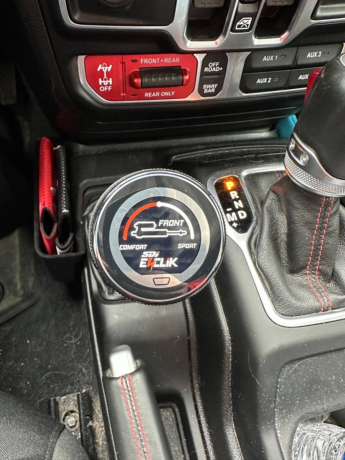

I have the full pro option. It’s $4,600. It’s the top for jeeps. I don’t know where 6k came from, so I’m assuming different vehicles. It’s truly amazing. Zero regrets. You don’t need to swap them if you change your lift. They have three internal clip positions that allow you to change stroke and full stroke extension without swapping shocks. That’s another reason I didn’t go with Fox 2.5 elite.
Jeep Gladiator Automatic swaybar disconnects? IMG_8245
Jeep Gladiator Automatic swaybar disconnects? IMG_8258
Jeep Gladiator Automatic swaybar disconnects? IMG_8259
Jeep Gladiator Automatic swaybar disconnects? IMG_8260
Jeep Gladiator Automatic swaybar disconnects? IMG_8256
Jeep Gladiator Automatic swaybar disconnects? IMG_8262
Jeep Gladiator Automatic swaybar disconnects? IMG_8265
Jeep Gladiator Automatic swaybar disconnects? IMG_8248
Jeep Gladiator Automatic swaybar disconnects? IMG_8257
Beautiful setup! Looks like you did it yourself
impressive! And you did it in the snow, you sir have reached mountain man status.
Cost I was looking at was $4599 + $500 lighting control + tax. Maybe I got that wrong.
EDIT: yeah you don’t need the lighting control, thought that was the LED control screen for the shocks
I didn’t get the lighting control either. It just adds switches for accessory lights so you con control them from the t-case touch screen/click wheel. I was out of switches, but spent $199 on a four switch Voswitch instead. I didn’t want to look down at a touch screen to find lights either.
I did do the install myself. It’s really not to bad. They are very smart to create multiple working harnesses that connect together. That way you don’t need to figure out routing for one monster harness. The most difficult is the shift knob install, but I figured out the trick after a bit of fiddling.
