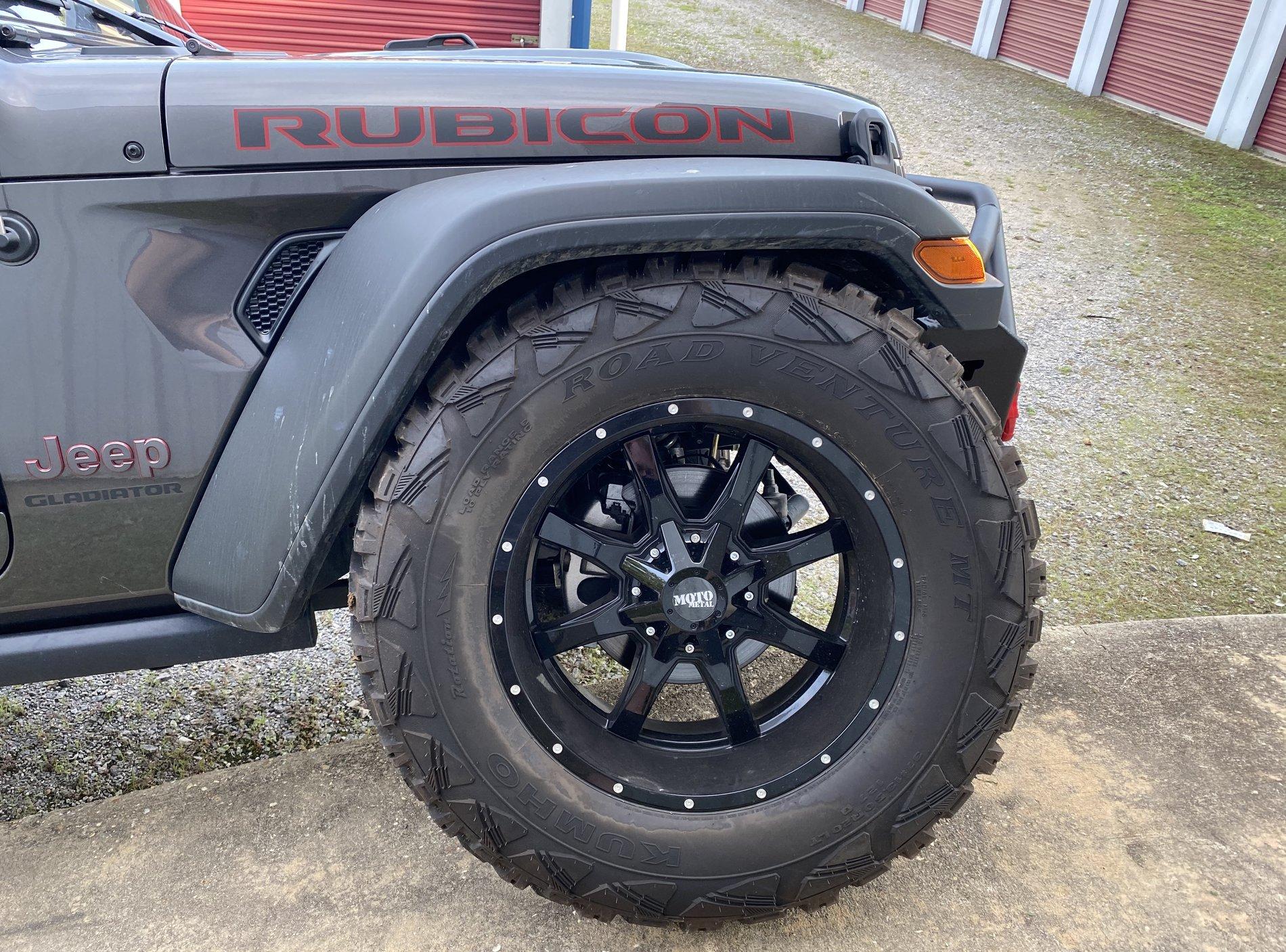

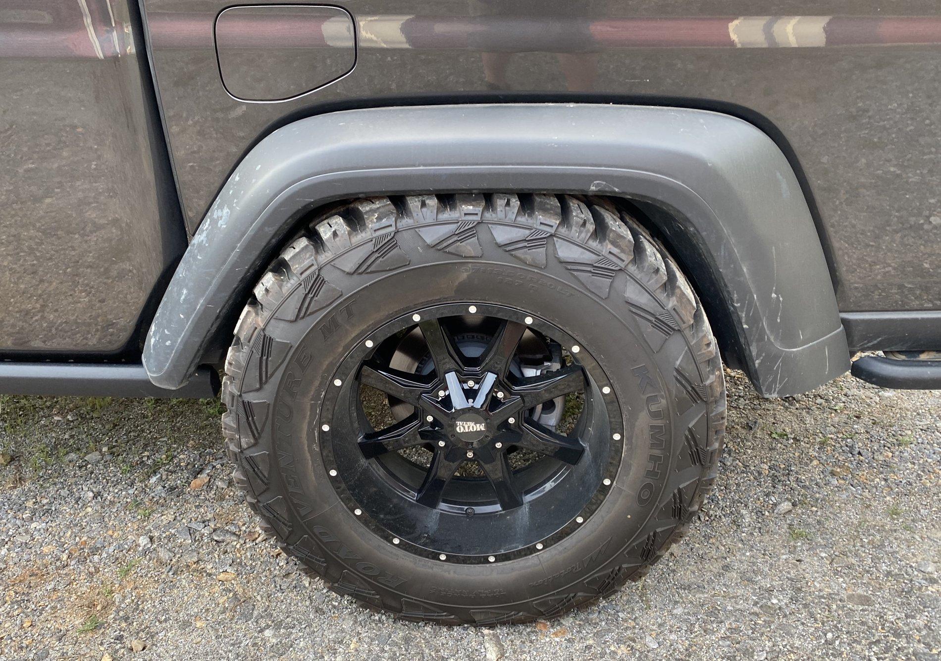

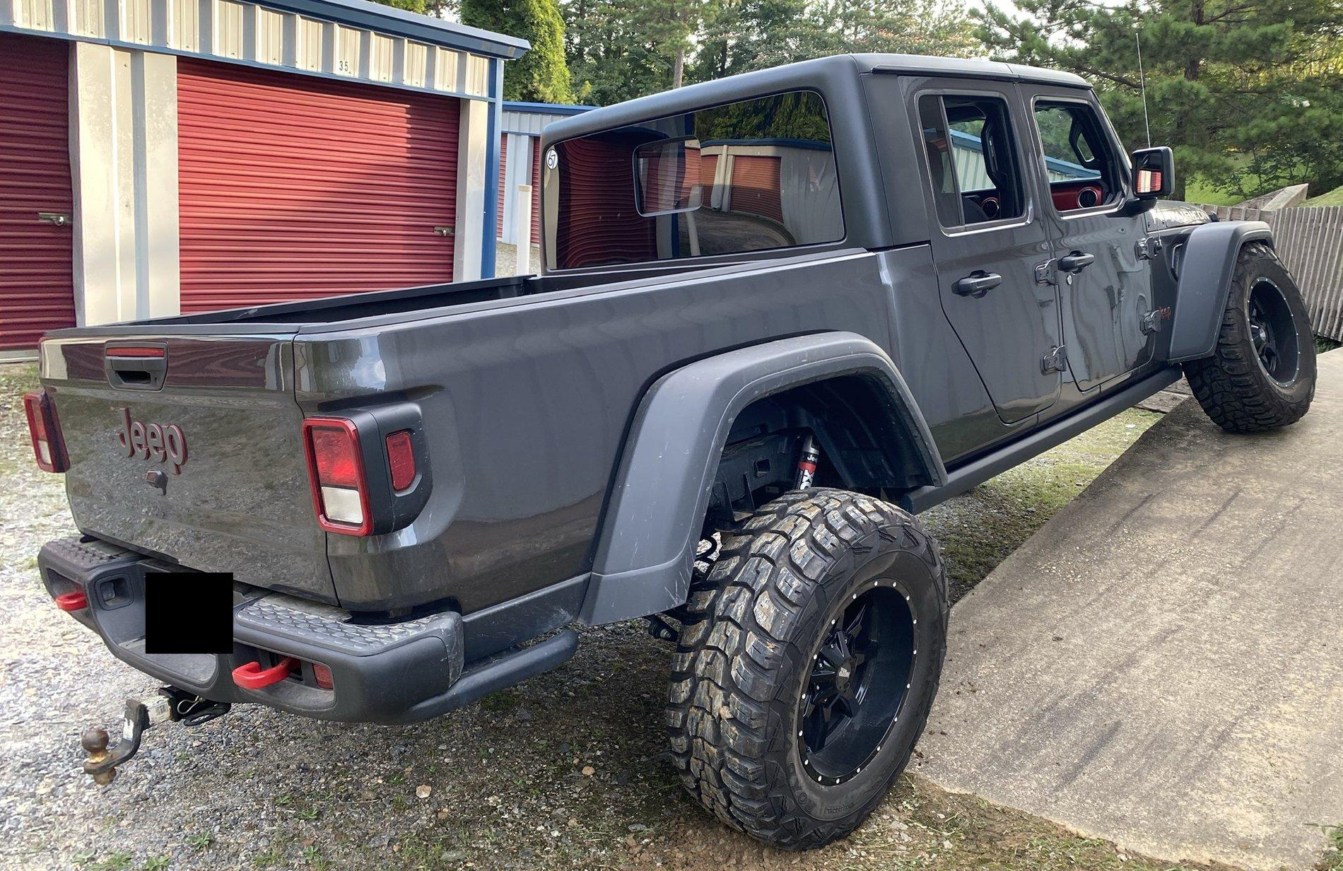

Yep! I was thoroughly impressed with what mine can do in its current form. Tape measured 34" of vertical flex with 37" tires, stock Rubicon suspension, with a 2.5" front spacer, and a 1" rear spacer. Can't wait to see what it will do once I swap all that out, and install my EVO Mfg. Enforcer 2.5" Stage 2 Plus lift that's sitting in my storage unit. :muscle:

The pictures don't really do it justice... I'm not a short guy (~6'0"), and I took the pictures between face and chest height, so it makes the tires look bigger than the concrete ramp, but the ramp measures 36" at the flat top (starting where you see that form-seam that's almost under my tire), and I'm running 37" tires. Next time I ramp it I'll try to get some better (more accurately portraying) angles. I was just really excited how much flex it had, so I just snapped a few quick shots of it.

No, it was pretty much maxed-out with that spacer lift's abilities. My rear tires were stuffed, and with that 1" spacer, that was all the flex she had in the back-end...Which was my limiting factor. Because it stuffs the one rear tire with all the weight on it, and once it's maxed, it will start to pickup the other rear tire on the other side that has no weight on it (which is what causes the tire-slip)... The front could keep going (not much, but maybe could hit 36"), but the rear was maxed.
Now, once I snatch that spacer lift out, and put some real EVO 2.5" coils (front & rear), I should be able to get (just a guess), but 38+" of vertical articulation...If the front fenders don't rip off...So far, it seems to fit those 37's damn-near perfect! :like:

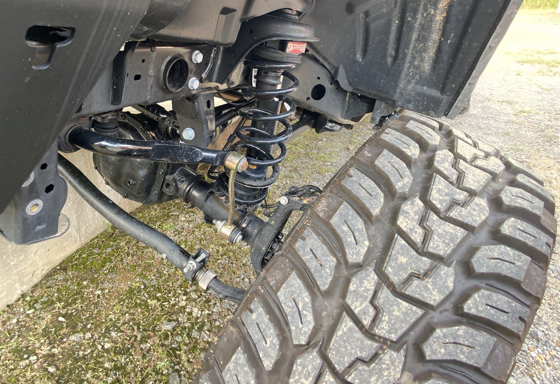

Looking at your bottom picture...
Looks like the end link is single shear on both ends..
Hmm....
I would like to weld a tab on the bottom to make a clevice and use a pip pin to quickly disconnect.
That just gave me an idea...
