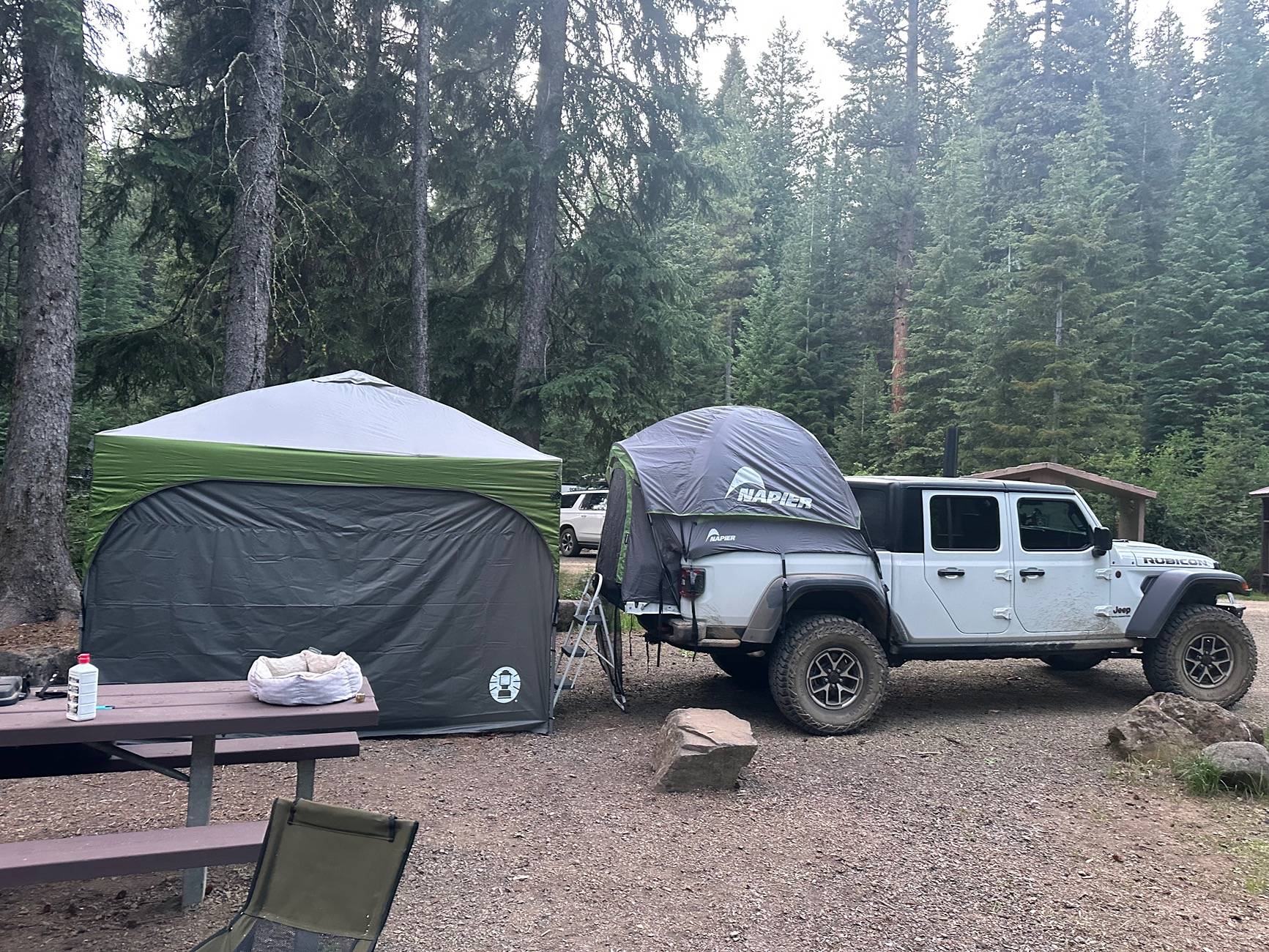

2024 Rubicon. 2.5 AEV spring lift. Stock wheels with 37 inch Baja Boss AT tires (my favorite tires). I added two small washers under the steering stops on each side and no rubbing with an adjustable front track bar to center the axle.
under extreme articulation like the Rubicon, I will get some rubbing on the fenders, but nothing on normal overland trails and normal offroad trails.
I like the stock wheels and wanted to keep them. Unfortunately, the backspacing with the stock wheels means I needed to keep the stock control arms…hence the AEV lift and adjustable front track bar
