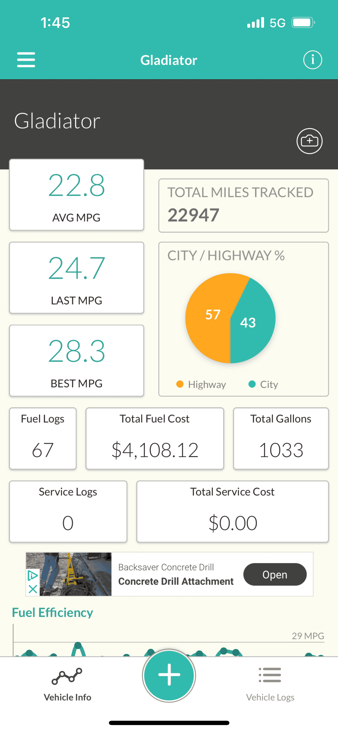

@Jefe1018 Bit late to the conversation but my Fuelly data is below for reference. My city vs highway mix is usually around 50/50 excluding trips. 15-20% of my highway miles are weighted down towing my camper which is around 5k loaded and not aerodynamic, normally 15mpg +/- while towing.
My Glad is a Sport S with 1.5 leveling spacers in the front and .75 in the rear riding on 285/70-17 KO2s, so pretty close to stock. I have a fairly heavy foot off the line and typically stay in the 70-75 mph range on the highway as it chugs along nicely at that speed and passively regens very well at 70+.
