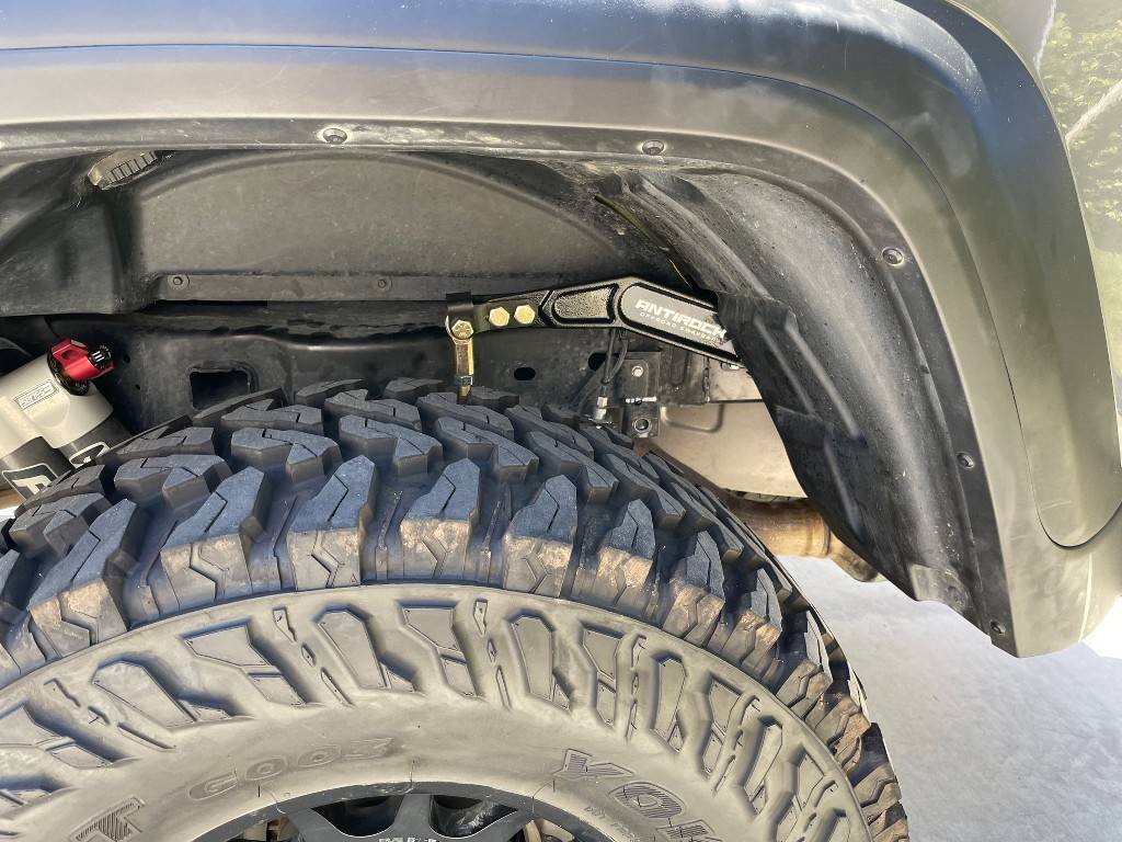

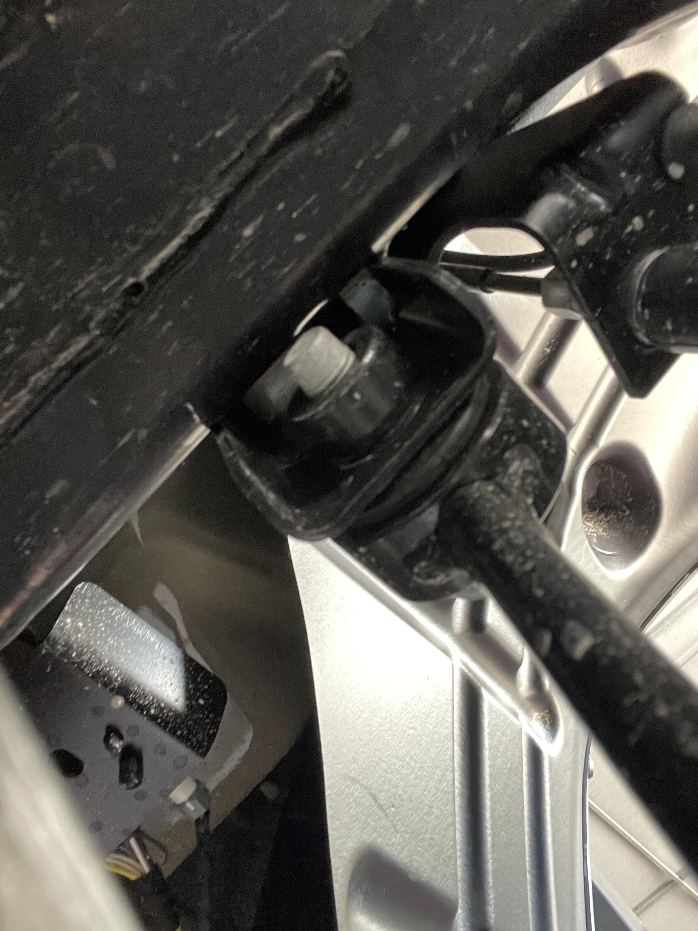

That pic isn't very reassuring..........
I agree. I should give it another inspection soon. That pic was from months ago when there was like 3k miles on the truck…no wheelin, no 33s, all stock lol. That crack is much more pronounced in person, I promise (unfortunately)

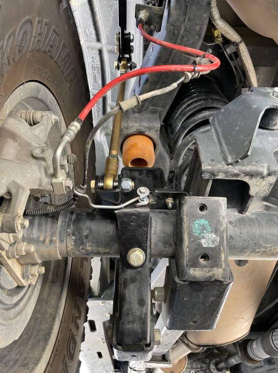

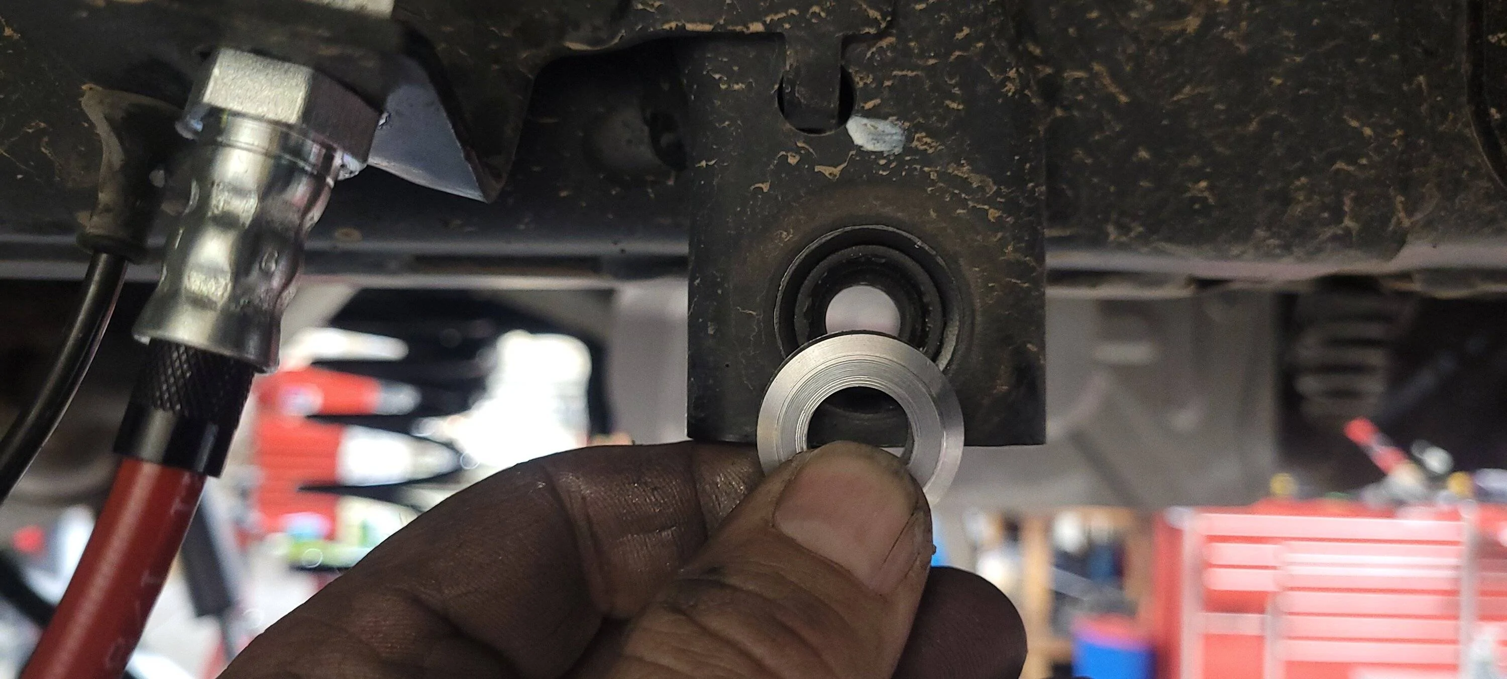

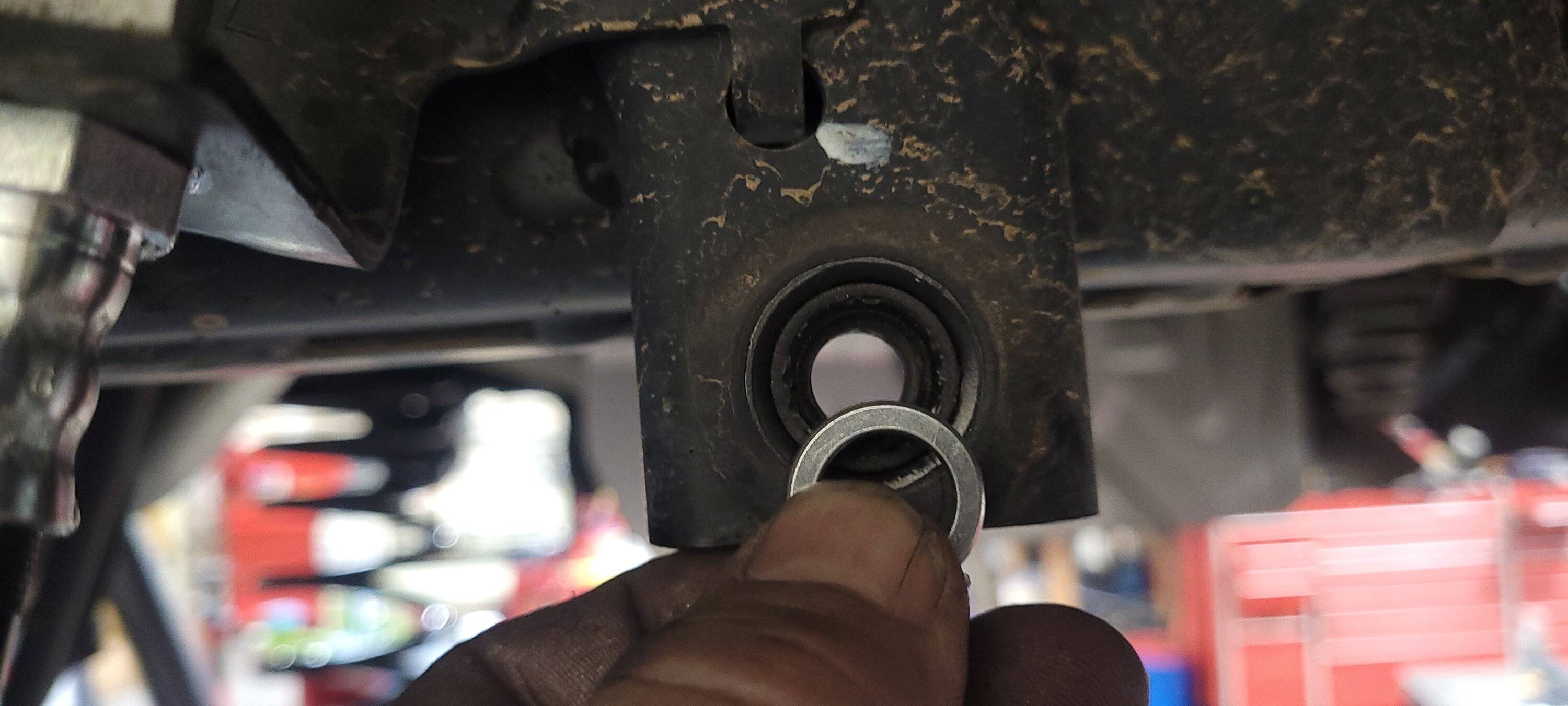

Not sure if I posted on this thread already, but I do feel it's the undersized inserts that crush from being also split the aftermarket supplies that is the issue here. If you look at the OE link bushing diameter, it is actually pinched to the bracket, where the aftermarket links sink into the bracket and depend solely on the weak insert.....That obviously tears out!

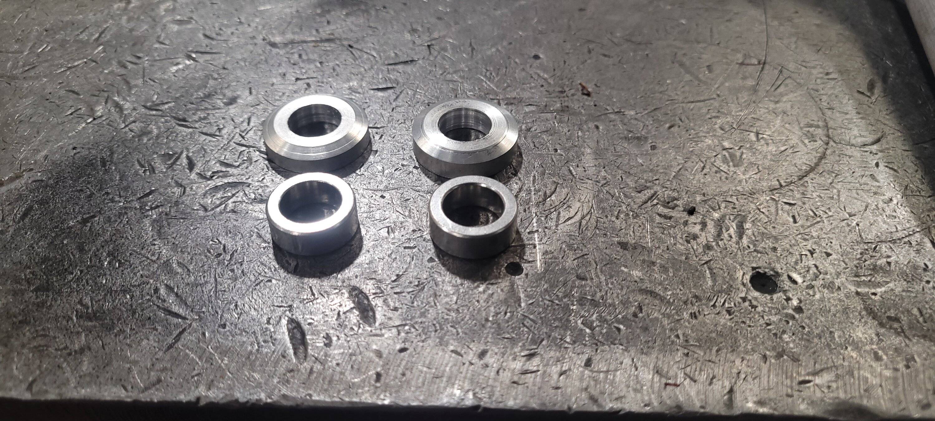

Here's my quick solution where I just machined some misalignnment spacers out of larger material. I finally took pics during a client build today to illustrate. These are from @Clayton Off Road rear links which I think are some of the nicest in the business, but I just can't bolt these on "as is" feeling like I'm possibly doing a disservice? My truck has 34K miles and at least 1/3 of those off road......My bracket is still hanging in there? Might be on to something?
Jeep Gladiator Broken tab/weld  on Mojave Frame..No Warranty??? 20221212_121021
VS.
Jeep Gladiator Broken tab/weld  on Mojave Frame..No Warranty??? 20221212_121013
For comparison:
Jeep Gladiator Broken tab/weld  on Mojave Frame..No Warranty??? 20221212_120845

IMO, it doesn't help that the link is hanging out there off the side of the bracket and not between two brackets. There's a lot of force pulling down on the side like sticking a long bar in a hole and pulling down on the end.
That's the sort of thing I've done in other situations where things don't fit as I know they should. There are ways bushings should fit - and ways that they don't always make that.

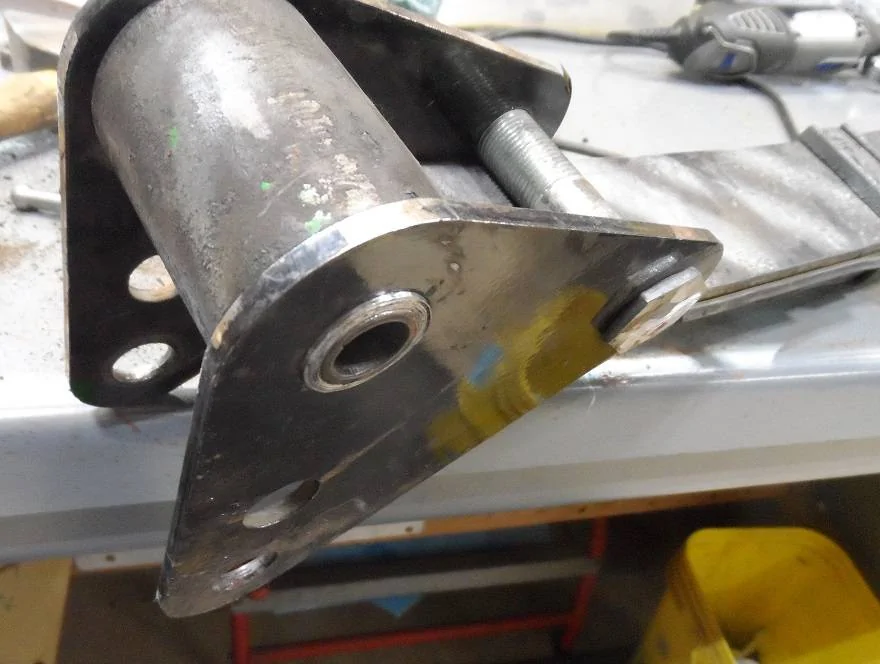

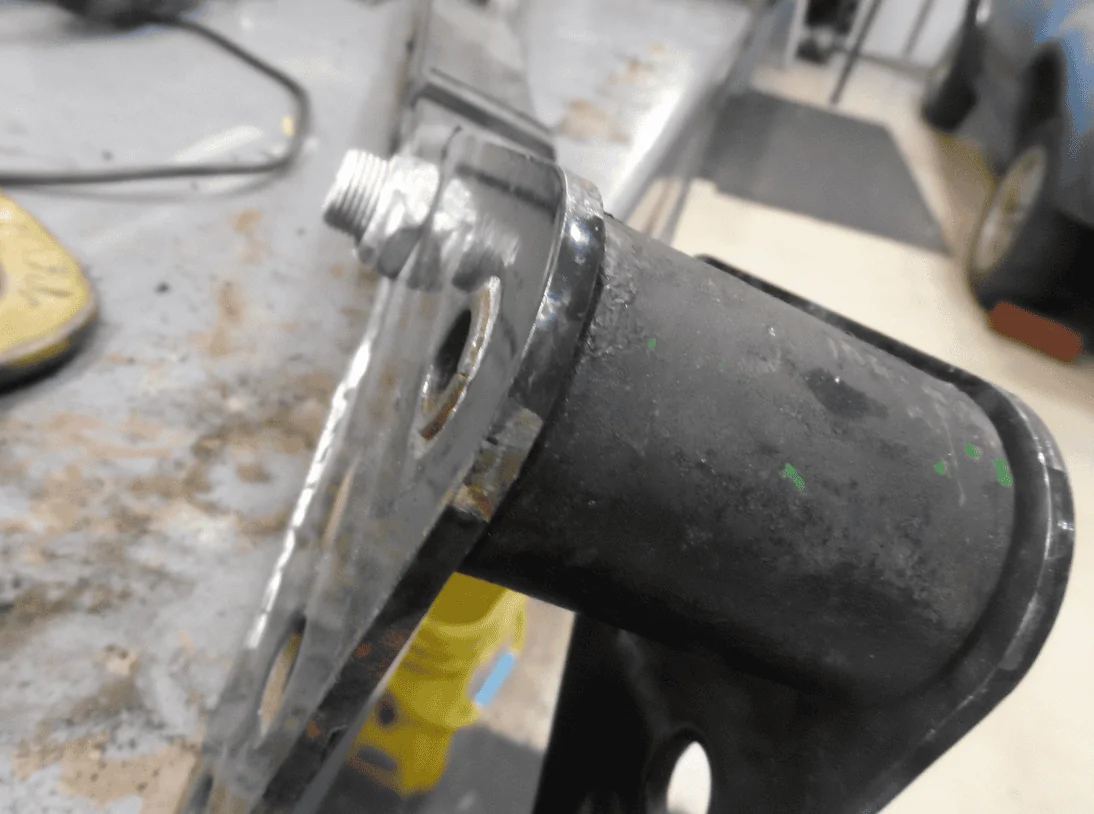

One example is the CalTracs for my Javelin - I got them and like WTH - no way. So I made bushings - actually "spacers" so the spring bushing could be pinched in place and not pivot but the CalTrac brackets would pivot around the spring bushing shoulder like they should. Had to trim the spring bushing a bit, made the spacers for the traction bar brackets.
We gotta do what we gotta do.
The silver is my spacer that allows the bushing core to be pinched in the frame and held solid as heck, but allow the black bracket to pivot on the bushing core.
I'm not sure what the deal was - incorrect parts or what - but it's taken a heck of a lot of pounding with that dual-quad V8 and no issues.
Jeep Gladiator Broken tab/weld  on Mojave Frame..No Warranty??? caltracs-bushing-mod-5

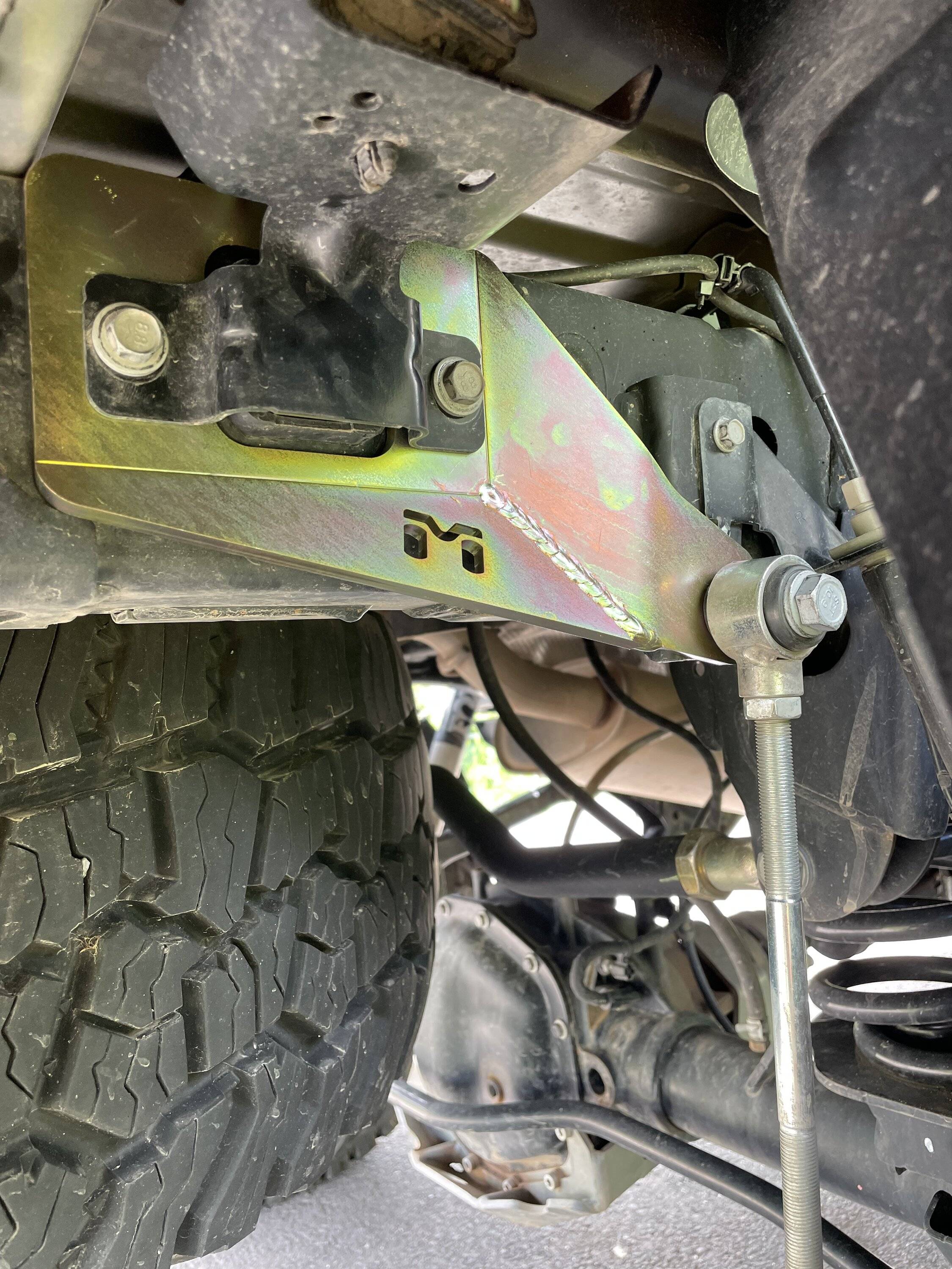

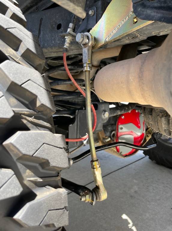

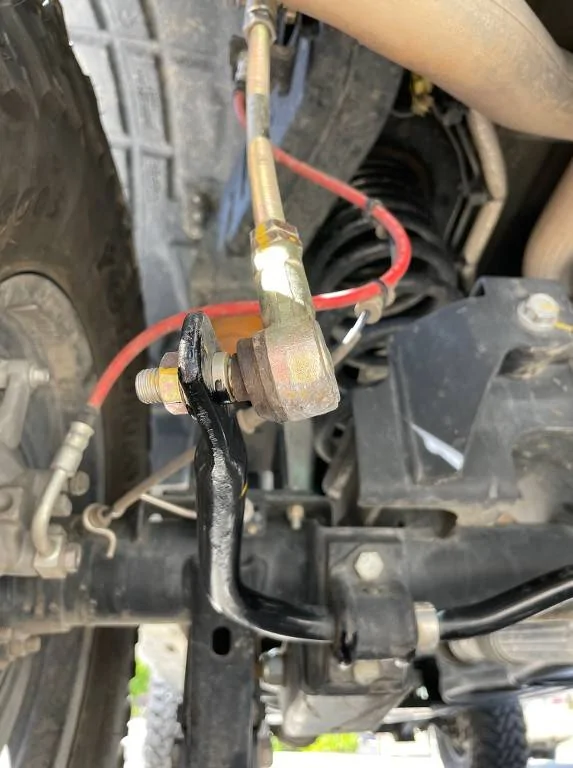

After reading this article with the upper sway bar mount I just ordered metalcloaks reinforcement and repair brackets Only $79.
This will fix your current problem, but, if you 4wheel rocks like me, then, you will bend your end links and sway bar tabs.

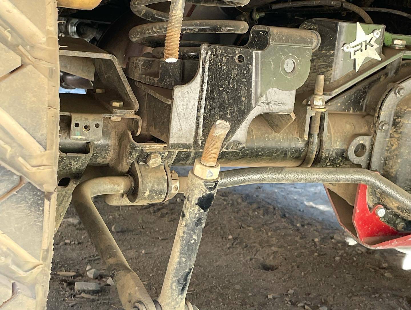

I finally got sick of the issue and went with the Rock Jock anti-rock rear. Teraflex also makes one that is cheaper. That fixed the issue permanently.
Jeep Gladiator Broken tab/weld  on Mojave Frame..No Warranty??? 9pDFQt
Jeep Gladiator Broken tab/weld  on Mojave Frame..No Warranty??? 8L4cxf
Jeep Gladiator Broken tab/weld  on Mojave Frame..No Warranty??? iZWJzP

IMO the JT rear sway bar is trouble just waiting to happen. It's a poor design, weak, and the angles of the forces exerted against it are just wrong.

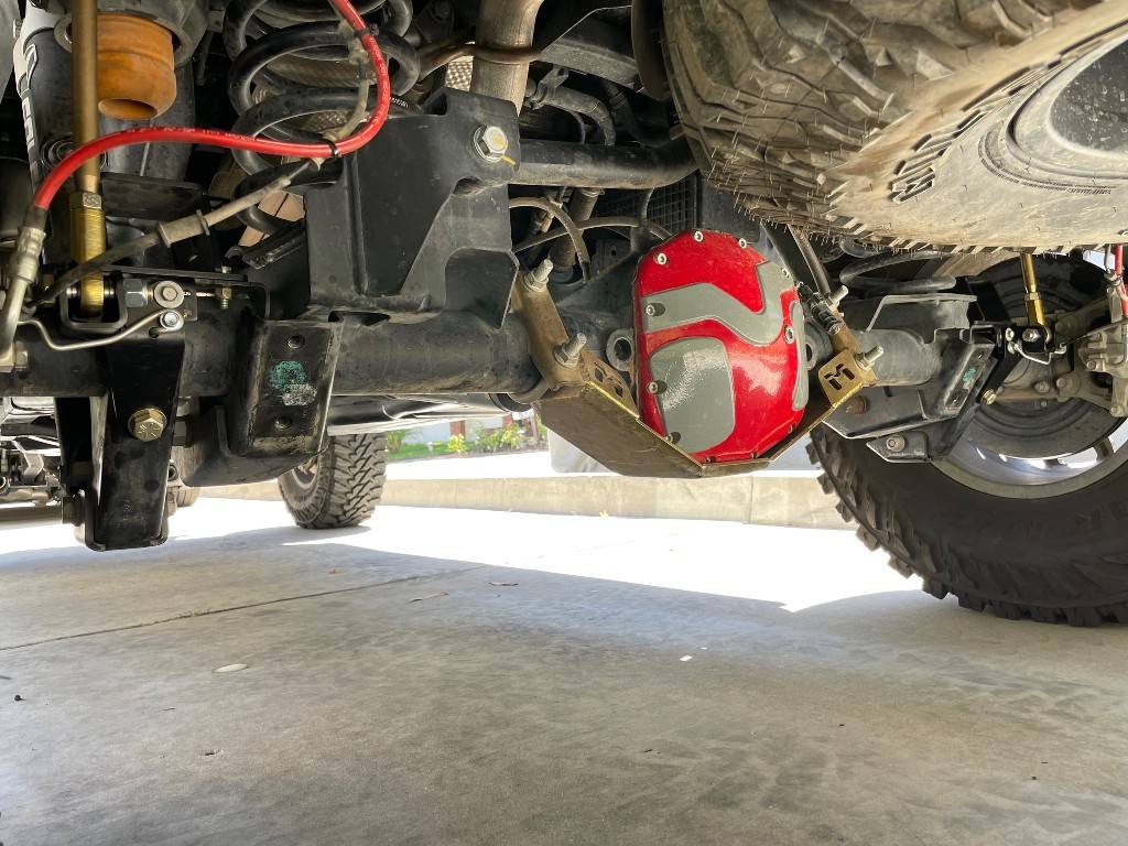

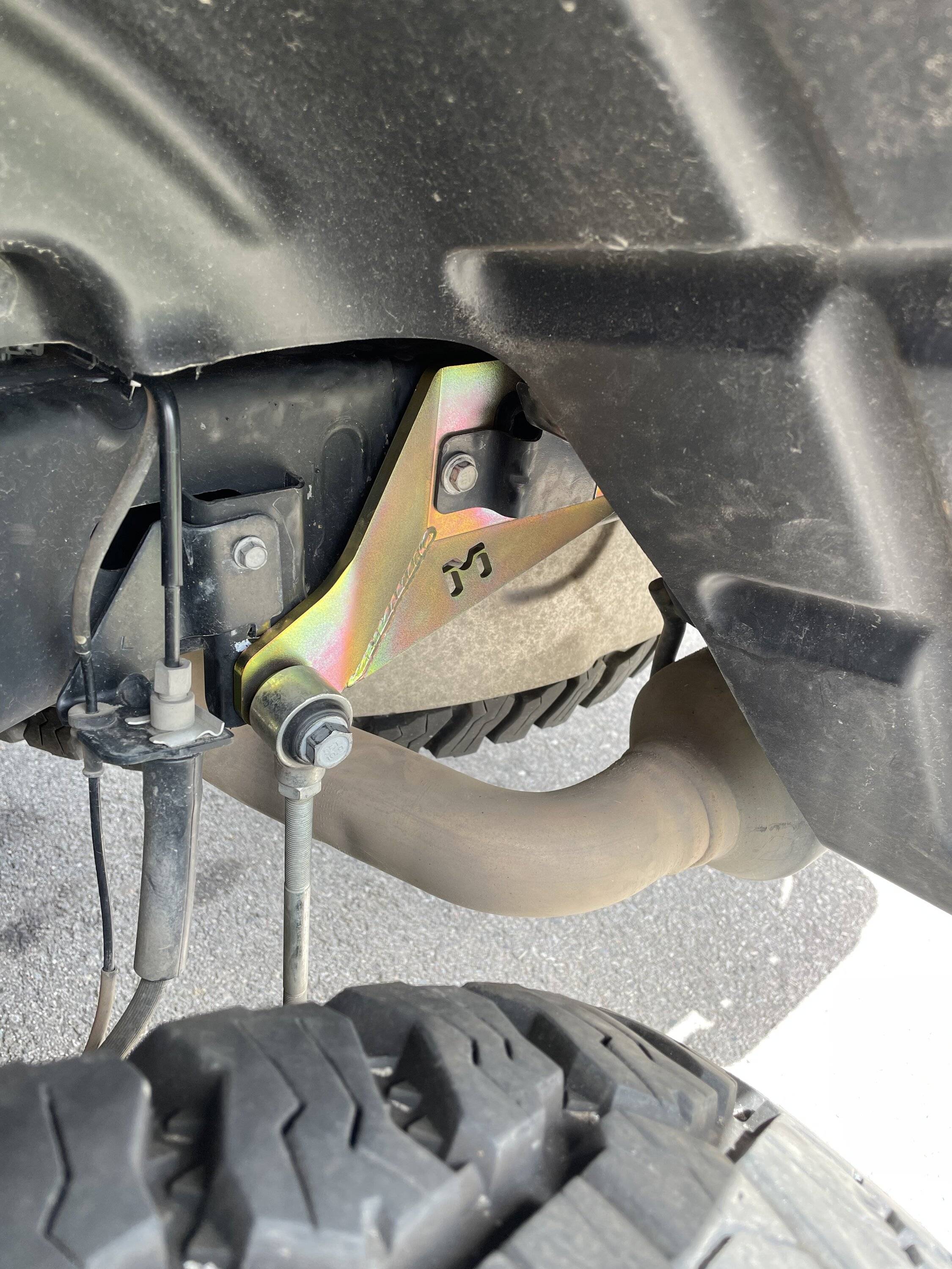

As frustrating as this is, it’s fixable permanently with $80 brackets from metal cloak. The unbroken one on the other side will be prevented from breaking with the same bracket. You’ll be fixed in 15 minutes.

The Metalcloak braces are great (I have them too) but the force is just transferred to the next weakest part
Jeep Gladiator Broken tab/weld  on Mojave Frame..No Warranty??? 167E3BCD-6363-497D-A66D-7CC7961A4E0C
Moral of the story... carry a set of spare links.
I'm seriously thinking about an Antirock in the back ... they make a nice heavy duty one for the JTs now.
