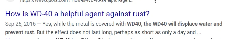

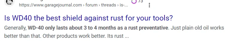

WD40 is a joke for preventing rust. Ask the people who coat saws and other tools in their shop with it only to find............ rust...... a few weeks later. Tried it myself on backsaws and other saw blades - still rusted. Even the tools in my auto shop - rust with WD40.

I stopped using it years ago- found better products.
