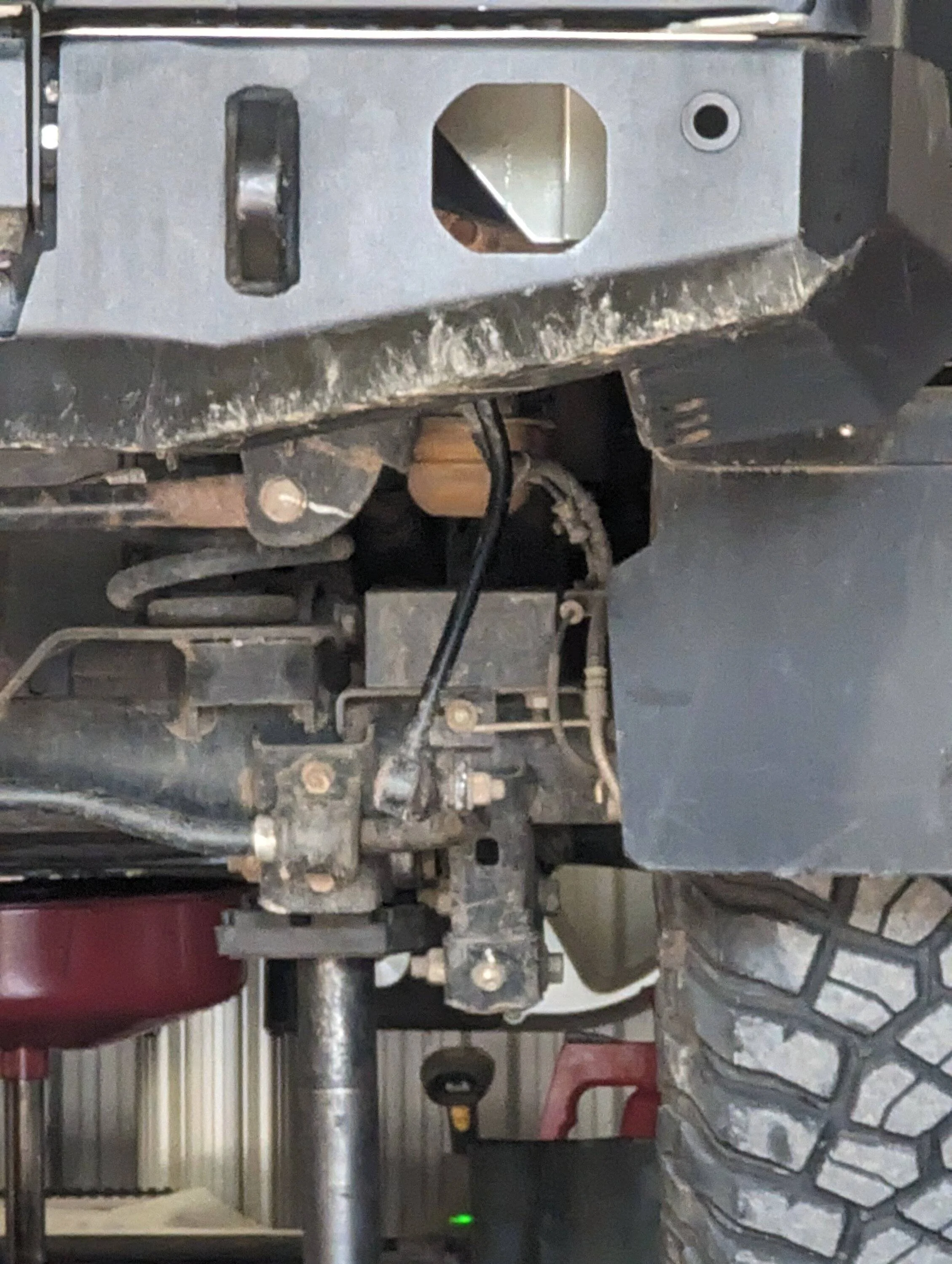

I bent my passenger side link for the 2nd time last weekend. Broke the 1st one. So I have EVO links coming today. These are much more substantial so it looks like the next weakest link will be the mount on the frame. I guess I'll be fabbing new mounts next.

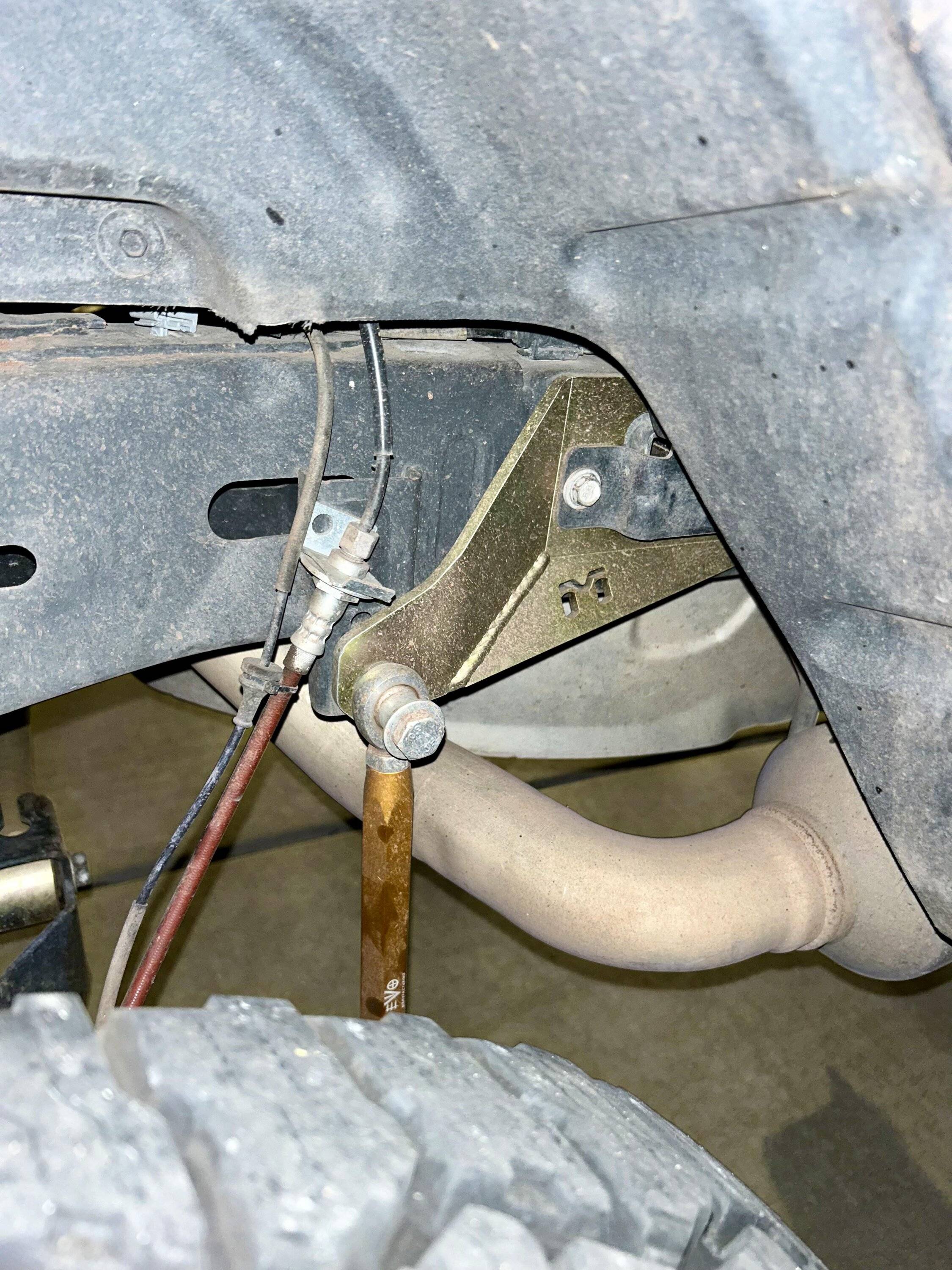

I did my @Metalcloak swaybar reinforcement plates as soon as I found out it was a possible problem

Yes...You all should be picking up a set of them or something like them BEFORE you have issues. Much cheaper to prevent then to repair this stupid design

I just bought a set although I opted for the EVO ones since I just bought a set of their links. Might as well keep it the same. And I had some points to use at @Northridge4x4 and they don't currently carry the Meatalcloak. Same flavor, different brand. I honestly didn't know these even existed so seriously thanks again @Lunentucker

Sorry to hear about what happened man. Definitely recommend the MC Reinforcement brackets. Great product, and quality + customer service is TOP TIER.

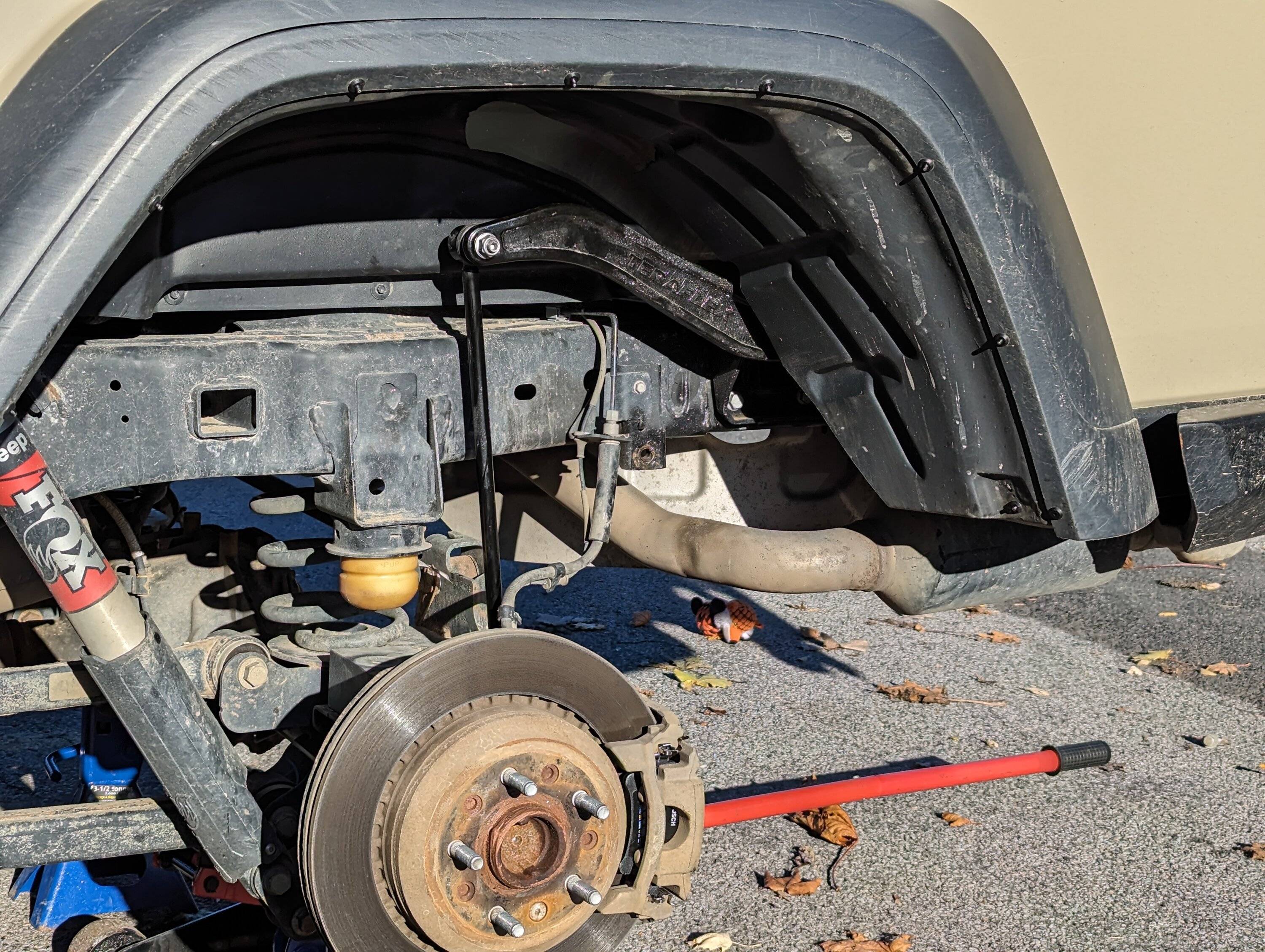

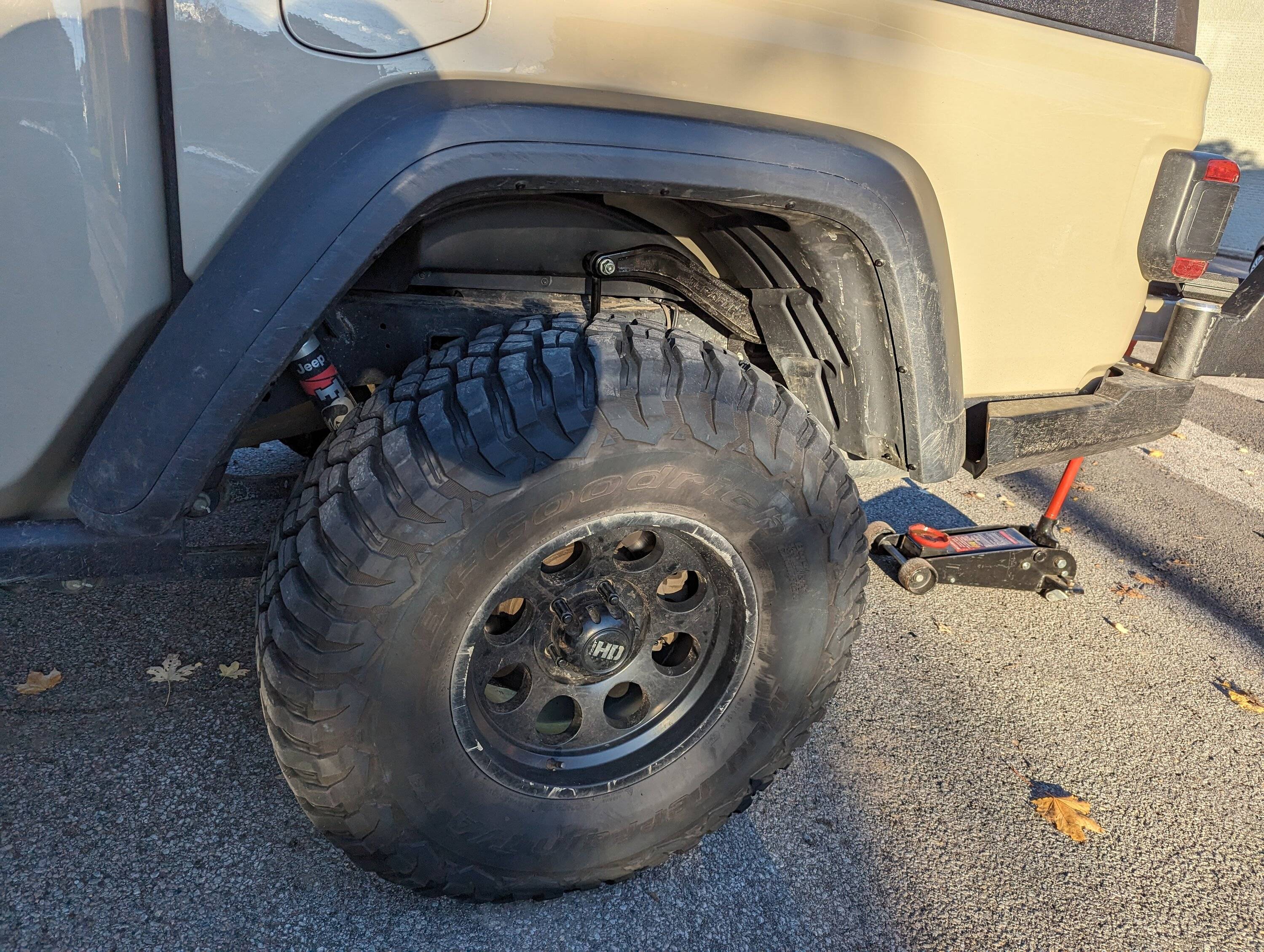

I had the same problem, both brackets broken and both links bent. I went with the teraflex rear swaybar and really happy with it, especially at half the cost of the RJ. And it feels stiffer than the stock one, a good plus with the added weight of the topper.
Jeep Gladiator Broken rear sway bar frame mounts 1000008481

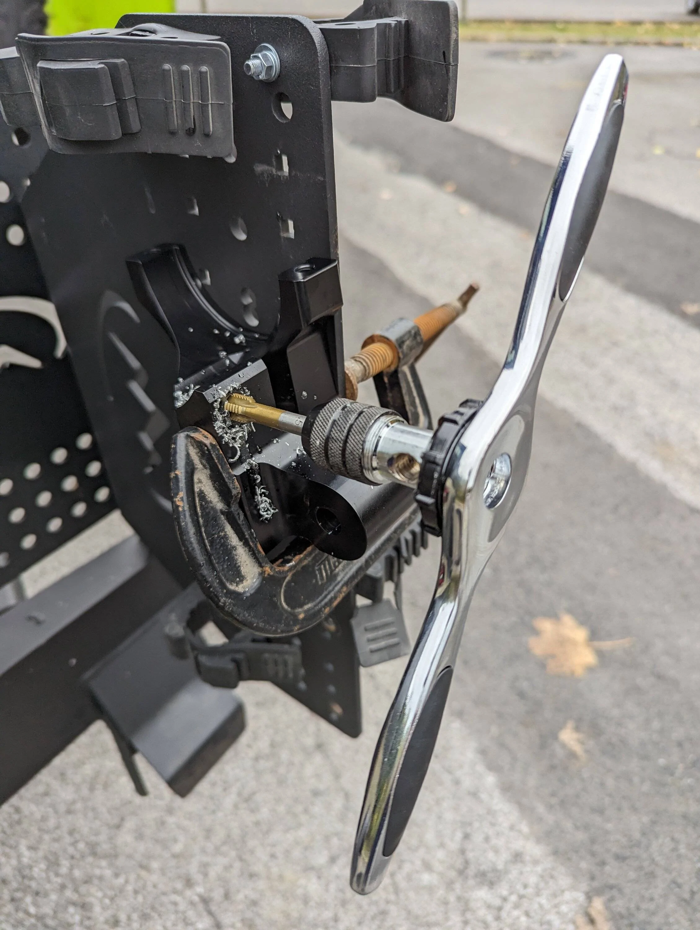

Just had to drill and tap the right axle bracket to fit the AEV bumpstop spacer.

Yes Sir, takes like 30 minutes to install
