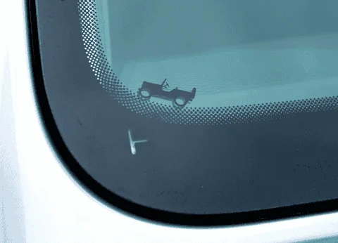

The Jeep silhouette actually reminds me of an "Easter egg". guessing thats what you were going for, and its well done. Id purchase the blank ones but the silhouette will sell IMHO
That's exactly what I was thinking of :)

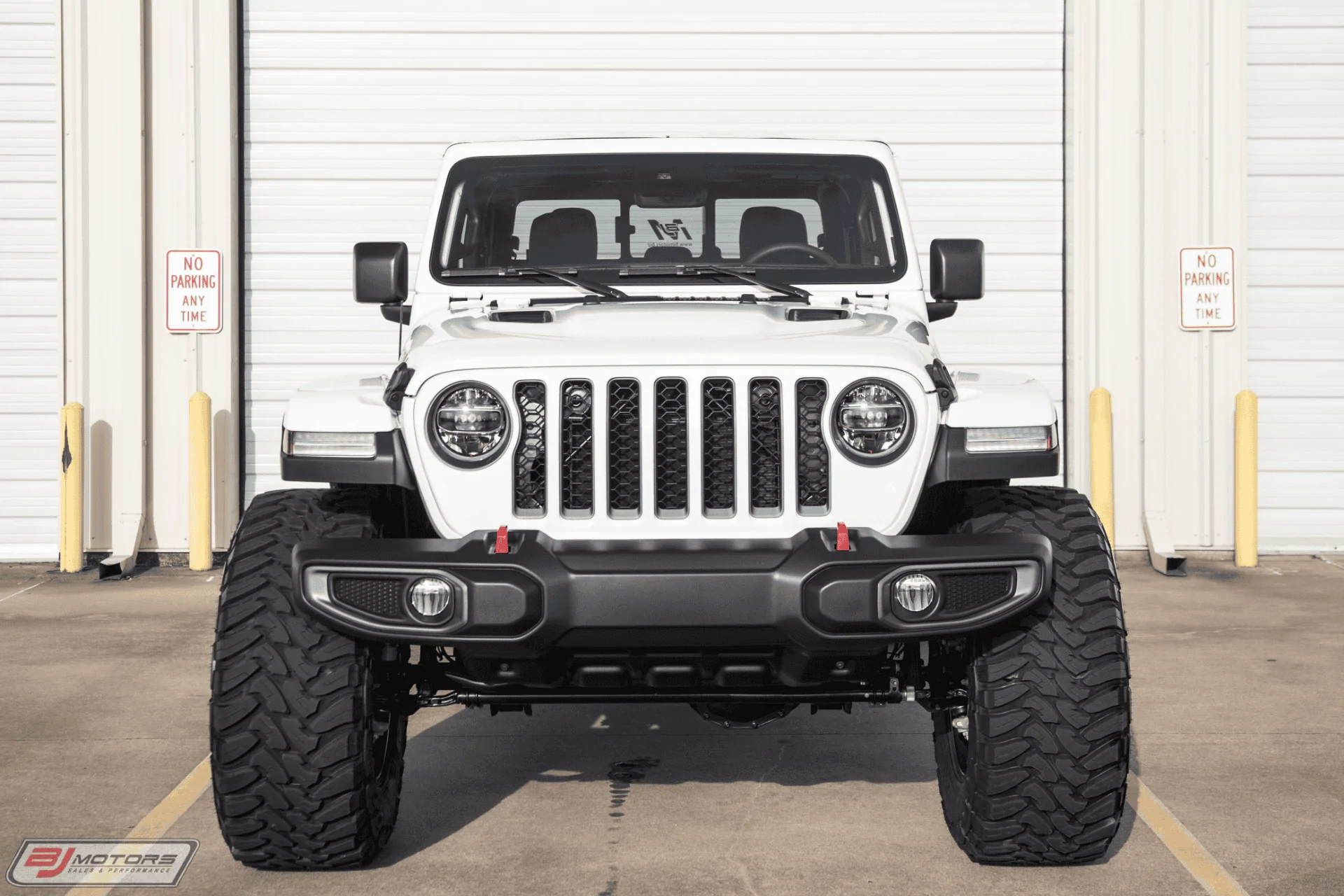

I still kinda like the blank the most as well. I knew something still felt off with the fogs, they need to be outset from the headlights and not under the grill slots.

My thought when you had previously mentioned the silhouette was more of this. Link below. I think this would actually get really busy unless small (the windshield Easter egg), let alone it being a PITA to CAD up for a print.
https://www.keywaydesigns.com/collections/iphone-13-cases/products/off-road-wood-iphone-13-case

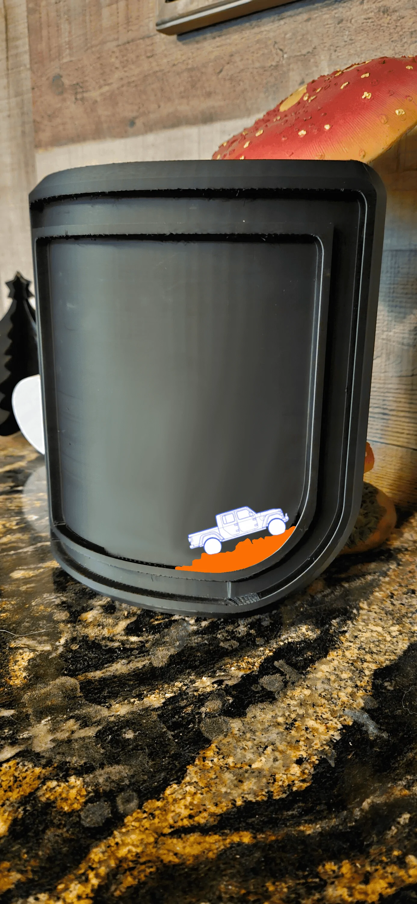

My quick photoshop. Didn't turn out that bad of course not all the detail lines needed in the silhouette. I used the metal wall art of cars you can find all over the interwebs for the silhouette. Maybe gives people an extra level of customizing after the fact.
Ha you did a great job!

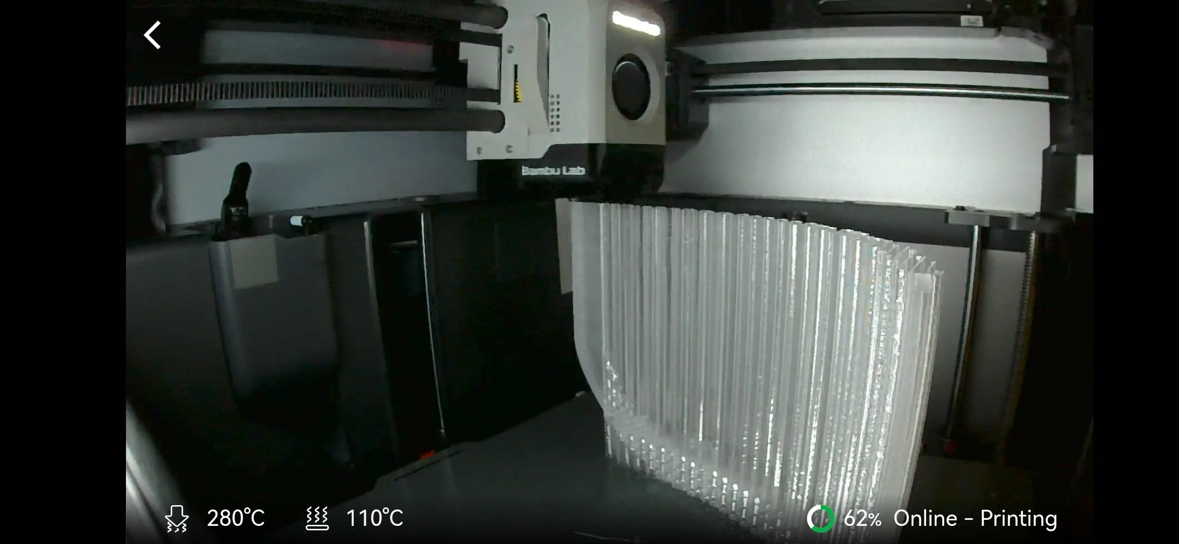

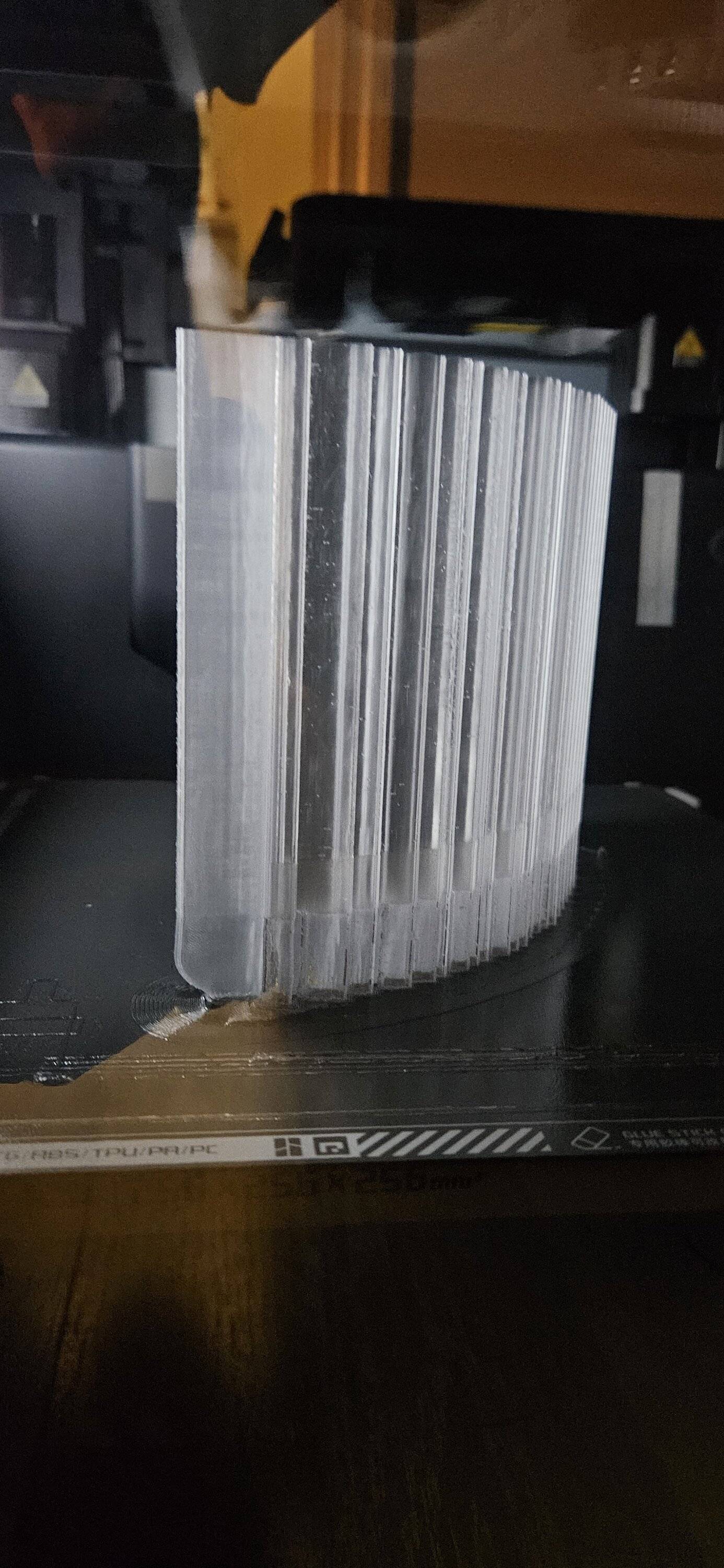

Here's the lens being printed.... Keep in mind, a lot of what you're looking at is supports to support the top when it gets to it...
But you get a good idea of not perfectly clear but clear enough and enough hase to help scatter the light ...
