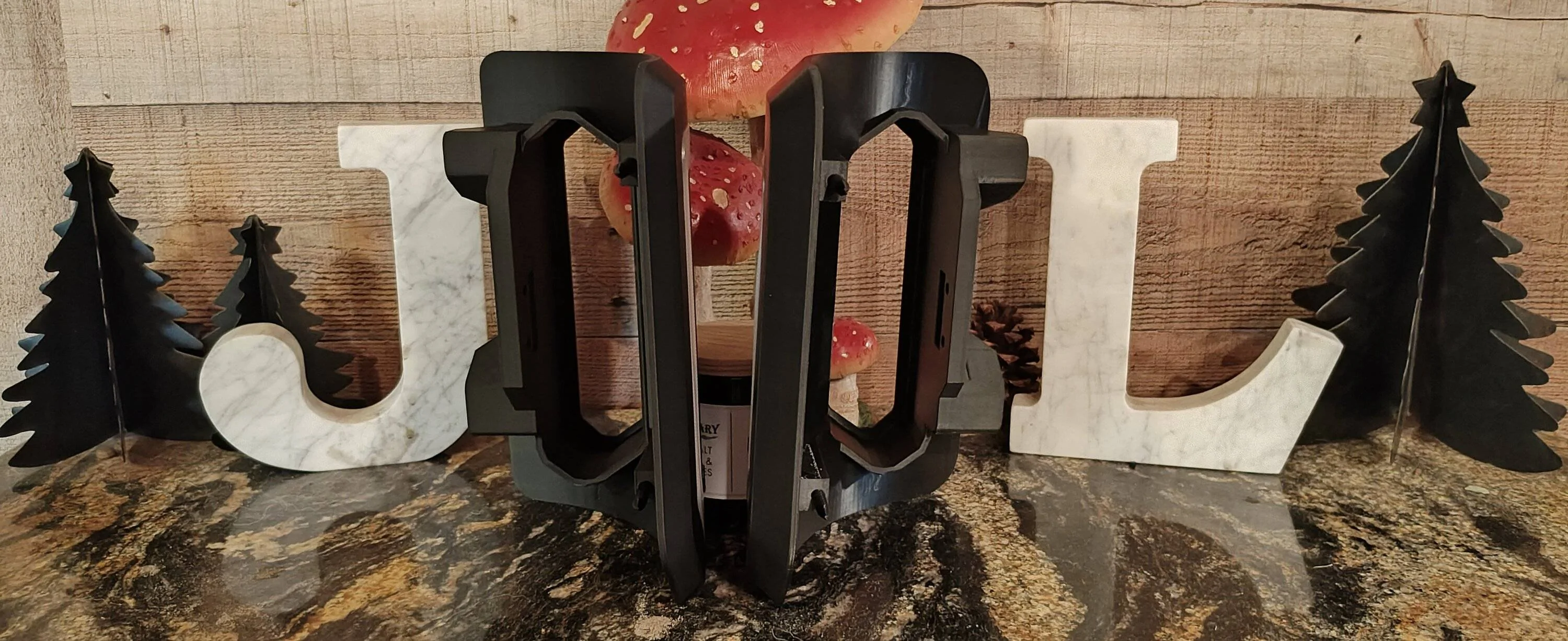

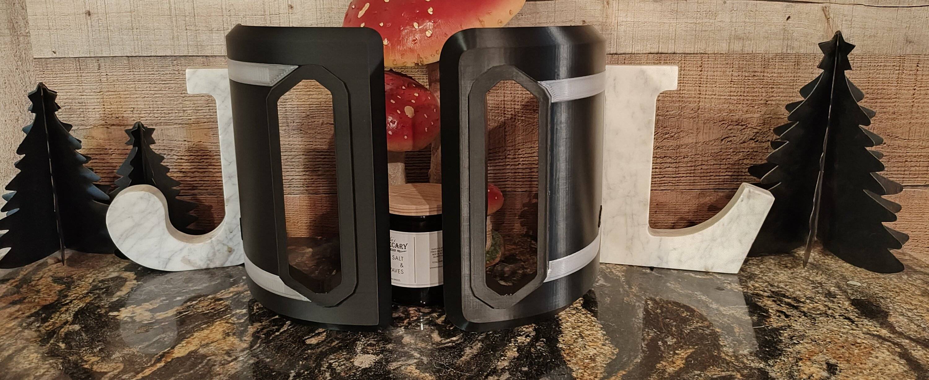

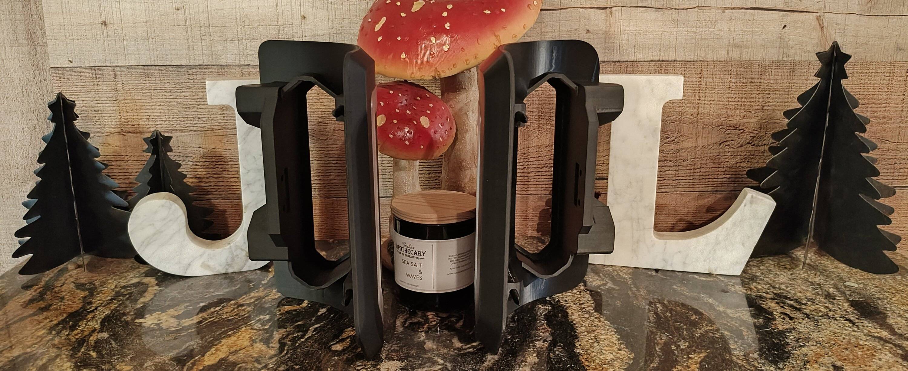

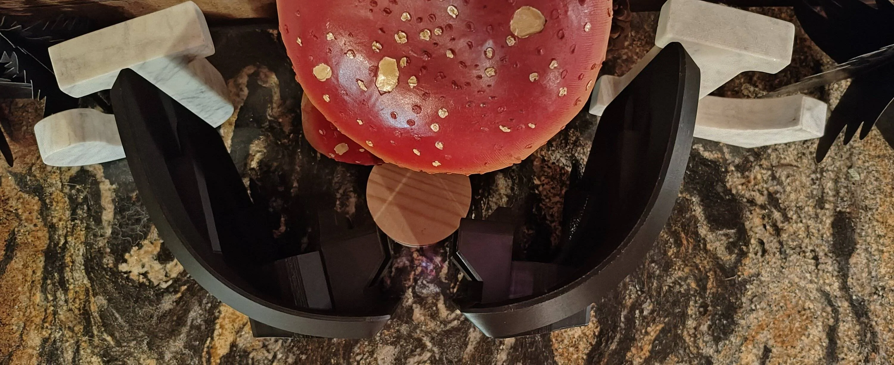

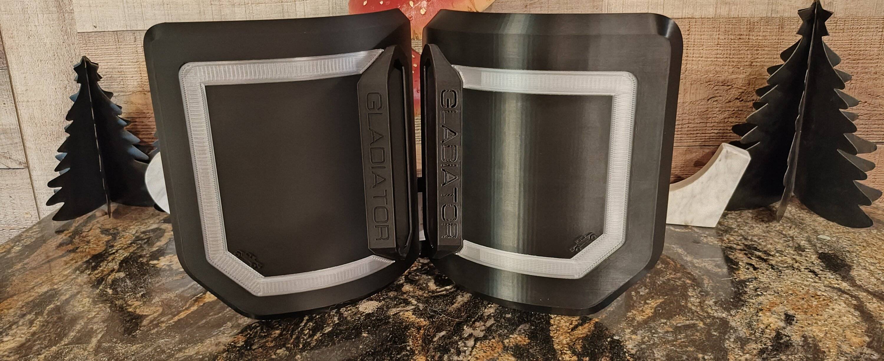

As for a update, I have made a thinner version ..
Just finished making adjustments to it, and have some final prints going right now.... I was able to change up the lens a little to hide showing individual LEDs.... I think everyone will like this version much better... It's only 5mm skinnier but I think it looks a lot more pleasing to the eyes.
I'll have pictures tomorrow

I like that the strip is closer to the edge of the back light housing. Makes the connection there a straight cut instead of following the curve in the tail light. It visually looks much thinner on the top view picture.

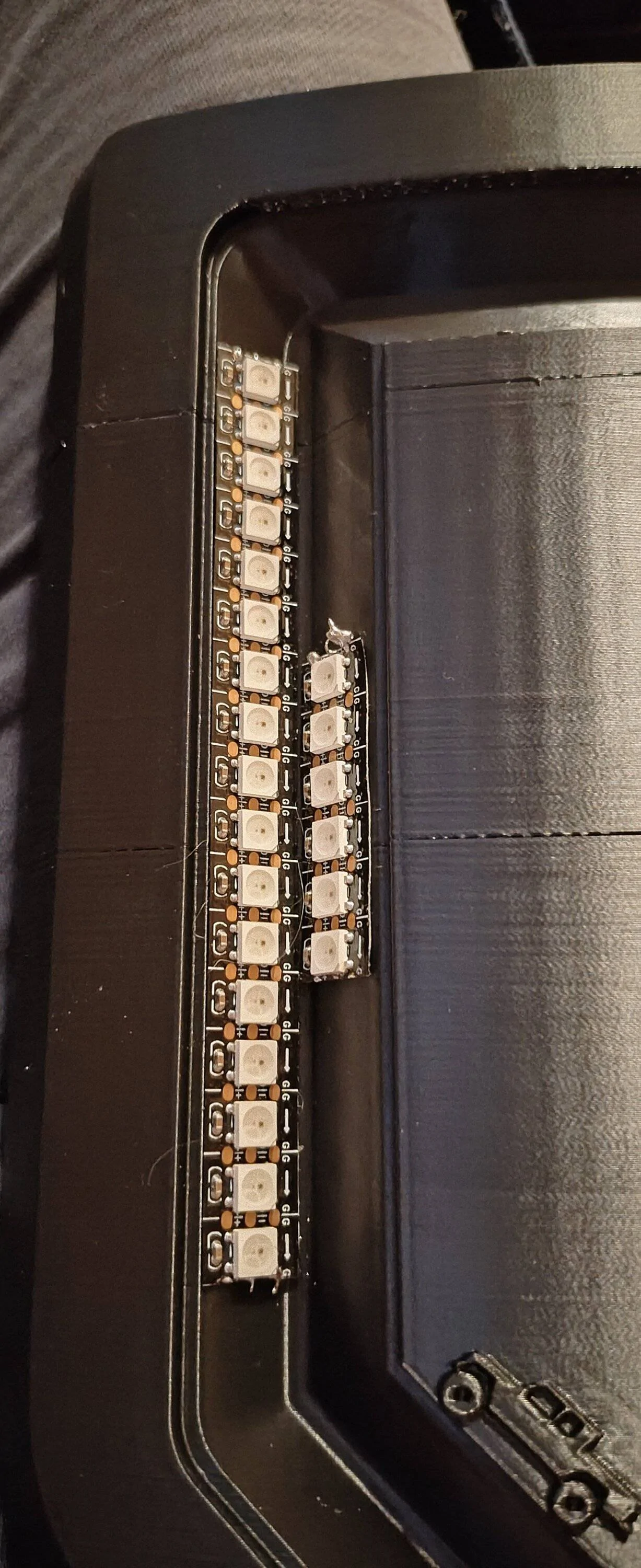

Here's a look at how the tail light functions so far.... Still have some work to do.
This is the older style tail light that I already had LEDs in... Wanted to see how bad wiring was going to be... Got some stuff to work on with animations still too.

you are going to need to split that LED strip in to 2 half's and wire each one half off the same input and have the end of the strips meet in the center of the C if you want to get a sequential strobe that shows a direction.
Justinswidebody
Dec 21, 2022
463
1,142
Ocala
Jeep gladiator
Don't have to split it, I can do that with programing.
I'm still learning C++ to do all the programming on these.
But because the gladiator uses the same wire for brake and turn, I have to get creative with the programming...
It's a big learning curve...
