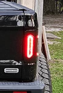

The cad files, and coding are complete.... It's the wiring that is the fun part.... But then there's the not being bright enough..... I have new LEDs that fix that, but they require a lot of soldering, and a different programming board that cost $34 that has I believe 28 out puts.... So every 3 to 4 LEDs will have to have a resistor and wired to a different output channel to be able to do patterns such as sequencing, start up animations, and so on .... A lot of work.... so much work that you would probably have to sell for $1000 to make any sort of profit for your time.
All of the animation stuff is cute but not what I am particularly concerned about / interested in. I just like the more elegant and cohesive styling of your design with the perimeter light and tail. I can completely understand not wanting to spend that kind of labor cost on making all of the shiny doo dads work. Maybe sell a DIY kit for those that want those doo dads to work?
I could probably still produce without animations.
Wiring the animation board is the time consuming part.

Did a complete redesign from ground up. I know hardly anyone will be able to tell....
Made things look more proportional, moved the mount for the light to the other side to allow for Blindspot sensors whenever I get around to designing that set...
Made the led channel deeper so that I can mount the LEDs to the side of the channel to help eliminate seeing individual LEDs.
Made the GLADIATOR word big.... Plan is to make a lens for the word so that debris don't get into the housing....

Figured I would share my progress, and would love criticism, likes, ideas, other style lights, let me have it all......
Keep in mind this is still in prototype stage. Still have to add side markers. Make a finer 3d printed housing. Current housing is ruff draft quality for fast print times .​
