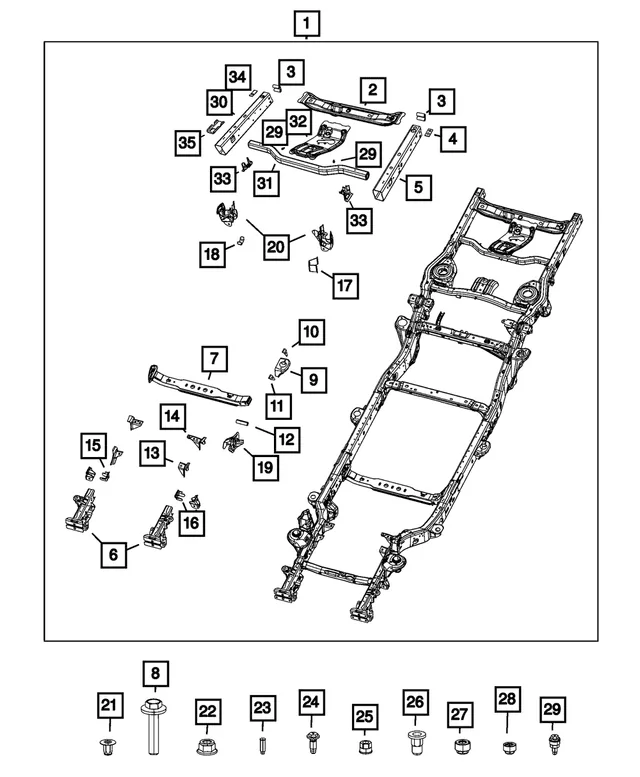

The shop is probably saying they can section the rear rail that is damaged beyond repair. Some manufacturers build in sections that can replaced over replacing the whole frame. It depends on where the damage is, to be certain there isnt damage further up you would need a setup and measure on a frame rack. A quick search on mopar shows rear rails are available for sale. #5 in the diagram below. And yes shops still make pulls to frames but have to be careful because most are hss and have restrictions on being heated.
I believe Jeep indicates, not necessarily in so many words, that parts of the frame are not HSS.
You may have found those areas.

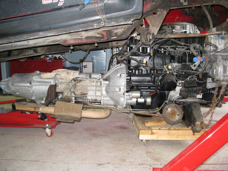

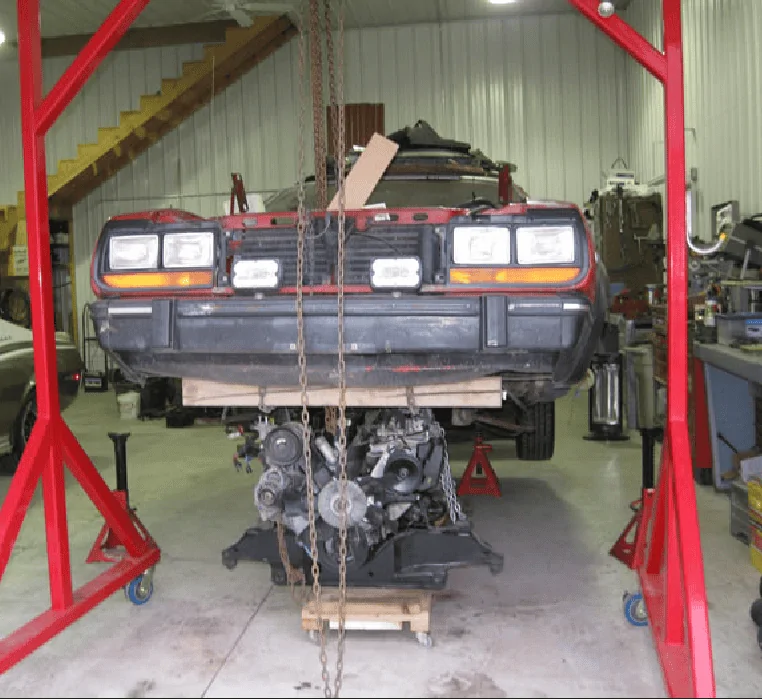

I recall replacing an engine of a Lincoln LS was it? 20 years ago. Nobody else in the shop would touch it, so of course the new guy got it, but being the only one willing to work on hard jobs I had at it. First thing I thought was insane was the driveshaft went over, or was it through..., the gas tank. And the design of the vehicle, the only way to get the engine out was to drop the entire subframe and trans at the same time. lol. The shop foreman and manager were questioning their decision at the time until they looked at the repair manual themselves. It was a 2.5 day project. At first I thought it was insane that they designed it so that the whole front end, including suspension and all would have to drop out of the car. But after it was all apart, the engine swap went super easy - just slow since I had never done a Lincoln before and neither had the most experienced guy in the shop. That was one of the rarer instances where I didn't make threatening remarks toward an engineer - any tech would understand that statement haha.
Best way to do engine work outside of the car is out the bottom, IMO............
