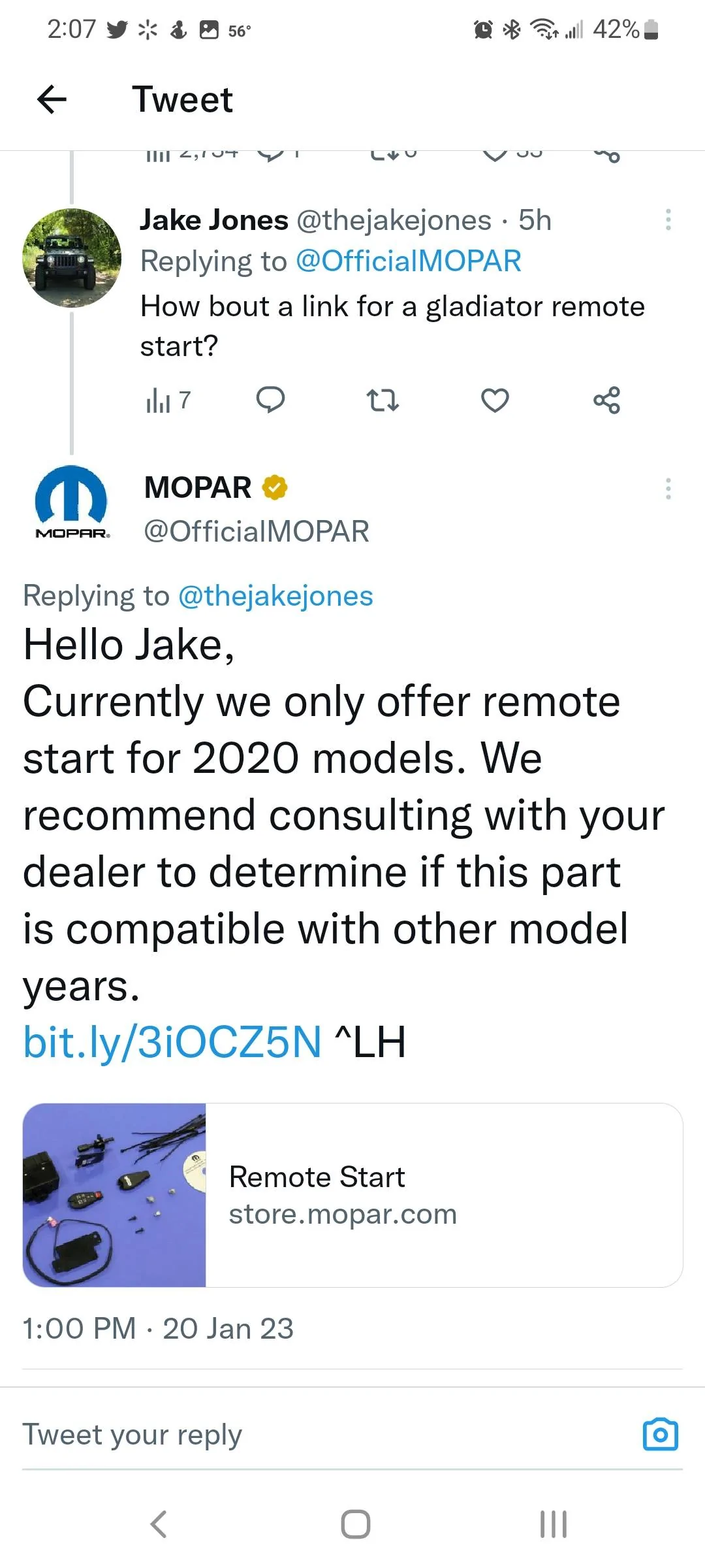

Did you install this. I'm looking at remote start for my 22 rubicon.. mopar says they only offer the kit for '20 models, and I don't trust a dealer. Thanks
Jeep Gladiator Can JScan detect if i have modules and antenna for remote start? Screenshot_20230120-140704_Twitter
