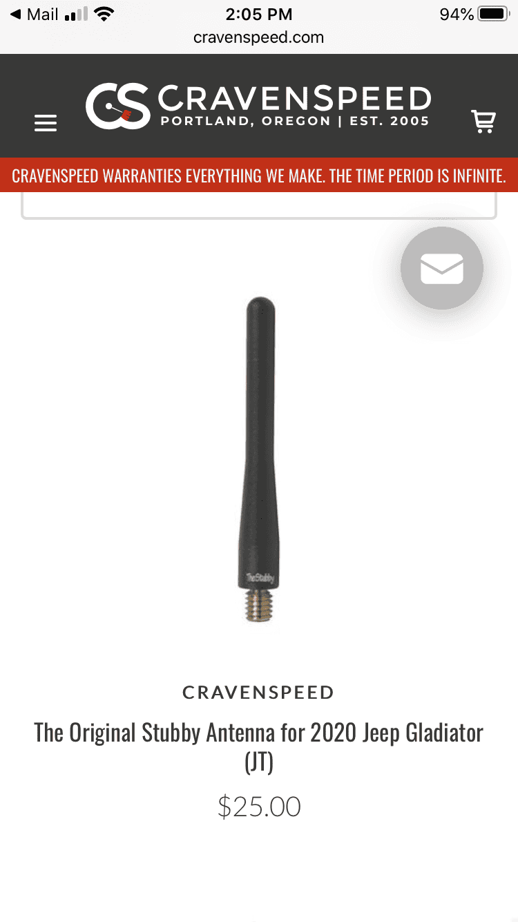

Hey Mark it’s from Craven Speed. See the attached screen shot showing the website and price. Like I said it gets great reception.

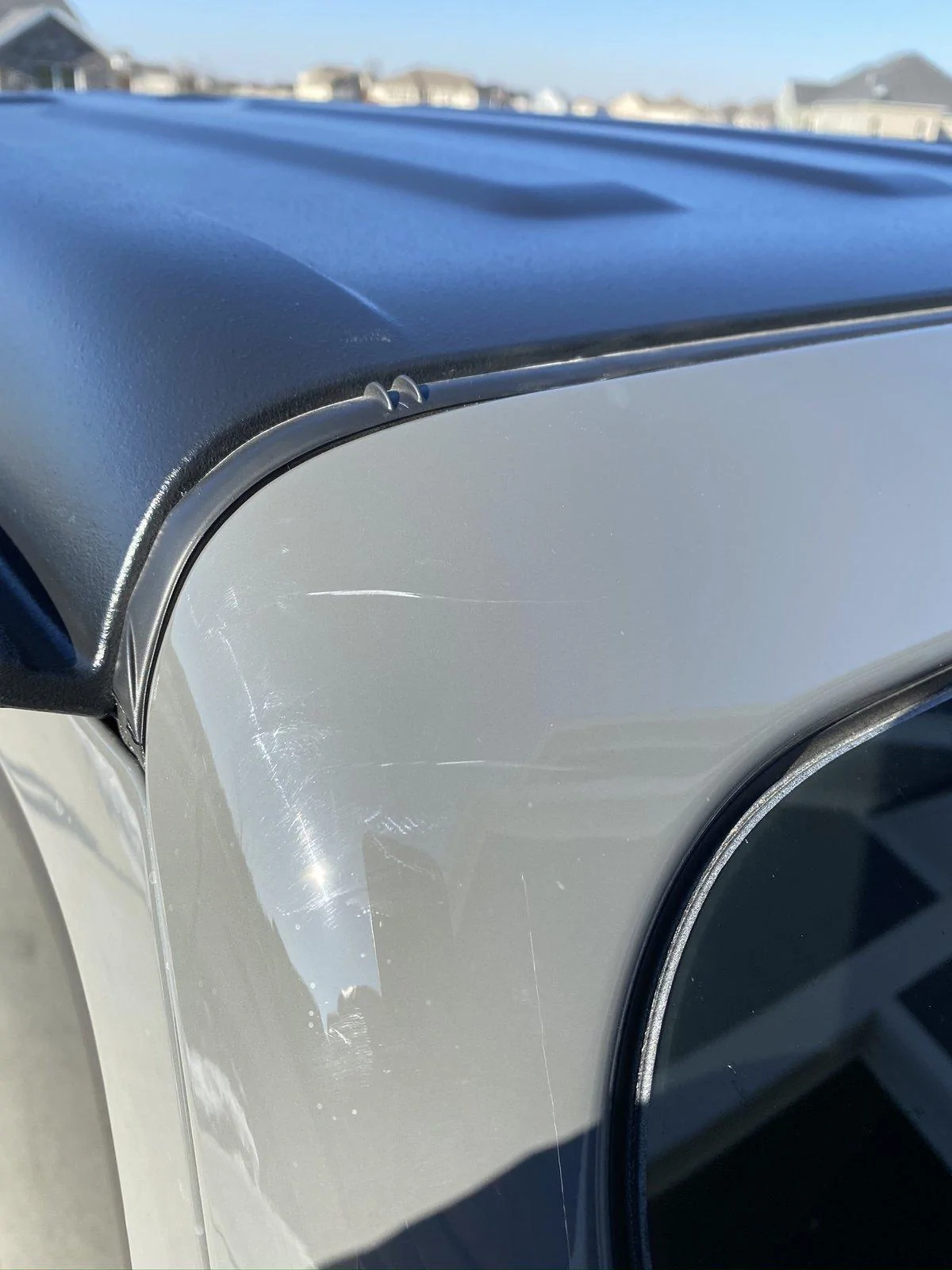

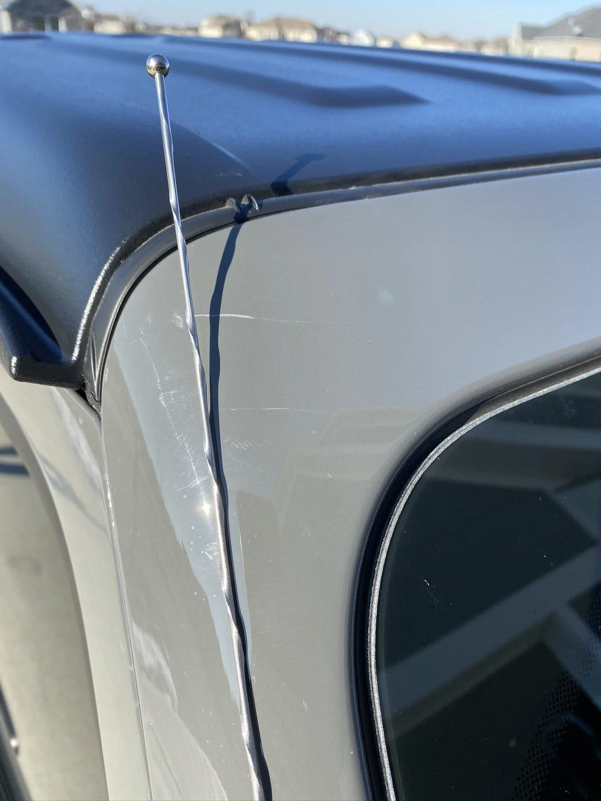

Old school method of protecting antenna and windshield frame - Cover the whip with shrink tubing or rubber door edge protection (c channel) - removable and adds weight to keep it from whipping around - plus is mar resistant.
