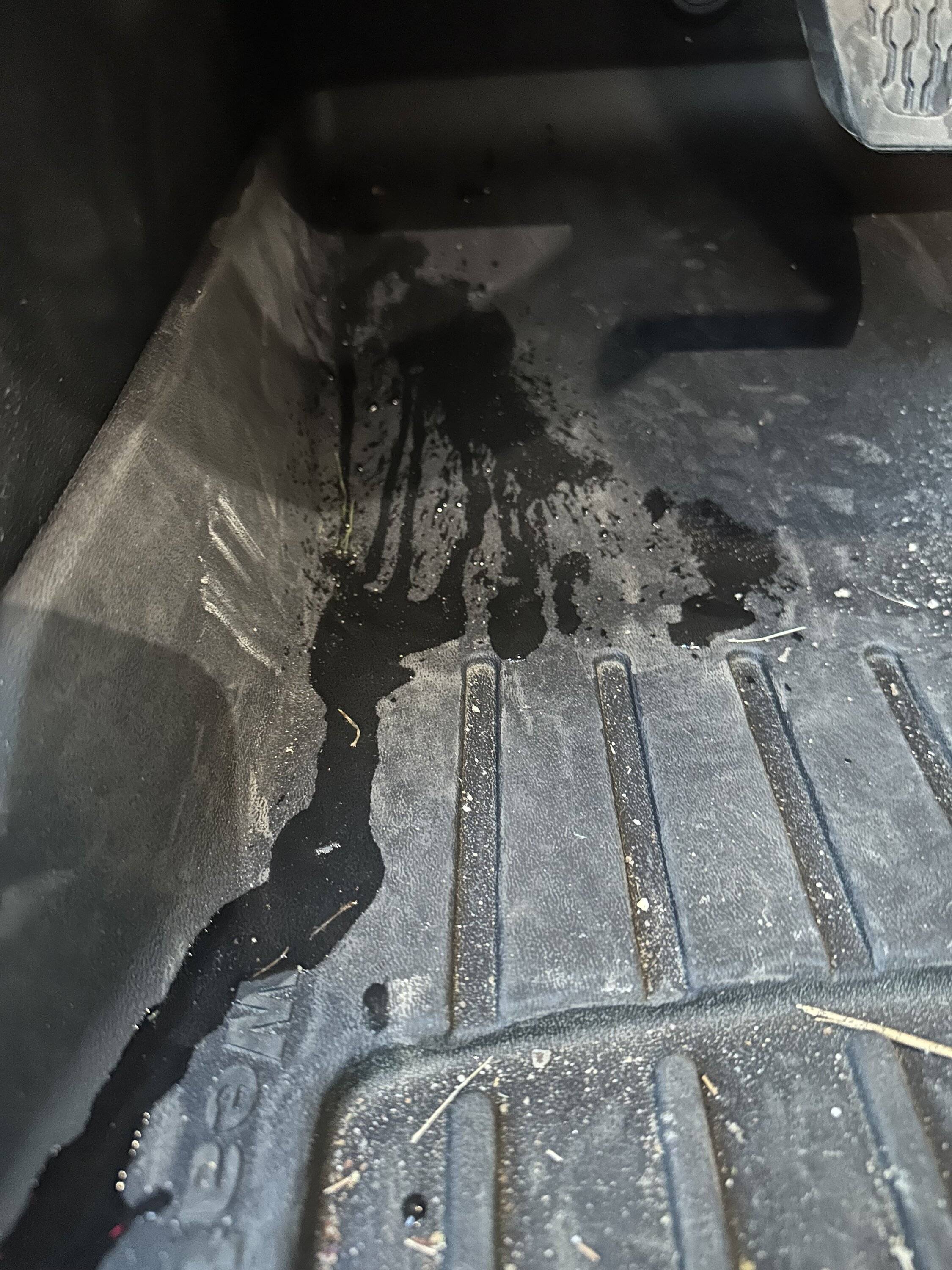

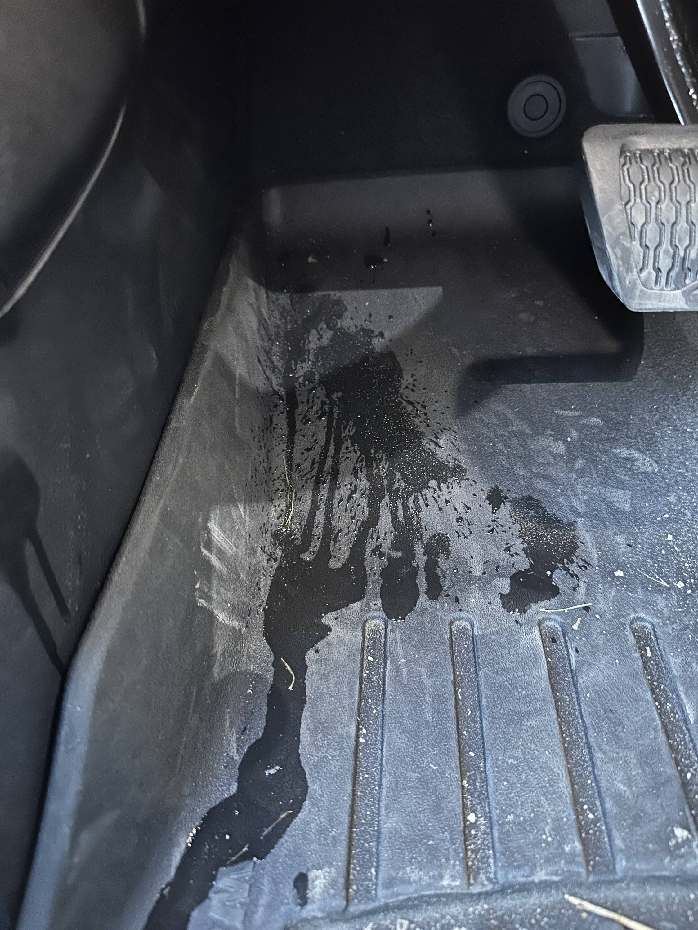

If my knee putting any pressure on the drivers door while going through some water comes in. I have not noticed any because of rain but do during the high pressure section of a car wash. I have had multiple vehicles with a sunroof that leaked worse especially if it was a panoramic sunroof.
I don't see near as much water as you have pictured when I go through a car wash though

Like Al said -
It may be enough pressure directed at the right angle (or wrong angle!?) to displace and distort the rubber weatherstrip between door and door frame/opening.
That’s my exact assessment. It always happens in the exact same spot in the car wash when the sprayer is at a 45 degree angle spraying from the back of the vehicle towards the front. It completely pushes through the door seal.
