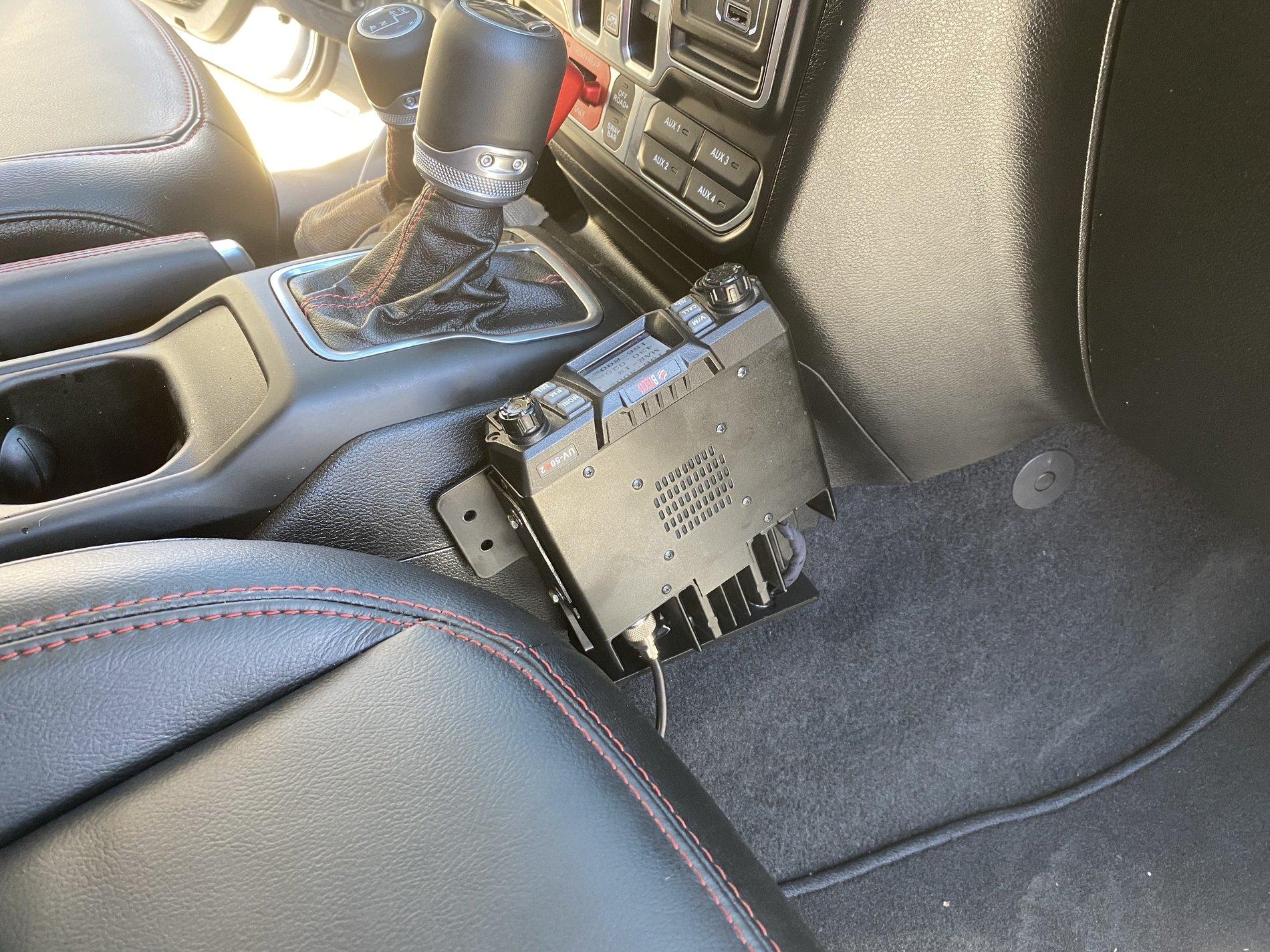

I got my first ham license in 1980, I'm that old, and used it illegally before that. The trail "norm" used to be CB because everyone had it, now it's moving to VHF using business and MURS frequencies, and UHF using FRS/GMRS frequencies. I have them all programmed in my radio so I can join most any group using any of them.
This is illegal, BTW, but nobody is out there looking for people violating type-approvals that are inconsequential. I just switch to low power on those frequencies.
On high power, I'm able to reach repeaters 60+ miles away, so in an emergency, I have a wide number of ways to communicate.

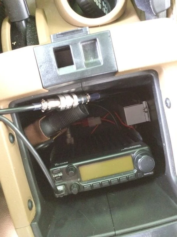

Having a hard time figuring out how to setup a rig in the jeep though. I ride around topless and doorless most of the time so having a way to mount the radio so it is safe from the elements has proven impossible.
Center console might be the best option. Not only is it protected from the elements, but it's also lockable (well it used to be on the JK, come to think of it I never checked on the JT), and the display is still somewhat in view without taking your eyes off the road.
(in the JK) I had an Icom IC-2200 VHF ham rig installed in the console along with a Cobra CB (75 WX ST). Both the ham and the CB rigs had remote control mikes, hung on the dash.
If the jeep was parked doorless/topless, both mikes could be stuffed and locked inside the console alongside the radios.
Just an idea...
PS - if you have a larger CB a great spot is where @SwampNut shows it - on the passenger footwell side of the console. Keeps it from interfering with your driver's side leg area (already cramped) and is still easily readable, controllable, and much easier to mount there compared to the console.
