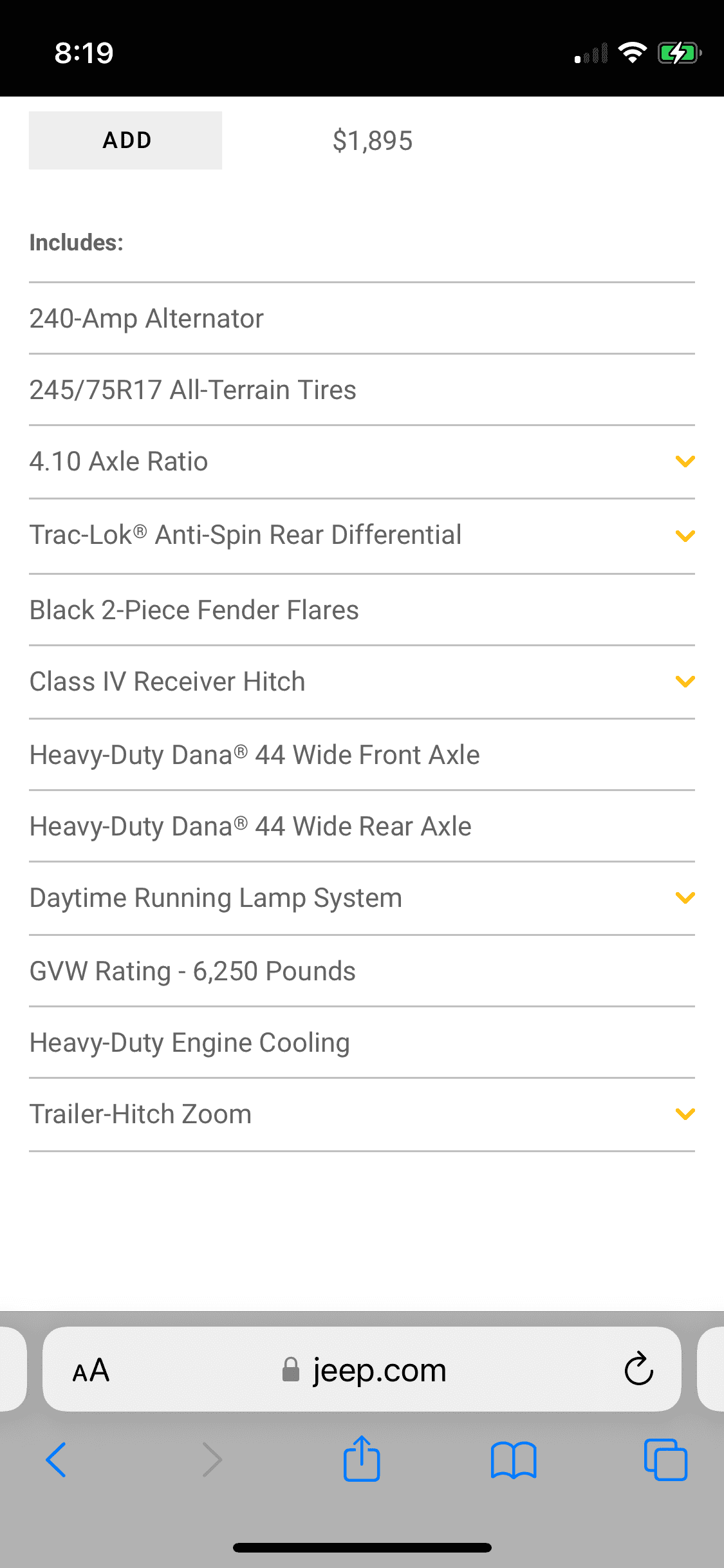

Rubicon, I have the Max tow and got it to use as a truck. I have dirt bikes and 4 wheelers to off-road hard with. The Rubicon has all the parts the Max Tow has, wider axles, more stable with heavy loads, lower gear ratio 4:10’s better towing and going larger tire size is not a problem up to a 37” BFG AT KO (about a 36” tire diameter). Rubicon has the bigger brakes and cooling as does the Max Tow. Plus the Rubicon has front and rear lockers, 4:1 transfer case and sway bar disconnect the Max Tow does not have.
So, towing 6,000 pounds with the 8 speed automatic and 4:10’s on Rubicon stock 33” tire is no problem. I haven’t had issues towing 7000lbs and 37” tires on stock gearing with my Max Tow.
The overland does not have any of the towing extras a Max Tow or a Rubicon has. I’ve driven thousands of miles with my Max tow and it is smooth as silk on the road. I love it. Can’t imagine the overland is any better and if it is, it’s because of lighter duty spring rates, something you don’t want to tow with.
All gladiators have the same size brakes. These are the only differences with the max tow.
