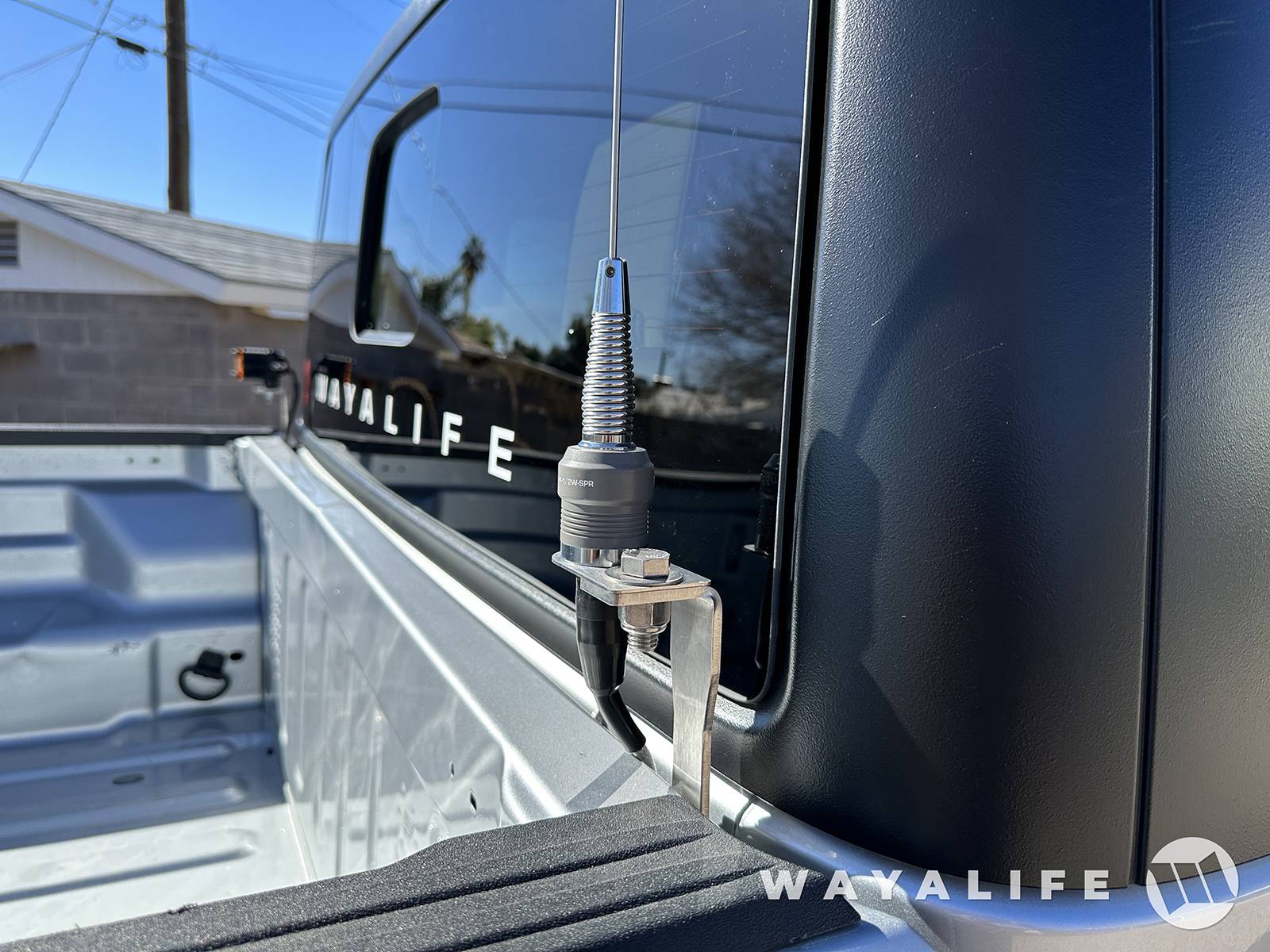

Best mount I've found is the wayoflife bed mount...it's sturdy
It’s not good to have the base of the antenna above the ground plane like that, you take a big hit in efficiency. You will notice a reduction in range compared to having the same antenna mounted on a large flat sheet of metal. BTW I do a lot of antenna testing under conditions like this.

It may not be the best place but it works for me. It's out of the way, I get good reports and my SWR is under 2.

Did you route your cable across the frame and then to the firewall in the engine bay? I am thinking this would work best for me. I think I read that you should not ziptie but use clips. How did you do it?
I have an NMO mount centered on the same upper bed rail and brought the coax up through an existing grommet under the rear seat. Ty-Raps are fine, just don’t make them too tight where they deform the coax.

Sorry for resurrecting a thread that's over a year old, but I have one of these brackets with a Midland ghost antenna. It seems to pick up weather stations pretty well, but there isn't much GMRS traffic around here, otherwise.
I recently bought an SWR meter, and my SWR was over 3. I know the ghost antenna isn't great, but I didn't expect the SWR to be so high. I ran my cable into the cab using the notch in the tub under the hardtop. The cable doesn't appear to be pinched.
I'm currently using the Aux 4 switch to power my Btech GMRS-20V2, but I may try a different power source to see if that has any effect.
Would an aluminum tonneau cover have any effect on the signal?
