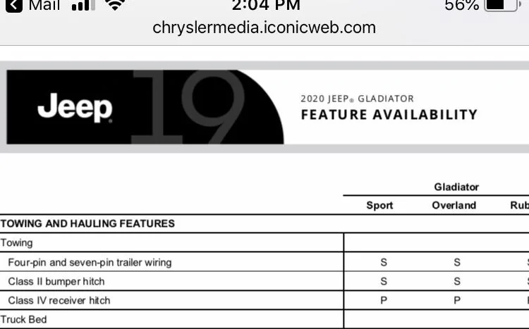

After taking another look at the feature availability sheet and after looking at the build site for all models I think it’s fairly safe to bet that they may have a totally different bumper for trucks that don’t get the $800 tow option from the factory and that bumper just has a hole in it to put a ball into it. After all in this feature availability sheet they call it a “receiver” hitch that’s part of a “P” for “package” and they call it a standard “bumper” hitch. And check out the video “A Closer Look” in which Mark Allen from Jeep refers to one particular bumper as a “composite bumper” that comes with just one rear tow hook. So they obviously have different rear bumpers. We probably will not see one of these bumpers until they arrive at dealerships without the $800 factory receiver hitch as every Gladiator shown so far has been Overland or Rubicons all equipped with a receiver hitch under the bumper. They really are not showing off Sport and Sport S models or any trucks without a receiver hitch.

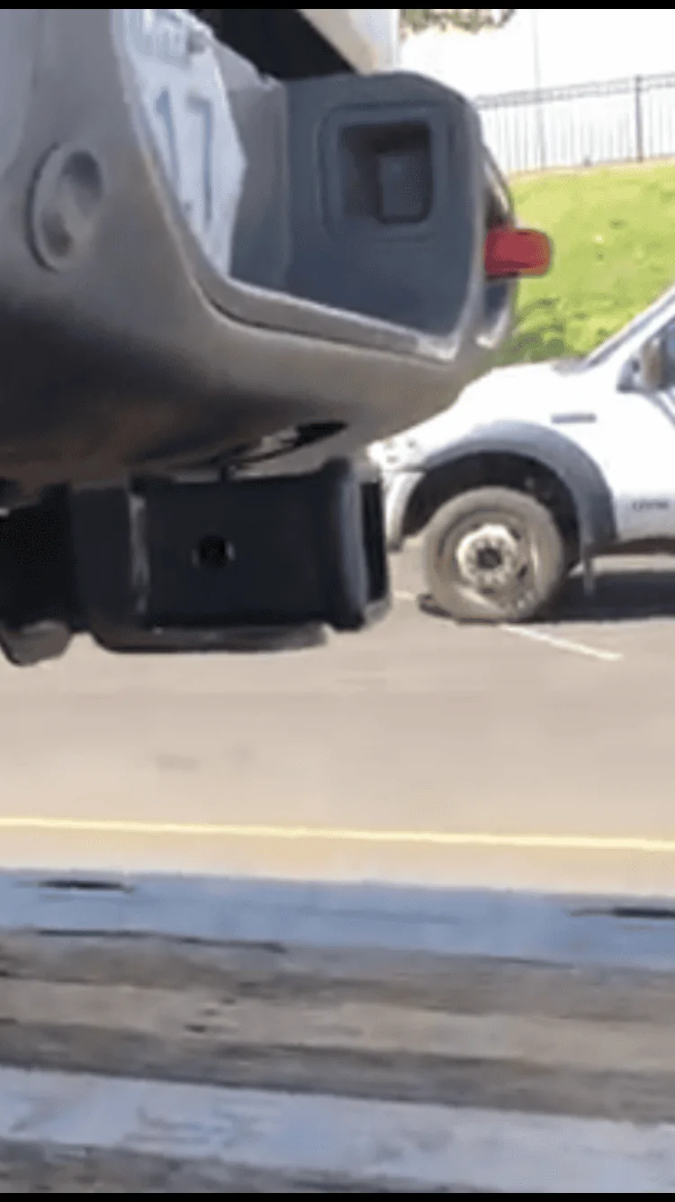

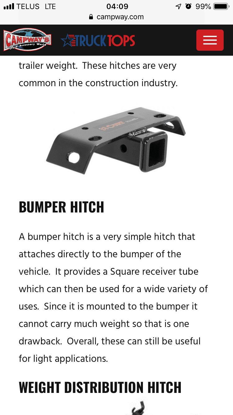

Years ago I once owned a Ford Expedition. And it came with a bumper hitch. Needed a much big hitch so I put an under the bumper class IV receiver hitch on it with a 2” ball. I also put a smaller 1 and 7/8” ball on the bumper itself for when I towed a smaller trailer. The white Expedition shown has a bumper hitch and a receiver hitch below that. The blue Ford Explorer shown has a bumper hitch hole covered with a plug and has a receiver hitch below the bumper. The Gladiator shown has a factory receiver hitch below the bumper and has the 4 pin and 7 pin wiring in the bumper.
When you get a Gladiator without the $800 tow package (with a receiver below the bumper) then I think you will get a similar looking bumper as with the Ford with just a hole in the bumper and the 4 and 7 pin wiring. Then go to a local hitch company and get them to put on a class III or IV hitch(will not get you the max towing capacity as with the $800 factory tow package but will save you about $600).
And once you have done this I do not think that you will then also be able to put another hitch through the bumper hole as there’s just not enough room between under the bumper and the top of the receiver hitch for the shank and nut to the hitch ball as shown in the Gobi bumper.
But hey it’s nice that it will come with a hole in the bumper for a ball plus the wiring. Wiring alone would cost you about $200

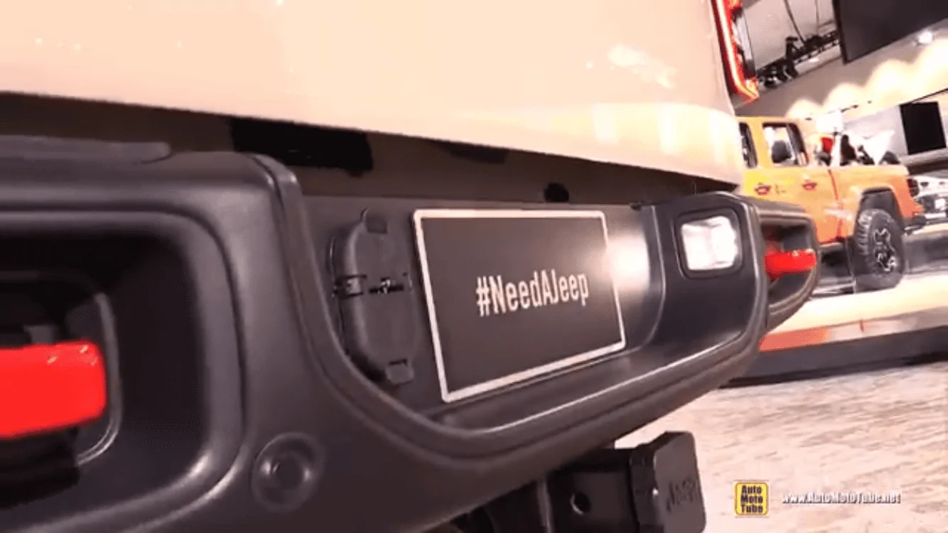

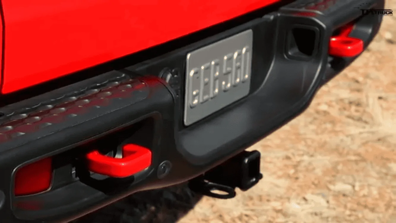

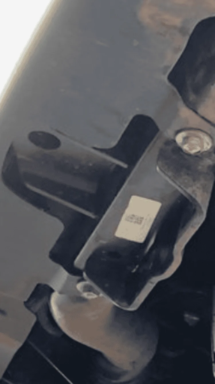

After seeing the new video posted by Wizzard005 I feel fairly certain that the Class II hitch that Jeep will offer will be nothing more than a hole in the bumper to drop a trailer hitch ball into. See the attached pictures. Notice the little cut out in the bottom of the bumper cover, just below the hitch. Ya gotta wonder what that cut out is there for. And inside that cut out area you will see a round hole. What could that be for? I think that hole is there to drop a hitch ball through. And there is plenty of room there for the large nut. And take a look at the top area of the bumper that I circled. I think that they just have a different center top section that has a hole in it for trucks equipped with the class II hitch. And they use the same remaining bumper shell cover for most all other Gladiator bumpers. I may be wrong here but the 2 plus 2 seems to equal 4 here to my logic. Like I said before either way is ok with me as I will haul a small trailer. Just thought y’all might be interested in my theory. We shall see if we can ever get a look at the top center of a Gladiator bumper that does not have a under the bumper hitch. There were no shots of that in the video that Wizzard005 posted.

All the photos I have seen seem to be bumper hitches and not the class 4 Hitch. I think the key to the class 4 is it connects to the frame in multipol locations to balance out the tow weight.

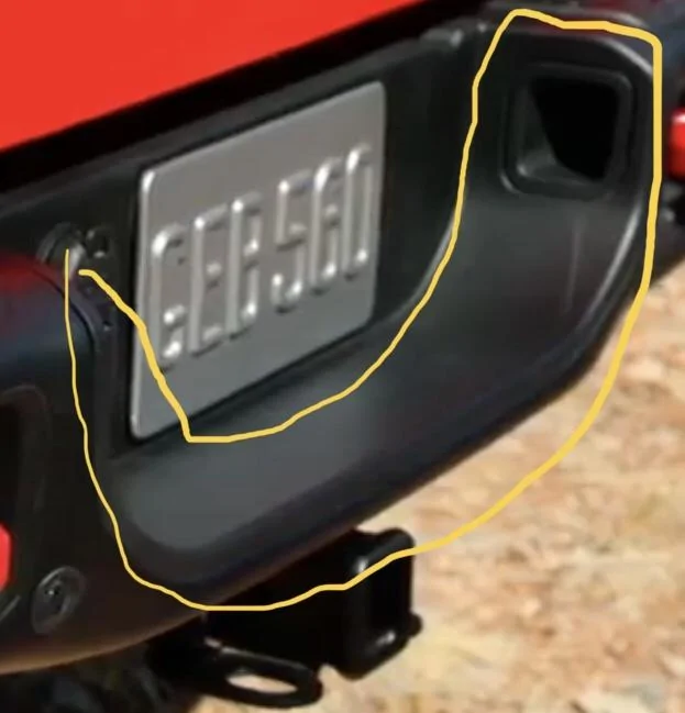

NAILED IT!! my thought as well.... all the bumpers are the same (Except composite/steel cover differences per model) in that they ALL have a hole in the main bumper frame for "class II bumper hitch" ball mount. If you DONT buy tow package you get a plastic step top trim with a hole or punch out in it but if you order the tow package or Max tow, you get a receiver mount and a solid top cover to hide the hole. at least thats what it seems like to me and makes sense from a manufacturing perspective.
homerun
Oct 30, 2017
990
1,205
Fort Collins, Colorado
1996 XJ, 2004 Ford Ranger, 2013 Subaru Impreza, 1996 HD Springer Softtail, past jeep 1995 YJ

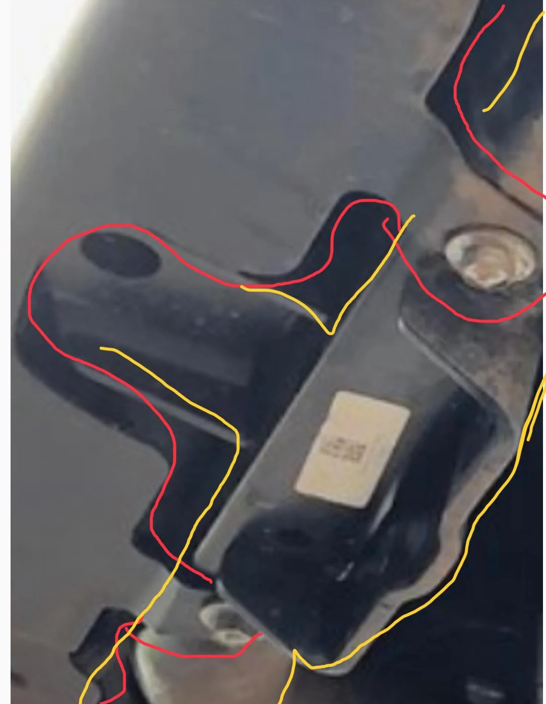

Ok it is hard to see here, but just like the plywood I think you guys are all upset about nothing. I can’t tell 100% from the pics but I really think the bolts you think hold the reciever are actually just holding the black trim piece over the bummer.
Follow the lines in the picture, the trim (outlined in red) is held on with the small bolts, the reciever is the yellow and mounted to the frame outside of the picture, I think a good part of the reciever is hide by the trim and also outside of the picture frame.
