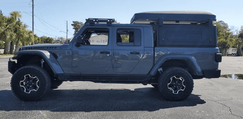

First, the shop has called Clayton and I'm talking to James with Clayton on this forum. I thought I'd see if anyone has experienced this or if anyone has any feedback. I swapped the 2" Mopar lift for the Clayton 2.5" Overland Diesel lift (plus control arms, stabilizer, RPM Steering). These measurements were done on both lifts with the RTT and canopy installed (300#). The fender well measurement on the front went up 1.5" (expected) but the rear went down 1/2" inch. Many posts on this lift complain that the front is too low and they add a spacer. I have the opposite problem. I had a nice positive rake with the Mopar lift. Now it squats.
The first comment from the shop and Clayton suggested the HD springs. But that's missing the point. There is only a 300# load AND the Mopar lift had a positive rake. Just for grins, I removed the RTT and the measurement did not change. All four springs are the correct stock numbers. Thoughts?

It definitely looks low in the back.
Have the part numbers been confirmed for what you ordered vs received?
If they are the correct parts, I would look at the rear springs from the 3.5" kit.

Something doesn't look right. I had a normal rake even before I put my winch and bumpers on.

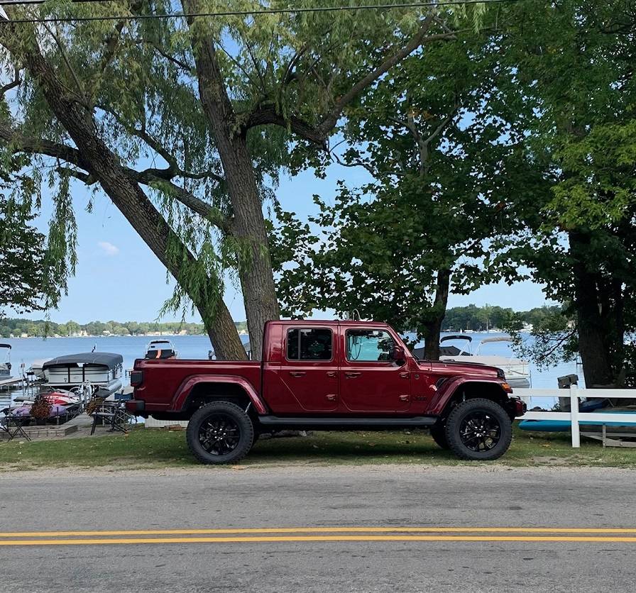

I have a 2.5" Clayton on a gasser/non-Rubi and it doesn't sit low in the back at all. I would also guess it's taller than a Mopar lift in the rear, but I haven't actually measured or parked next to one.

So far I agree with the comments. It "should" have a positive rake. The Mopar lift is a true 2" and the Clayton 2.5 is really 3 - 3.5". The front height increased an expected 1.5" but the rear went down. The springs are the correct ones. I'm going to the shop on Monday to check it out. They need to detach the links and control arms to see if there is a bind somewhere.
