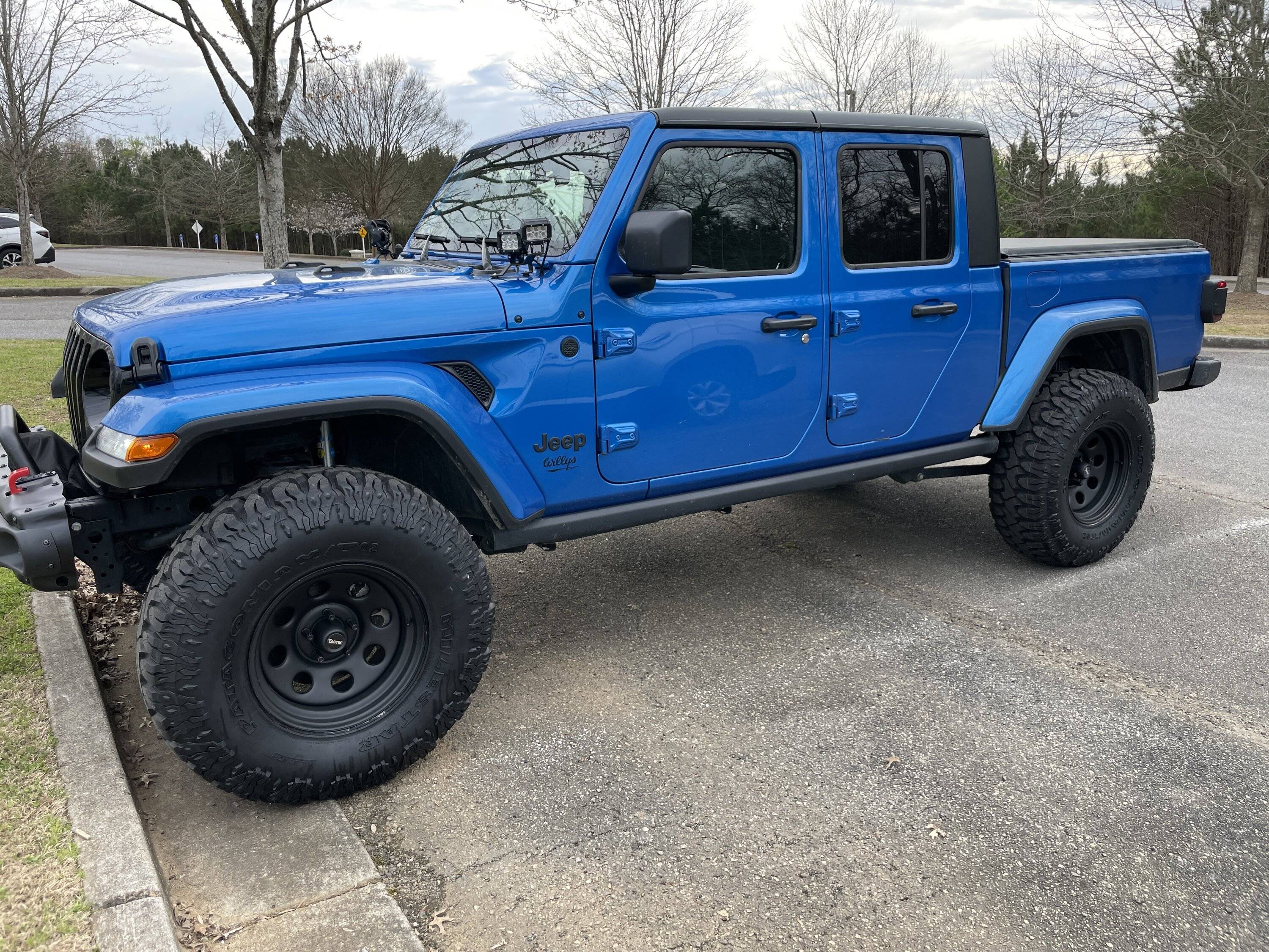

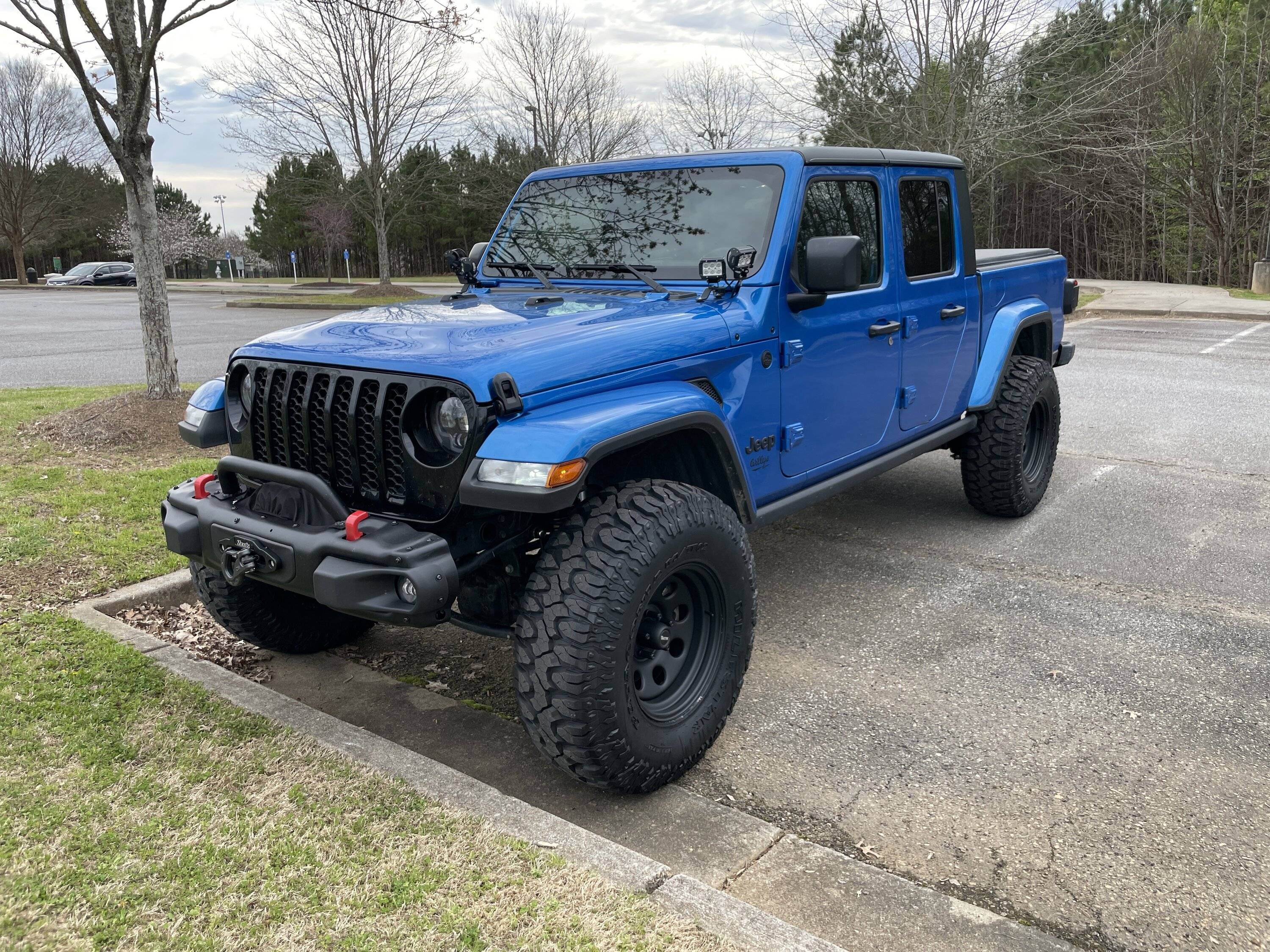

Got my 2.5" ride right installed, with 37 Milestar Patagonia MT02s. Can't reccomend the lift enough, everything oozes quaility and has greatly improved the ride over the stock sport (Willys) springs. Paired the lift with bilstein 5100s and i've been very happy with it.
