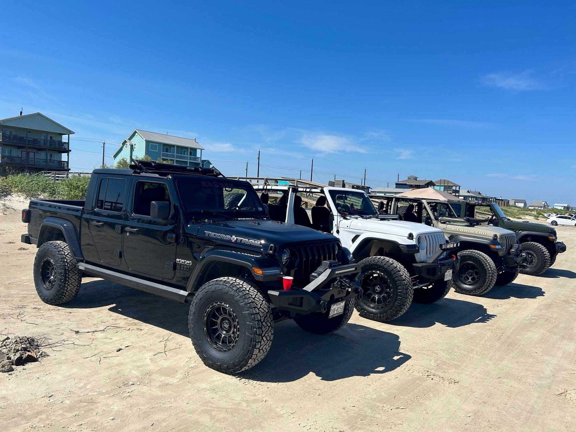

What are my options if I want to run 3.5 Overland + kit that DOES NOT have the front end rake? I don’t want to run a leveling kit and rather have the coils make up for the rake in the front. I have a JTR with stock steel bumpers and a warn winch.
The kit has rake (see pic), which is great if you are "overlanding" with a bed full of gear or towing a trailer. I am wondering if you used the 3.5 front springs and 2.5 rear springs if it would sit level? I got more like 4" front and almost 5" of rear lift empty (keeping in mind I have a full length front bumper and winch, steel rear bumper, skid plates, and AMP steps). Loaded for a trip, it sits quite level.
Hey Don,
Trying to perfectly level any vehicle using only coil springs is such a difficult thing to try and accomplish, as it would be almost impossible to design a one size fits all system that perfectly levels every JT the kit is installed in. There are so many variables like added weight from accessories, different models that weigh more, passenger weight, etc. that all change the amount of rake you're going to have on the vehicle with or without a lift. It also can cause issues for a lot of customers as perfectly leveling out the vehicle means there is no room for passengers or added weight in the bed before the rear starts to sit below the front and the headlights are pointing up into the sky.
Instead, what I always suggest is to get the kit installed that you want to use, measure how much rake is left, and install a small spacer to get you the rest of the way there, or even slightly under so again you have some wiggle room when adding weight. Our kits remove a good bit of the factory rake about an inch or more, and we also use a slightly higher spring rate that is able to withstand weight a lot better than some other options on the market. Also, since our kits are fully adjustable, if you do end up throwing in a small spacer you can still perfectly correct geometry and make any necessary adjustments for the amount of height added, so no need to worry about the spacer throwing off ride quality.
