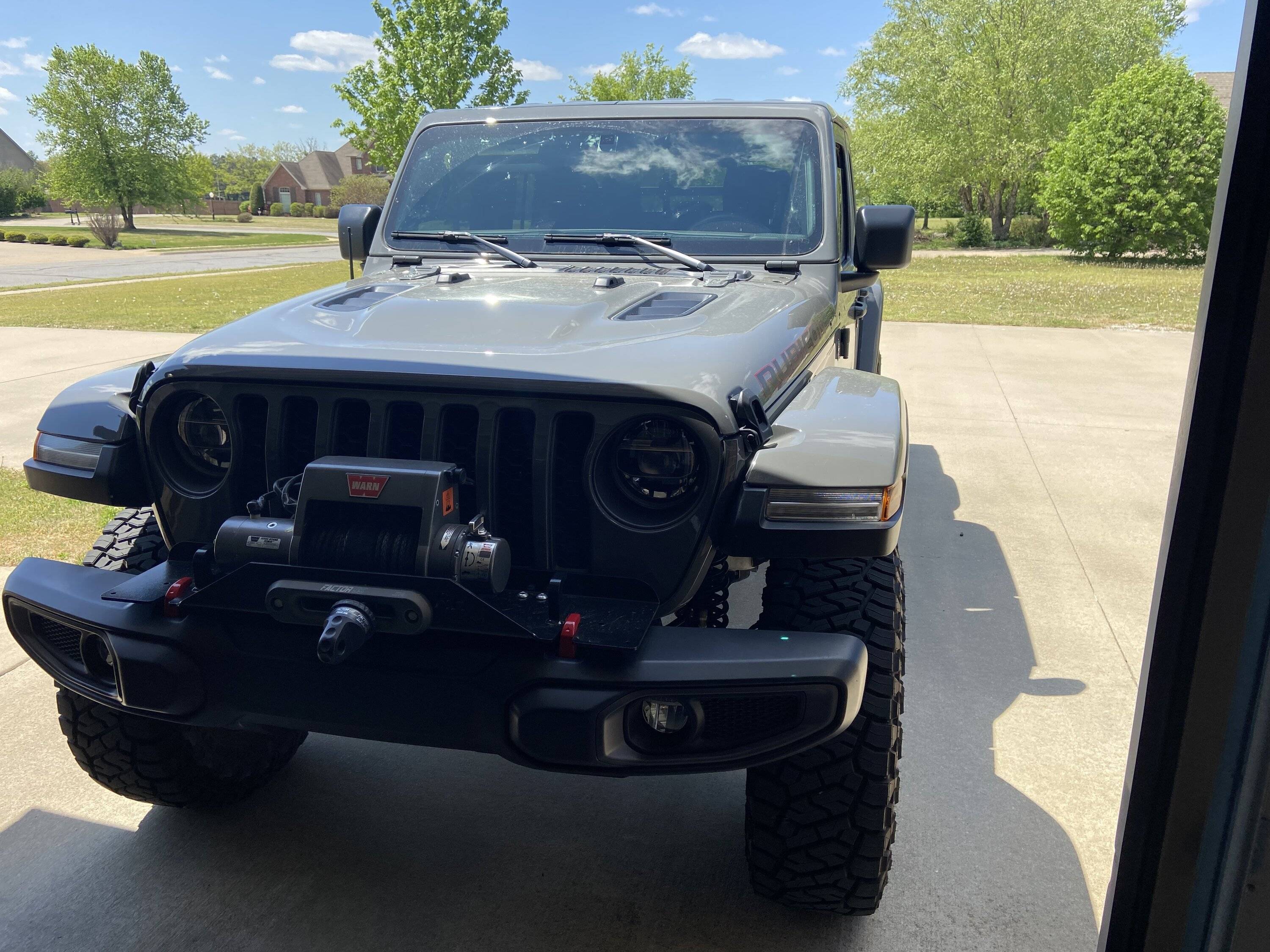

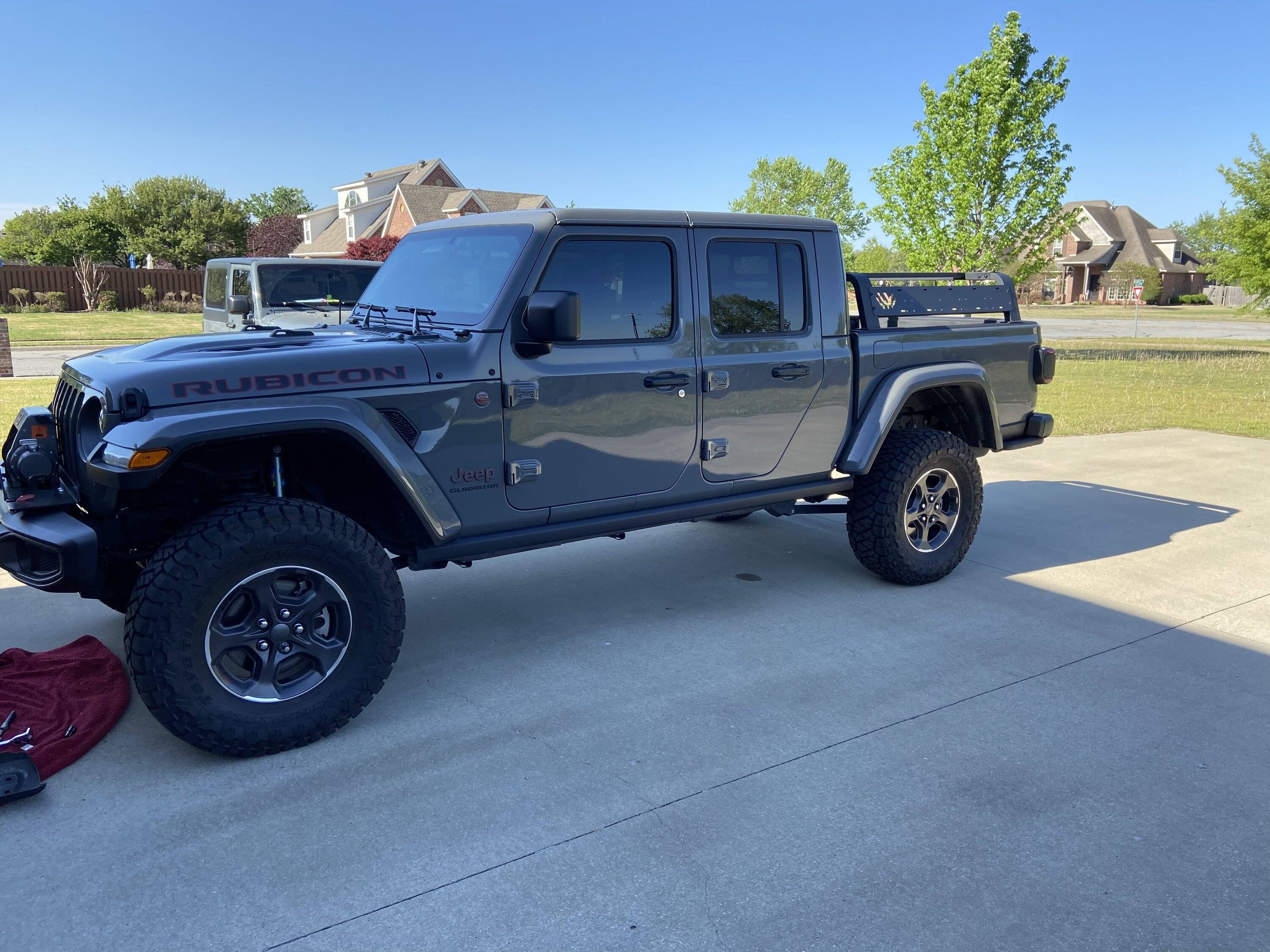

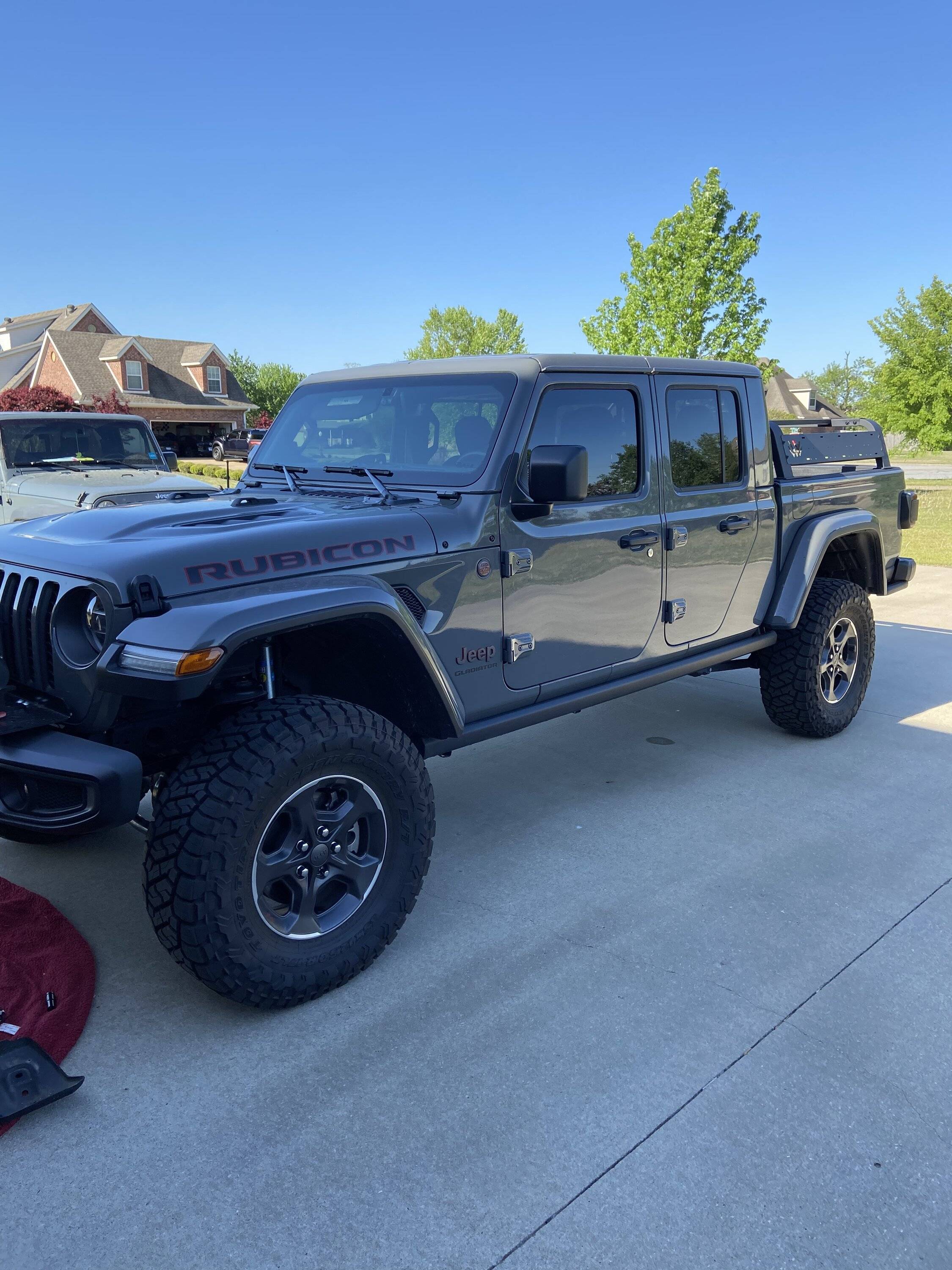

Did the RR 2.5 install yesterday. So sore today I can barely move lol. Rolling on the concrete, torquing control arms, etc…rough but satisfying. Everything worked out well and I took my time to make sure everything was right. I thought squeezing the coils in was going to be the biggest challenge but actually, they went in fairly easy. Turns out, following instructions (loosening control arms, etc) worked out better than when I put on the spacers a few weeks ago without loosening anything. Anyway, looks like a Gladiator should and drives great! Love the fact you get the measurements from Clayton on the arms and track bars so it’s basically bolting parts in. No need for an alignment check…it drives better than it did before the lift.
My only slight complaint are the sway links. Seem overly complicated (cutting, trying to torque with the Allen wrench, etc). I guess the JK spoiled me with puttting the rears up front and buying longer ones for the back.
Measurements show near identical lengths front and back from the ground to the lowest part of the flares. I have the Rubicon, so I know it’s not level which is ideal for me. It has a perfect rake IMO and I am glad I didn’t add a spacer to the front. I just ran with the coils as is.
Overall, very happy and very sore! Total transformation. Now I wish I would have sprang for the 37’s, but the 35’s look great as well. Will complete the control arms eventually.
Some quick pics

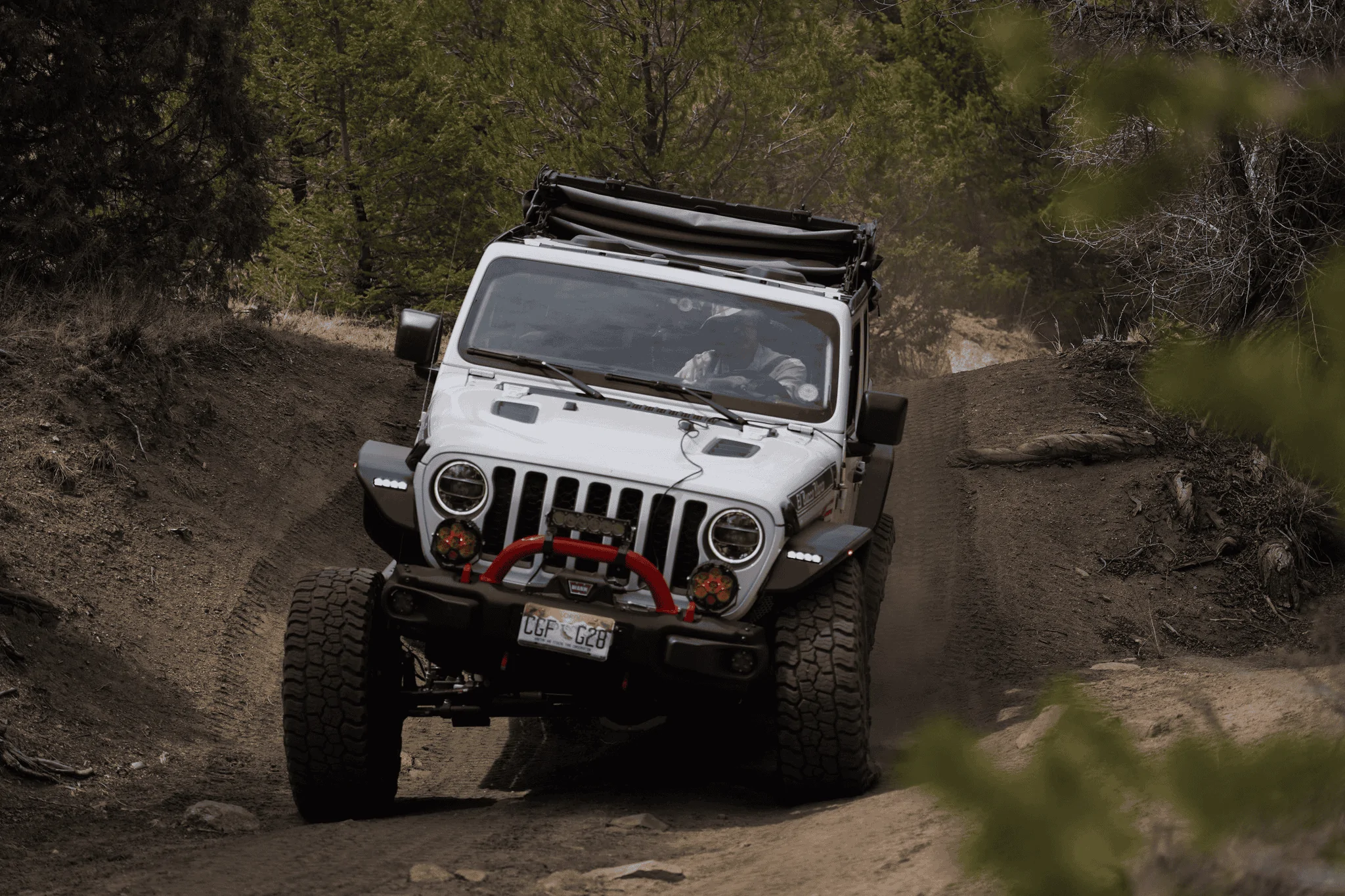

2.5" Clayton Overland Plus on a JTRD on Chinaman Gulch, Buena Vista, CO ? ?
(edit - on level ground, there is 8" between the top of the 37" tire and the Granite Series™ Front Fender Flare. I suspect the flare is doing most of the bump stopping. )

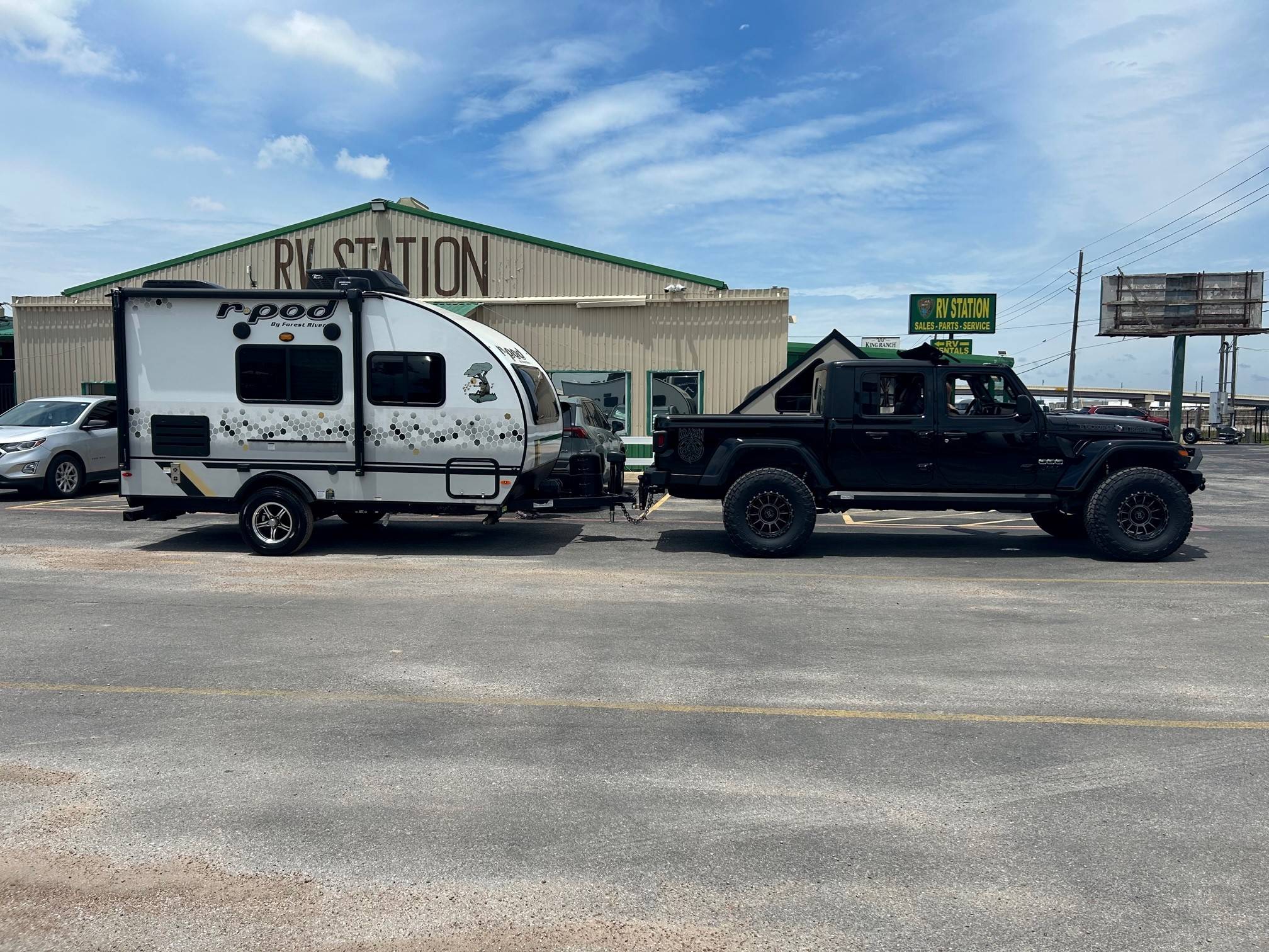

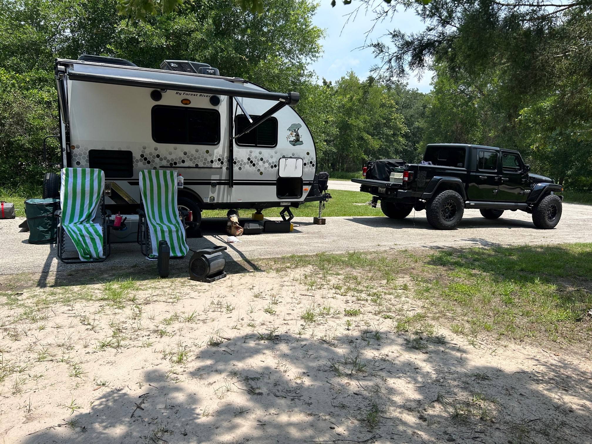

I quick comment: I installed the Clayton 3.5" Overland kit with Fox 2.0s. We did our first "weekend overlanding" trip on the lift and 37s. It consisted of at least 400lbs of gear in the bed and towing a 3,500lb travel trailer with about 400lbs of tongue weight. I have airbags installed from the stock springs and kept them just in case.
I elected not to inflate the air bags to see how the springs and lift would take the load (no weight distribution hitch either). The JT sat level despite all the weight and no air in the bags and towed my trailer with total control. I don't even need the airbags anymore.
It is also impressive how the rear can take so much weight yet ride as good or better than stock.
I am a believer in this kit.
