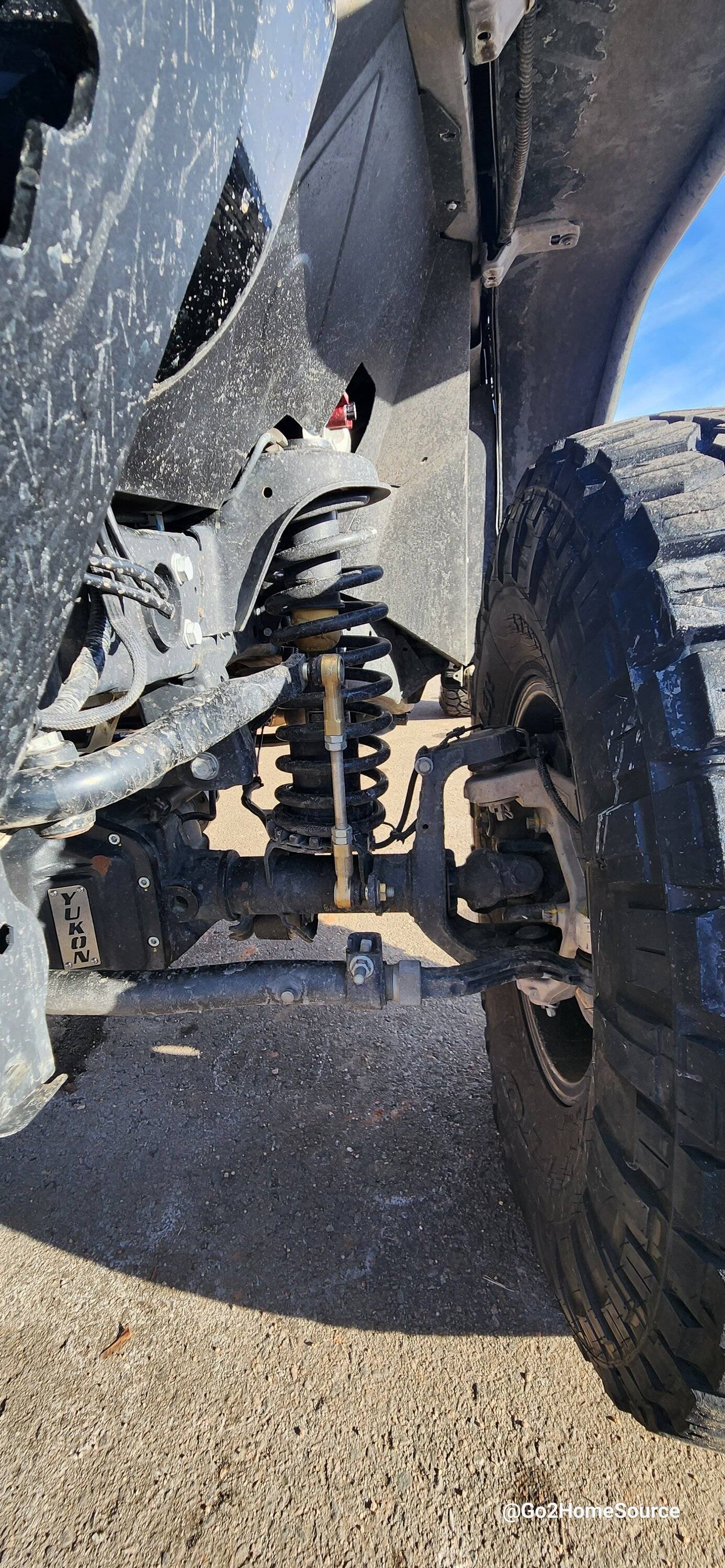

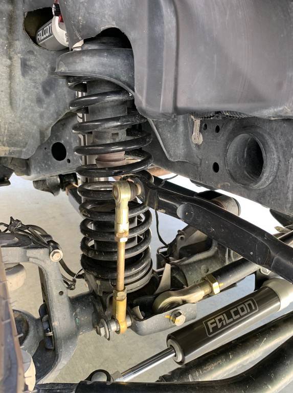

What causes the springs to shift ...is it a problem?

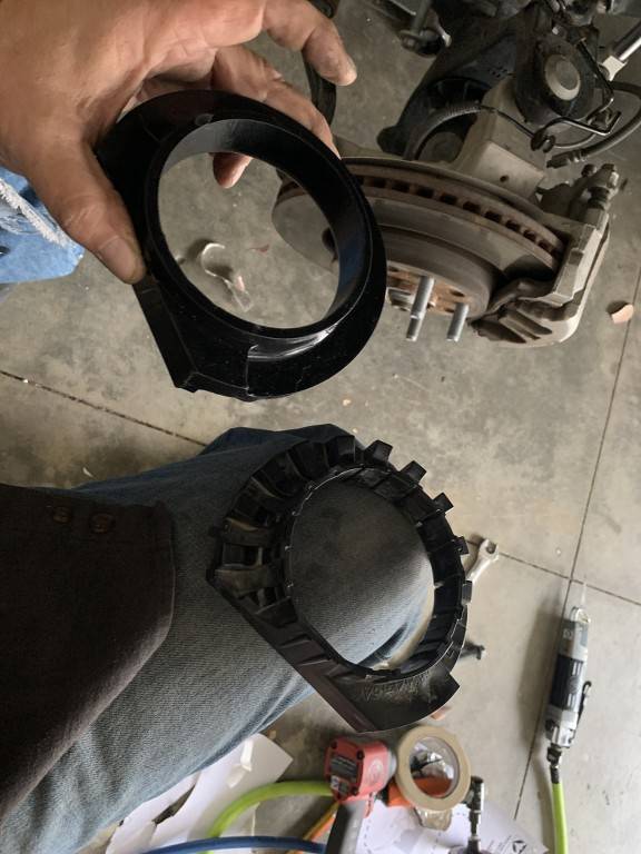

First, take a long straight 2x4 or equivalent and put it against both tires and measure the distance away from your fender. If they are not equal, adjust your track bar so that they are equal on each side. If you still have an issue after that, you can change the stock coil spring isolator which wears out anyway with Rusty's bow spring correction isolators that leans your springs inward to get them straight again. Here is a few pic with the new bow spring coil isolators installed.
Note: I installed Rusty's bow correction isolators when I did my 3.5" Clayton lift kit from day 1. Spring bow in general is a very common look on any of the higher lift kit brands, and the rubber Jeep isolator is not that great, so, I just decided to put them in from the get go.
RUSTY'S JL/JT BOW CORRECTION LOWER COIL SPRING ISOLATORS
