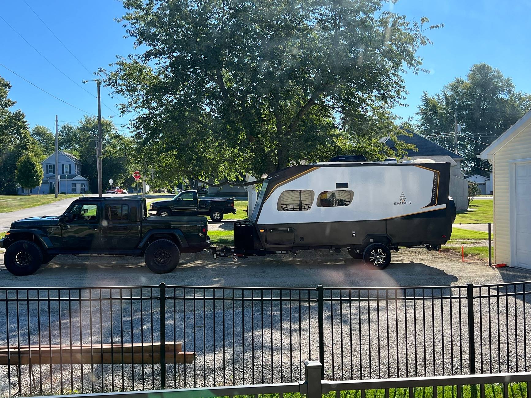

Here is a pic of my 2022 Rubicon with 3.5 inch dual rate springs from Metalcloak. The travel trailer in pic is around 3200 lbs and I have another 400 lbs of stuff on the bed in that pic.
Rides good. Didn’t squat it bad.

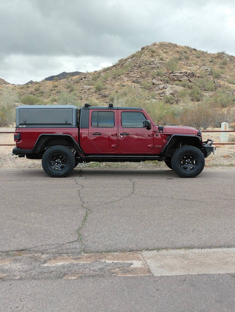

21 Mojave with topper. Running Clayton 2.5 overland with HD rear springs, Pintler rims for the offset, 4.85 gears to fix Jeeps crappy gear ratio, Falken 35's, works for the Arizona trails I run. I've never heard bad about metal cloak, but as previously stated, you need to look at total picture. My build started off by replacing keeps crappy clutch and seriously high ratio gears, continued to accommodate heavy overland load. The larger tires and springs give a comfortable highway ride, haven't altered the shocks yet.
lildev1972
Bryan
Mar 6, 2025
39
Las Vegas NV
2023 Gladiator Rubicon
Why did you go with HD springs, do you carry a lot of weight? Do you sit level or little rake?
GypsyMech
Endel
Jun 30, 2023
46
AZ
MX Tech

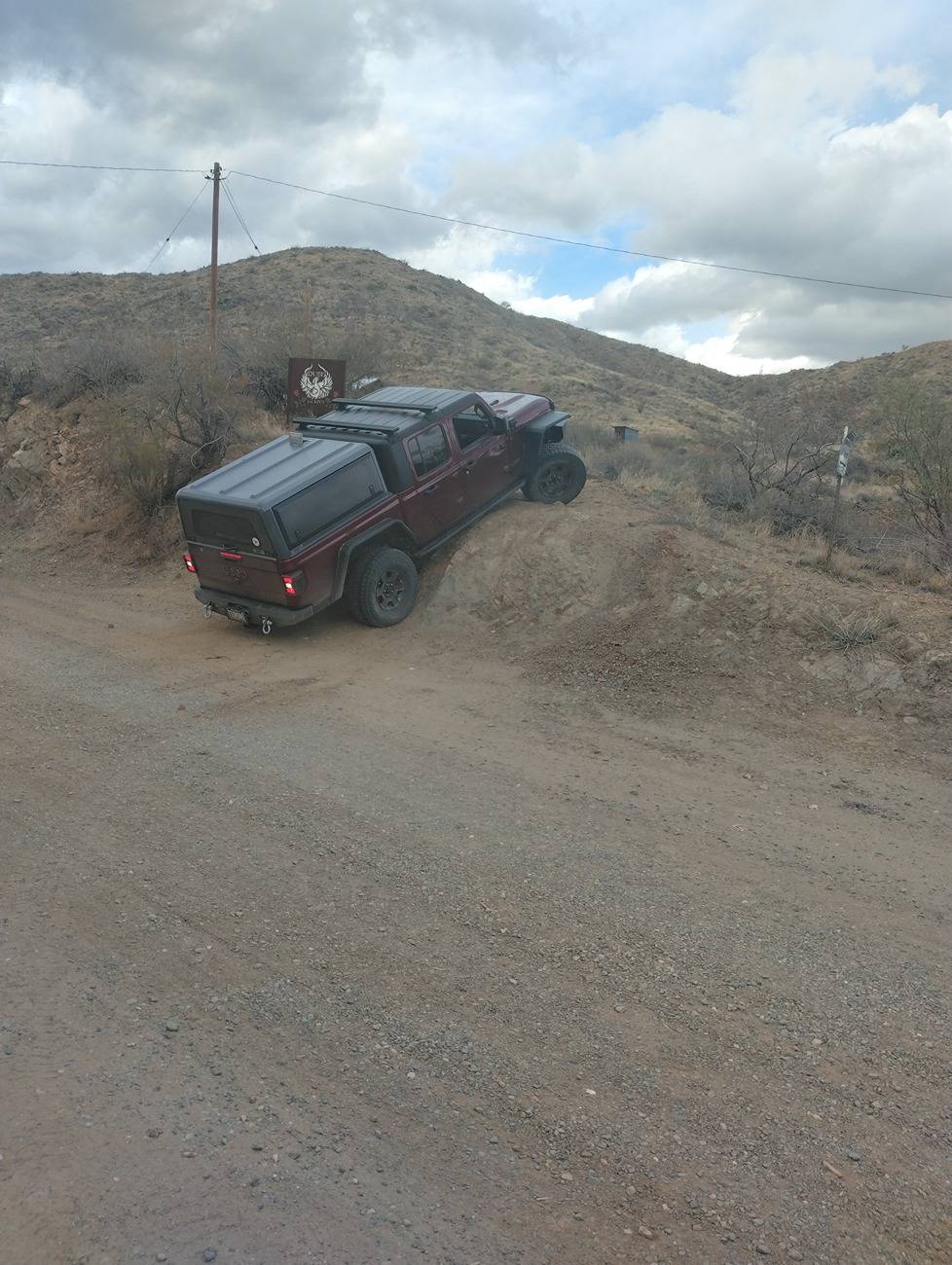

It carries weight, including a rear winch, I still intend to add a tent. The lift and tires made huge difference on clearance, serving pic wasn't possible with stock vehicle no topper.
Jeep Gladiator Clayton Overland Plus vs Metalcloak Gamechanger - with towing IMG_20231223_121800261
Jeep Gladiator Clayton Overland Plus vs Metalcloak Gamechanger - with towing IMG_20240201_151847825
