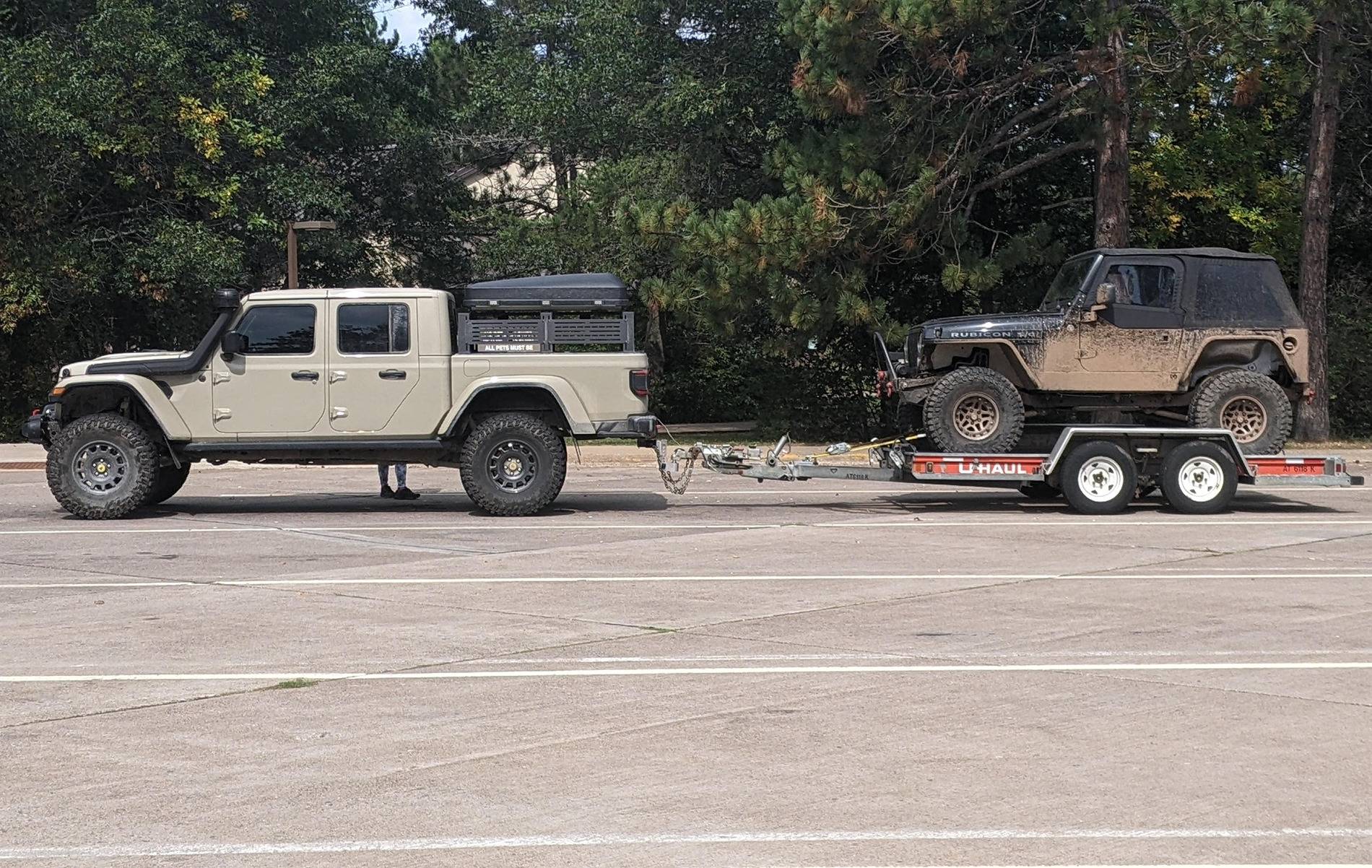

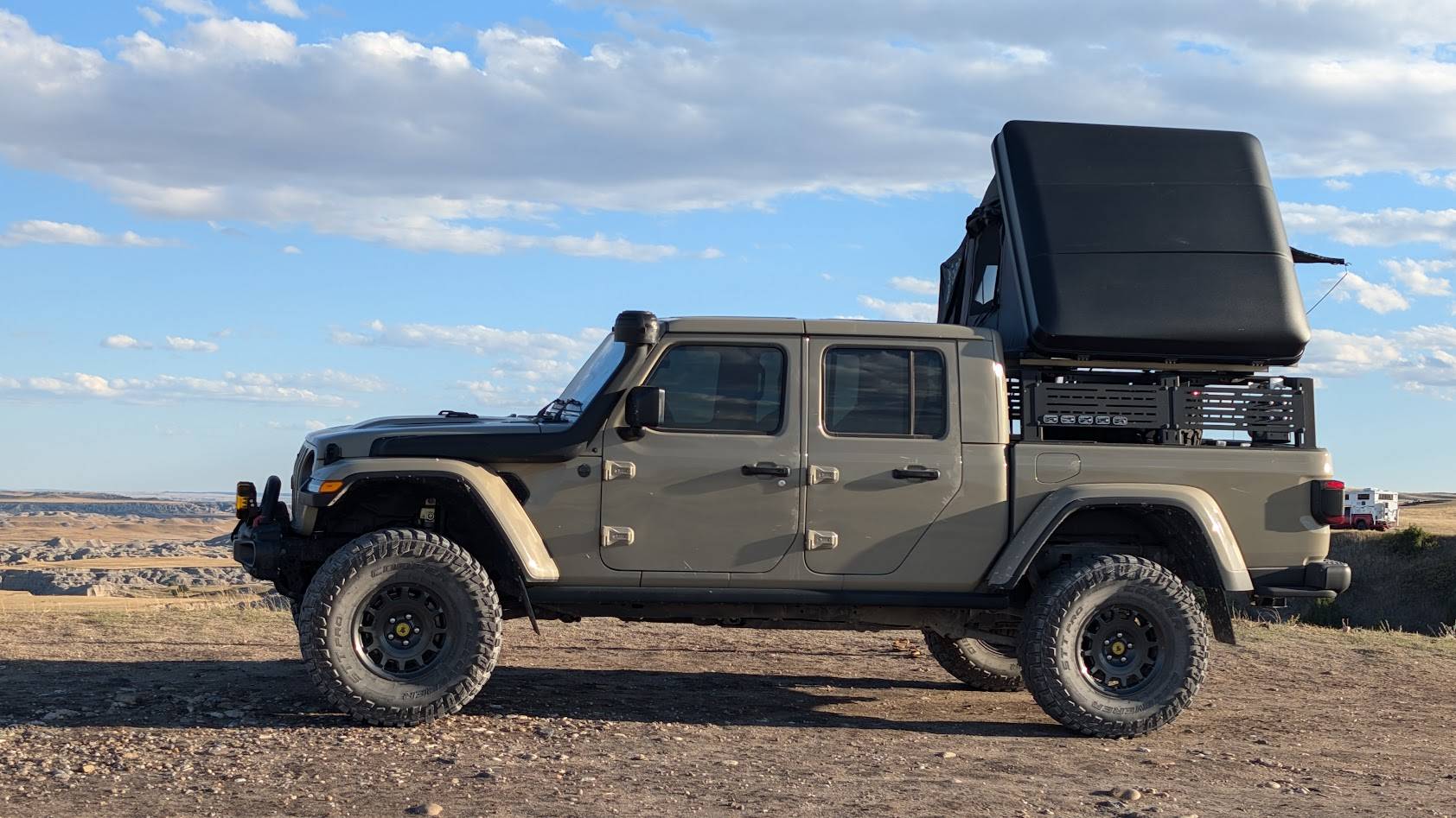

I put together my own lift but I'm using the AEV high capacity diesel specific coils with my ecodiesel Rubicon. With a winch in the front and rebel rack with RTT on the rear I added a 1" spacer to the front and it has a bit of a rake that perfectly levels out when I hook up a trailer or really load the bed up.
Performs great with my TJ behind it.
Empty
Loaded for weekend camp trip
Fully loaded at gcwv
Love this stance… it is exactly how I want mine to sit. My thoughts were HC AEV springs with a spacer. My only concern is if the springs are just too much and ride quality would be rough. Seems like it might be… atleast until I add some additional weight (topper, tent).

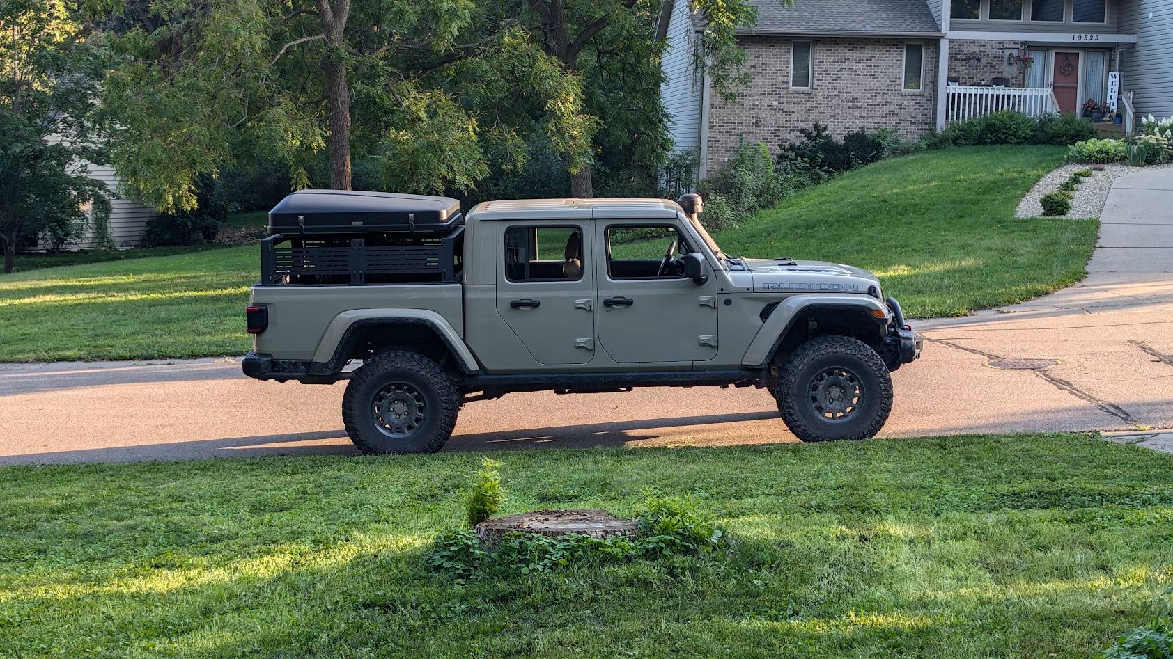

I'm still running the factory fox shocks, I bump stopped and spaced down the shocks so I still maintain factory travel. I've wheeled all over and it's tackled everything just fine. Let's be honest, the limiting factor of the Gladiator wheeling isn't suspension travel so much as the wheelbase and break over angle...
Anyway I wanted to see how the fox shocks would handle the stiffer, higher rate springs. The ride is pretty compliant with the rack and tent on the back. But, I've never driven it without, and I run a full size spare as well. It becomes apparent the shocks are a bit over taxed when I hit big dips in the road at highway speed, they will bounce ounce or twice. Not to say it's uncontrollable, it's absolutely composed. But it has a bit more up and down motion than it probably should and I think that's to do with the shocks just not being equipped to handle the higher capacity springs. In their normal operation of controlling the movement of the axle, they're fine. But when the whole Jeep is subjected to large vertical changes it shows some. But, it's a bounce, not a slam.

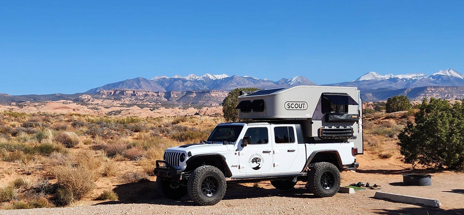

I've had both the Clayton SD 2.5" springs and now the AEV HD springs.
Unless you are running at a minimum 700lb constant load in the rear, I would NOT recommend the HD version of the AEV springs. These springs will give you close to a 2.5" rake front to rear as they are designed to carry a constant load.
I'm now with the AEV HD springs because of the Scout Tuktut camper I am running. The HD springs handle the 850lb constant load with ease and the ride quality is nice.
@darkhorse13 thanks for the above detailed comments about the AEV HC rear coils and comparisons to Clayton and Synergy. Additionally, I was considering Dobinsons and Ironman as they have rear coil springs rated above 1,000#.
The AEV HC coils are rated to 770#, so I was concerned about running them with my AT Summit topper that has a full interior. I’m in the 750-800# range before I add gear or extra water and fuel.
If you are getting good results on these springs carrying a Scout TukTut, then I feel a lot more confident going AEV HC. My guess is with a 2.5” rake and your results AEV’s spring capacity ratings are conservative.

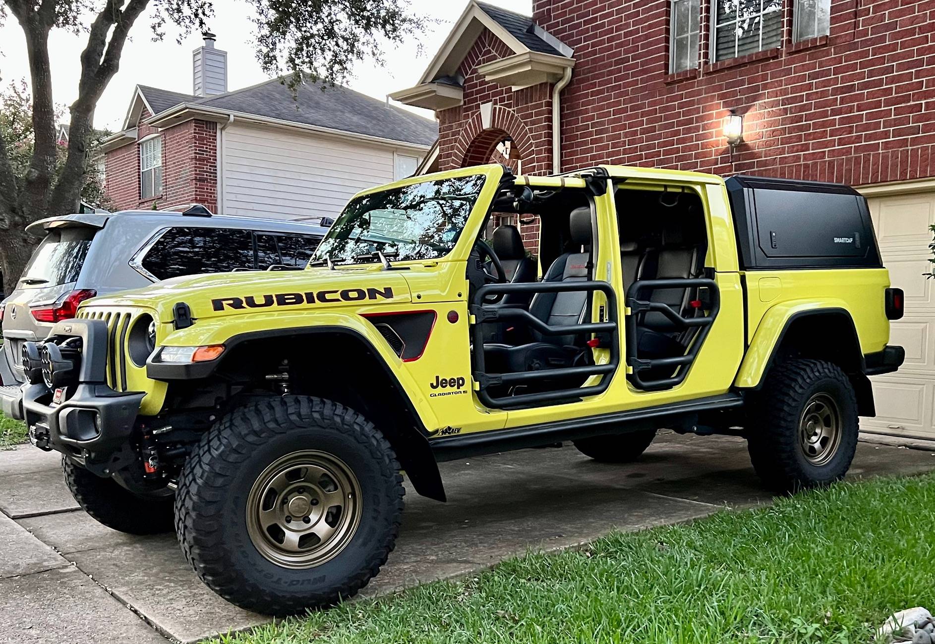

This pic is at camp with over 12 gal of water and bike rack swung out to the side. You can see that the truck is still very much level. If possible, we typically drive to our destination with little to no water and fill up in town or at a gas station prior to hitting dirt in order to keep payload down.
