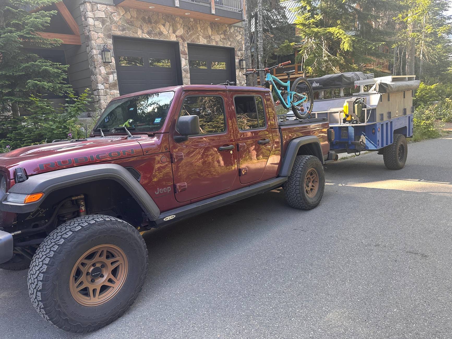

I went with the Clayton 2.5" overland+ kit for my Ecodiesel. It was nice that everything came as one complete package ready to put on.
After reading about people using airbags on other lifts when towing, I decided to get the Clayton lift and HD springs. The ride is great on road and off-road, even better than my dad's stock JTRD suspension. The HD springs do not ride that rough to me, even when I take off my RTT to tow our 4800lb toy hauler (3200lbs empty).
We went to Colorado last year and the Jeep felt great going over all the mountain passes and didn't shake the crap out of us. My son was even able to fall asleep in the back.
The falcon 3.3 shocks are a big part of the comfort too and definitely worth it.
