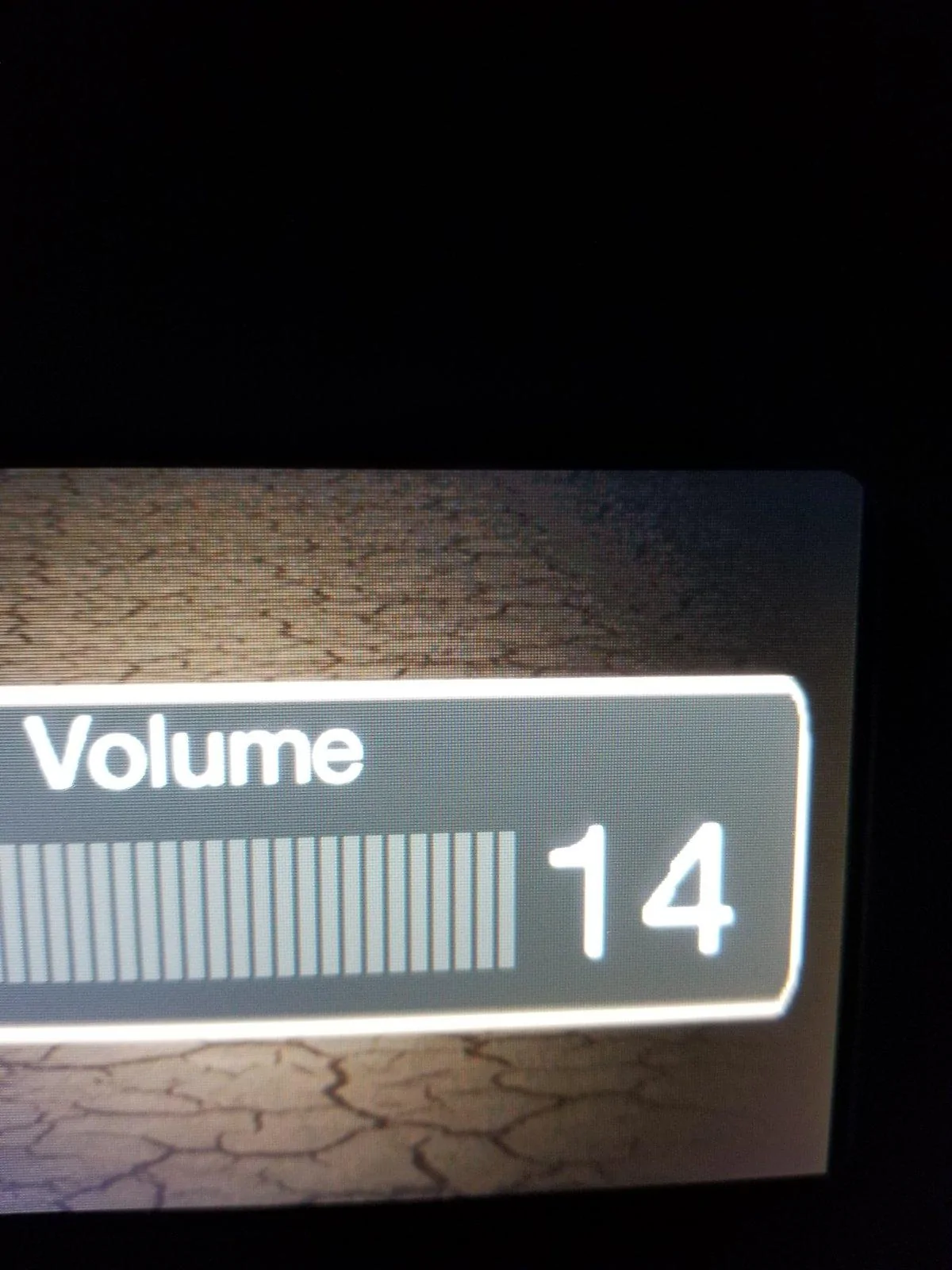

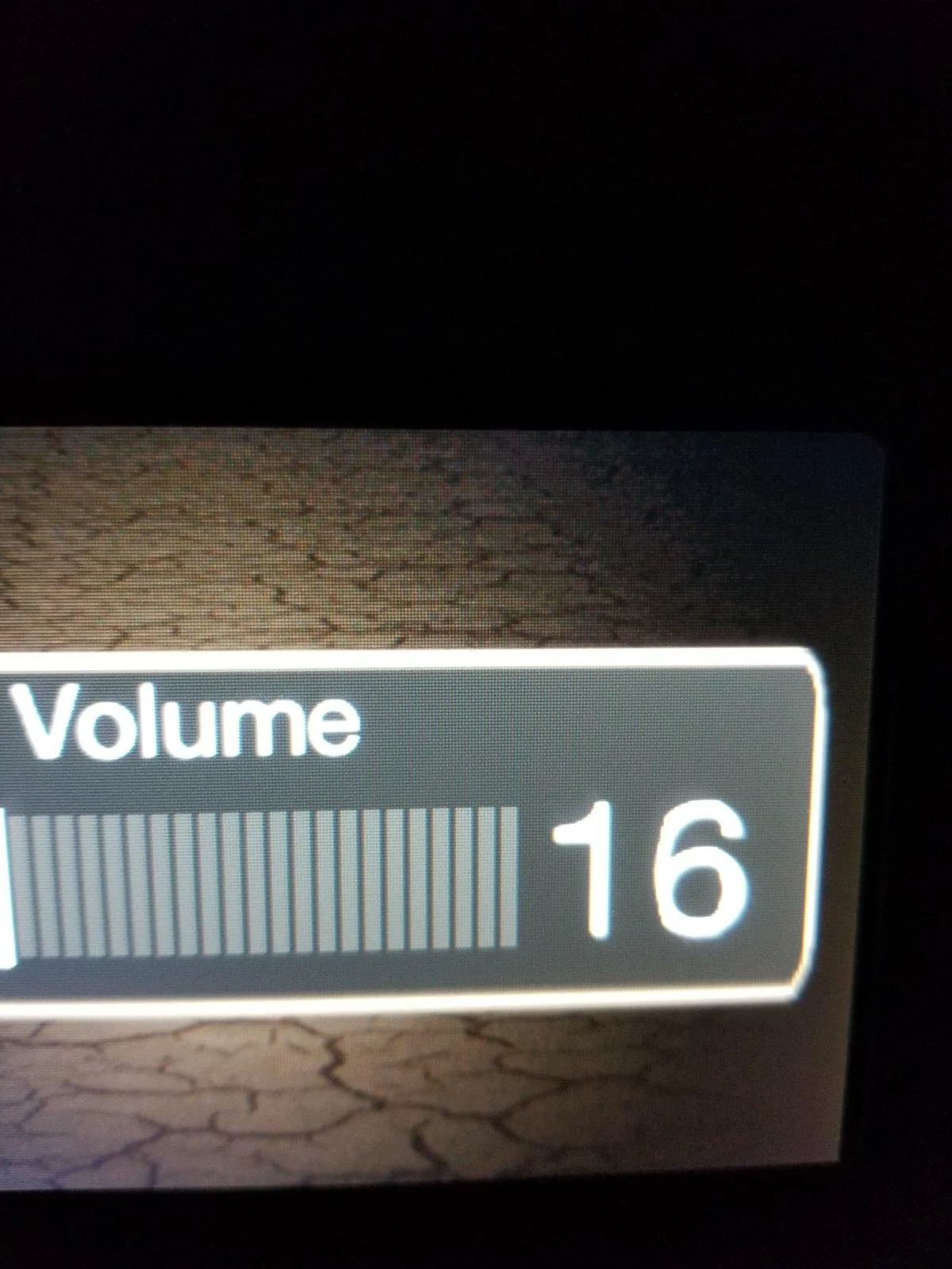

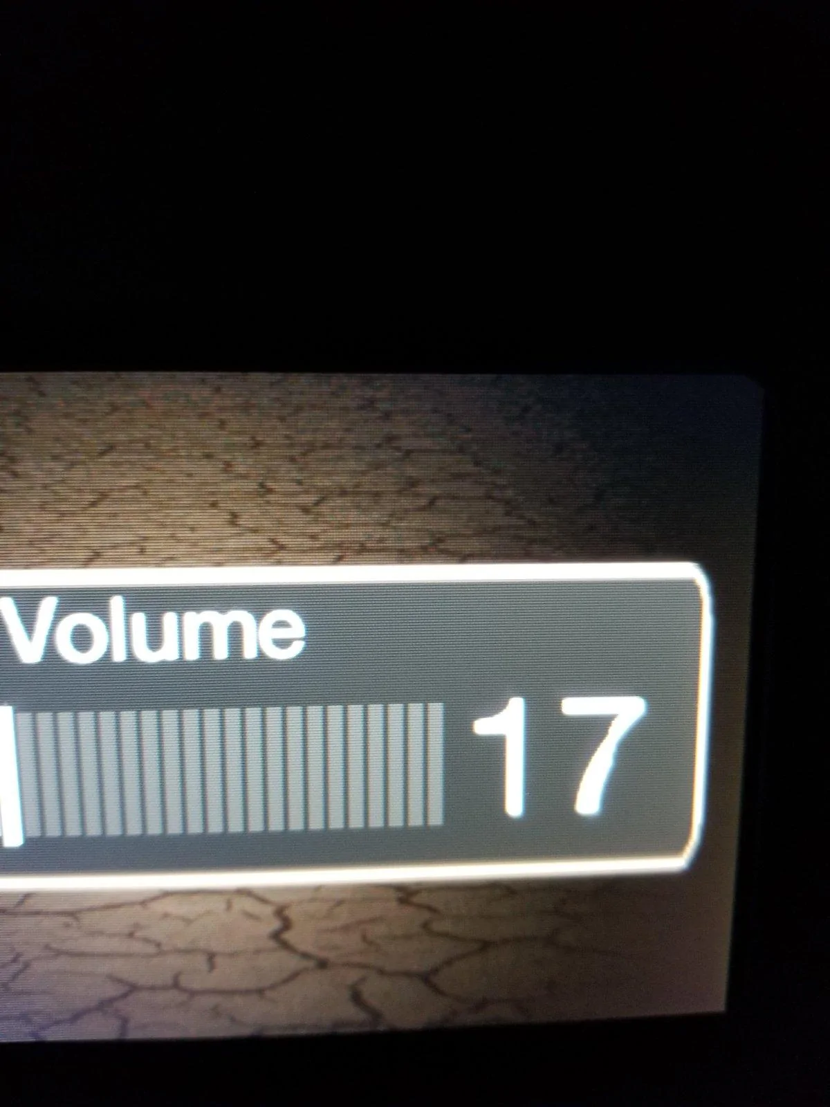

Ok I found the build date " 12-19" and thanks for the offer Jeep cares but I already have a case. My AC has acted up more so hopefully it will do it for the dealership next monday. Also new symptom..the display of volume numbers on the radio screen often seem incompletely formed..dealer tells me the base radio and AC issue aren't connected. ( this is the replacement radio from the prior blacking out ) Hopefully they will do SOMETHING this time repair wise.
