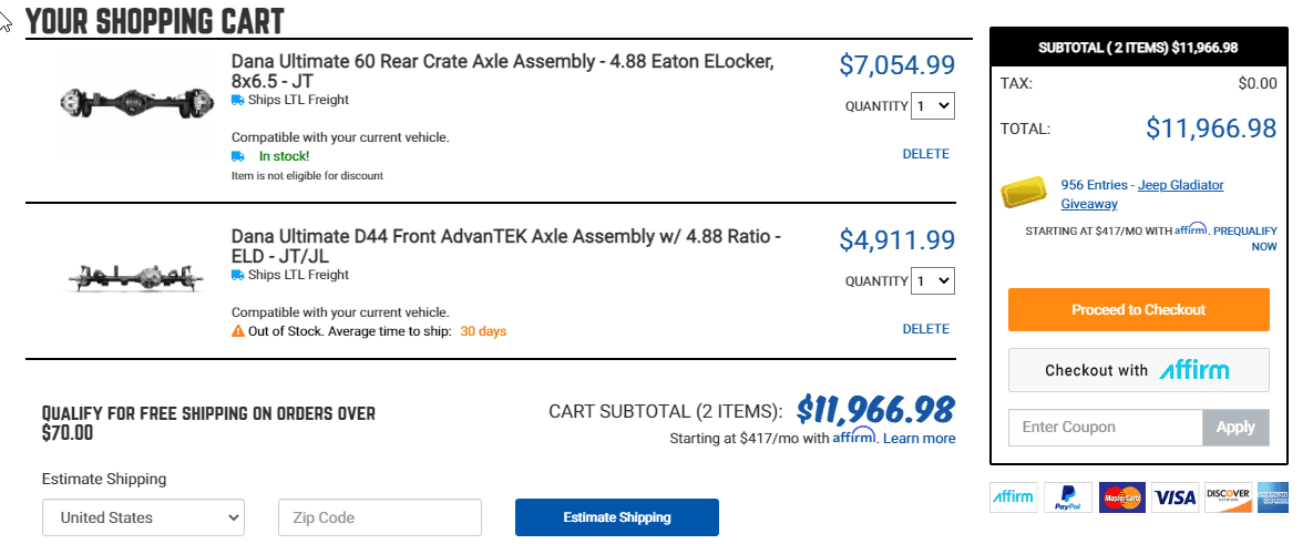

Thats 7k installed vs 20k Dynatrac D60’s
That's why I said "Going Dana UD44 or UD60 is really a better choice for the money "
One is 8 lug one is 5 lug. Don't forget to throw in the cost of new wheels and support parts.
You are correct, that was just an example. I chose the front D44 because a front 60 is a little more work to run due to lift etc. I would not buy those together.
Point being, there are more than one way to skin a cat. Not knocking your approach, and it will be solid with 35 splines for sure.

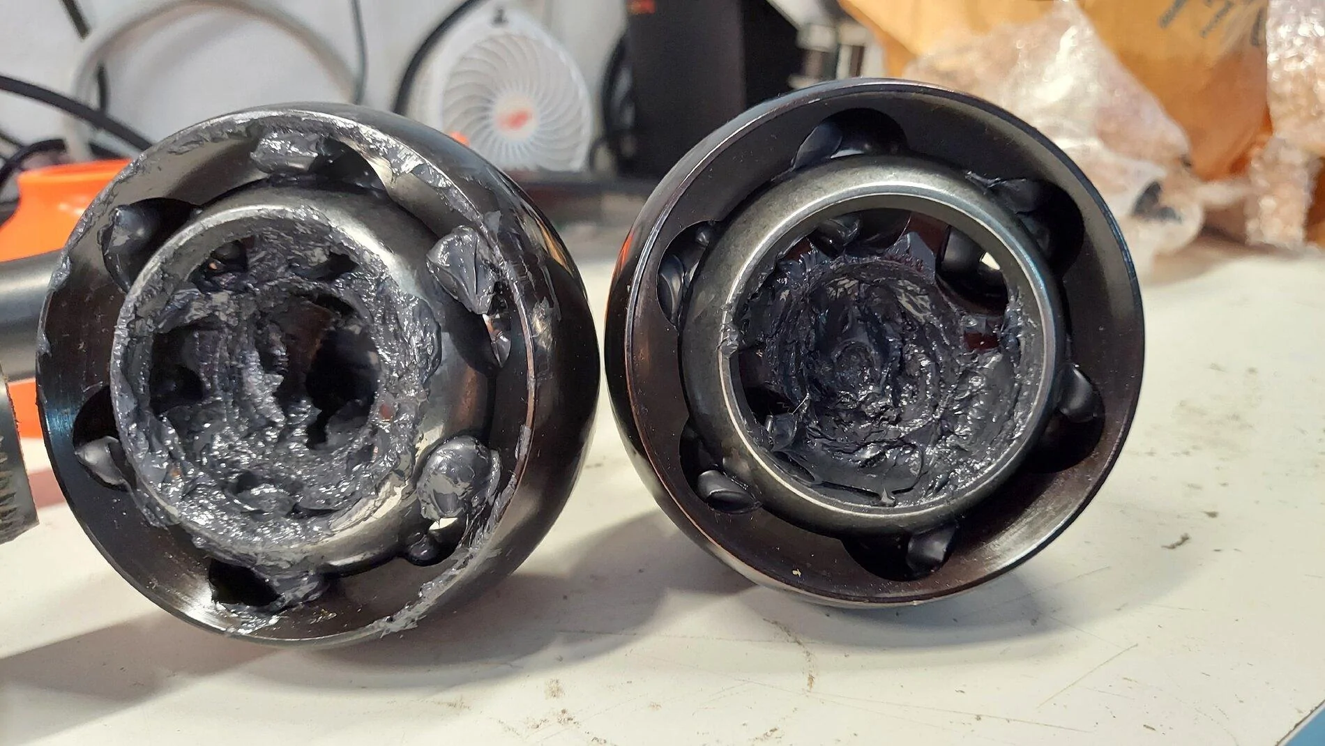

The problem is the u-joint. And what RCV has done is make the u-joint axle less attractive.
  • RCV Dana 44s are stronger than OEM Dana 60 u-joint axles
  • Running RCVs gains more strength than a Dana 60 while allowing you to keep the same wheels, less weight, and more ground clearance
If you look at the tech you will see, RCV's are rated to 43" tires at 32 spline guaranteed FOR LIFE.
That's insane! All backed with a Lifetime Warranty against breakage up to a 43" tire.
You may ask, how is it possible.
Jeep Gladiator Complete Axle Upgrade Bible 20210903_175617
The shaft from the carrier goes into the CV joint. There are 6 points of contact verses 2 ears that support a u-joint. The point of failure is usually the u-joint, so you can go with bigger u-joints
then the ears on the axles fail or whatever.
So let's be honest, the RCV is better than the 35 spline configuration in the front. In my opinion for the money, you can't beat $1400 for a set of RCV's.
