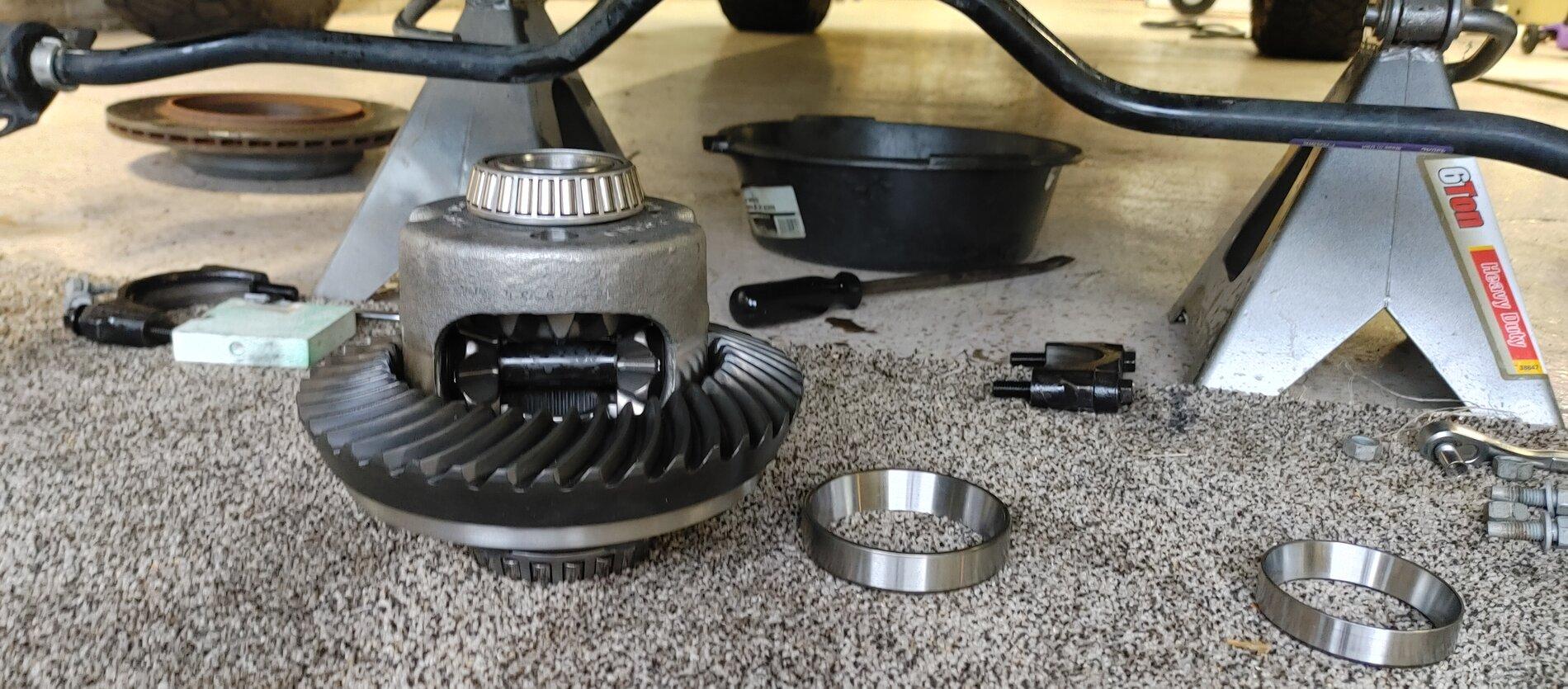

I put the yukon limited slip in the back diff and it went really easy, did not even have to change my shim stack. The truck actually seems smoother. Locker in the front would be great for the north woods.

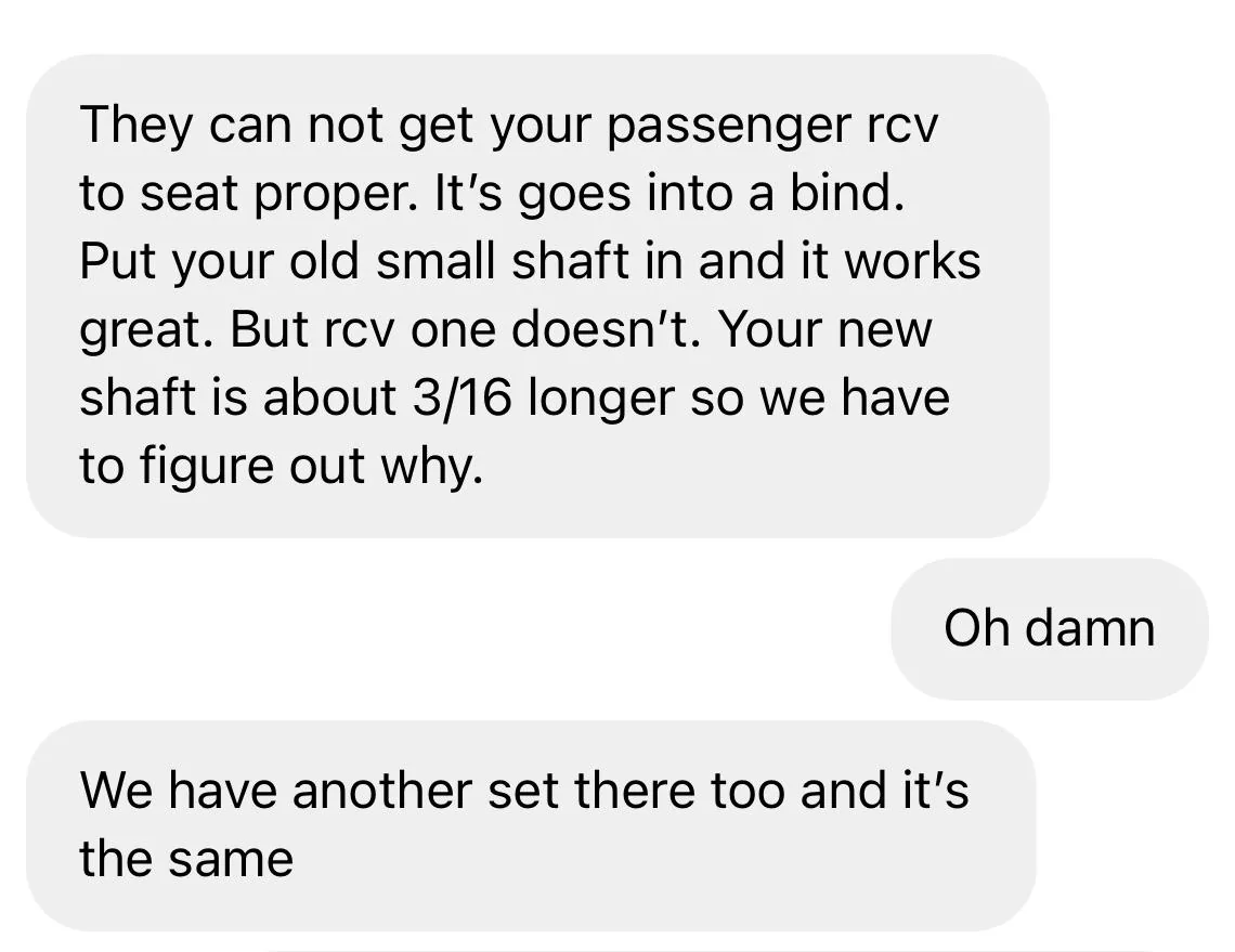

I went with a similar direction...ARB front and rear... on the rear I went with the dutchman shafts and ARB locker... The front I went with RCV for a max tow w FAD... ARB 32 spline air locker- and keeping the disconnect. I have a max tow from factory... but the lengths were all different on the passenger side. RCV is now trying to figure out what parts I need- the stub shaft is not the right size from their kit... So now I have RCV on one side...and factory on the other, until right parts come in? I think the mechanic was on the phone for a couple hours trying to figure out why the parts are mixed up. I think the stub shaft I got was for a non-max tow... making it too short. Even though the box and label and part number shows I ordered max tow set of front axles. but the parts are 10 weeks out... so I guess I'm running the stock shafts on that side until the right rcv shafts come in. Hopefully it will all come together the right way soon!
I also have a Max Tow and half a shaft in the front

Yep... I've got a call into RCV to Dillion who is supposed to get back to me... it sounds like there are at least three of us where the max tow kit for RCV with FAd is not fitting right. Same issue with mine... I guess the center shaft is too long? Maybe it is the ARB carrier that moves the position slightly from stock that has it messed up? Anyway waiting for my call back...

Yes... and one side of the RCV... something is different on the intermediate or middle shaft between the diff and FAD. The stock piece placed in that location will work with the RCV outer shaft... maybe- it will fit anyway. RCV is sending a different part D13362- to replace the part that doesn't work D13458. When I spoke to them today he said they have found more than 10 variations on Max Tow front ends! they had thought there were only 3 (rubicon, Sport, Max Tow)... but some of these front axles are assembled differently I guess.... Anyway- they might need to have parts measured to be sure you get the right ones when you order a kit.
