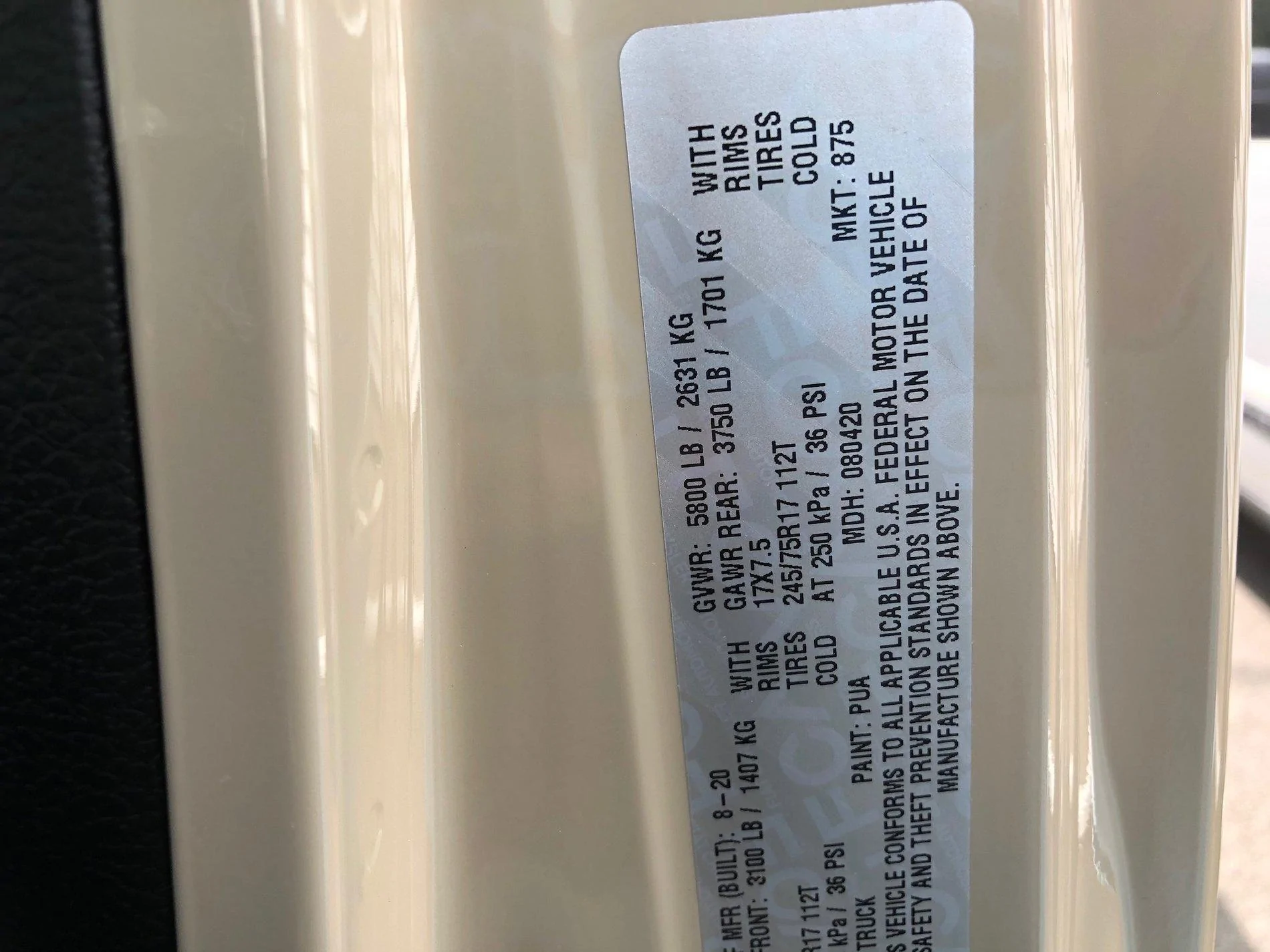

mine is an August build of 20 (ill have to verify, but I believe I saw that last time I looked), and I have the 49 aluminum silver gearing.

On that same sticker is the six digit MDH#(month/date/hour) look for that number.
Mine is 8/14 Midnight 00 , and I have the silver gear with the 49 part number

OK then that confirms sometime during the day 8/14/2020 they changed to the new steel steering box for 2020 models, as @catdaddy63 posted in post #23 that he had a build from 8-14 with new box.

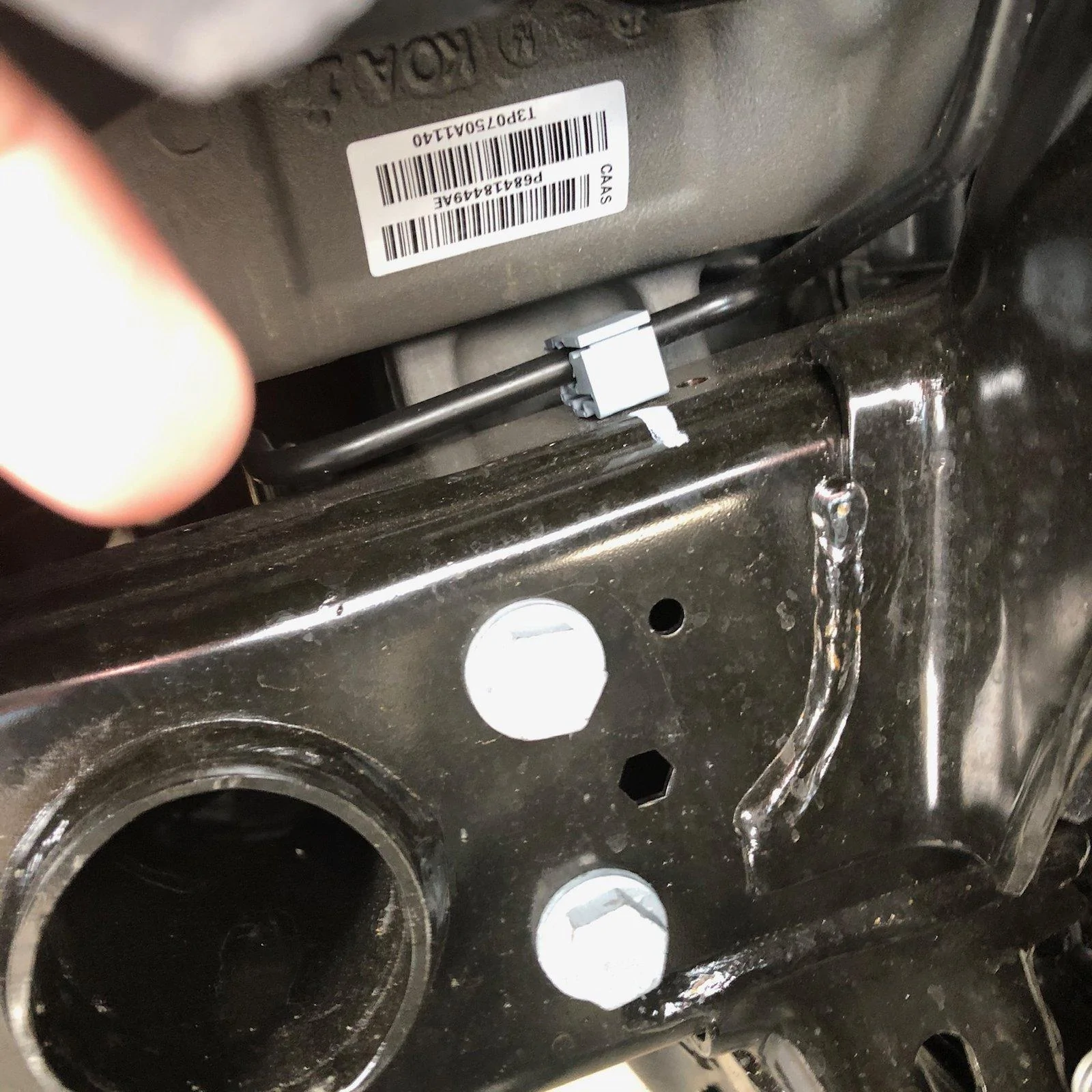

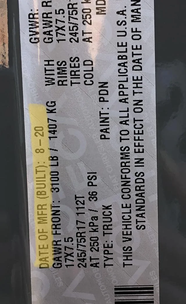

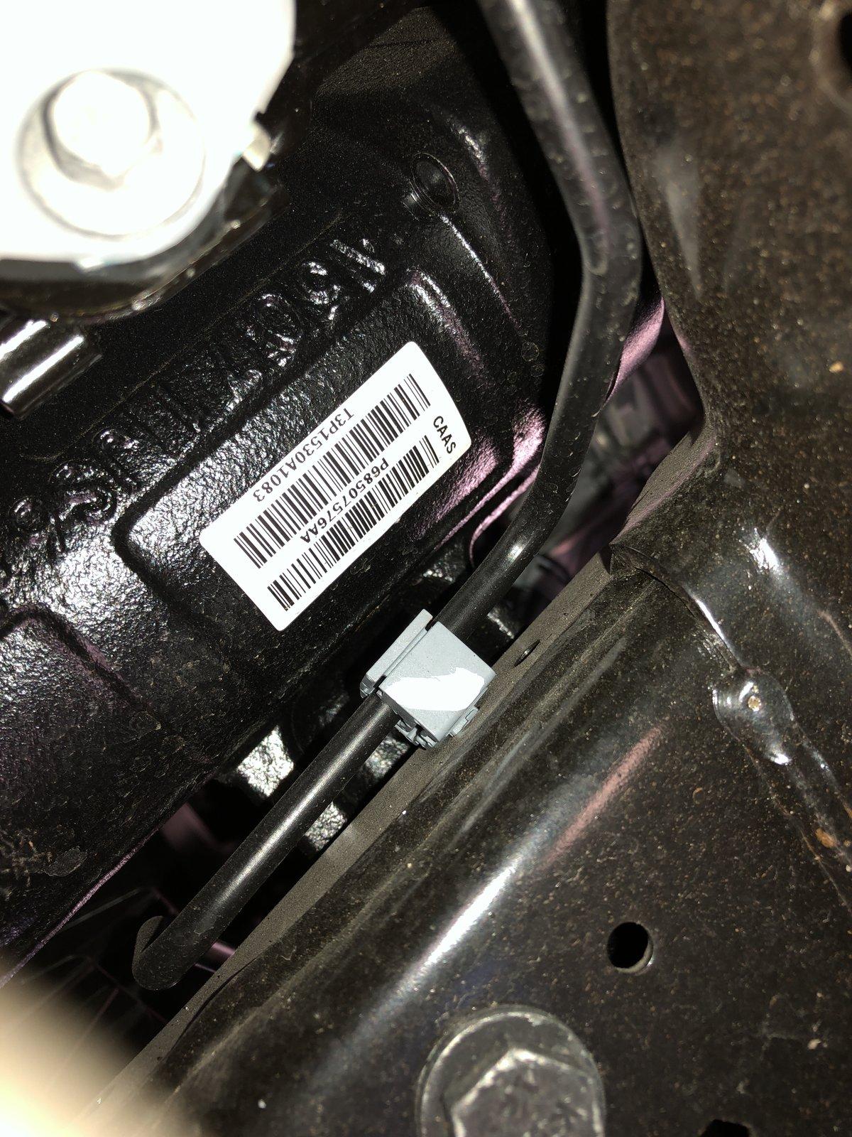

New member here. Purchased my 2020 Gladiator Sport with the max tow package in early September 2020. It appears to have the steel steering box and the manufacture date is 8-20. MDH: 081717. My steering experience always seems fine. See attached photos.
