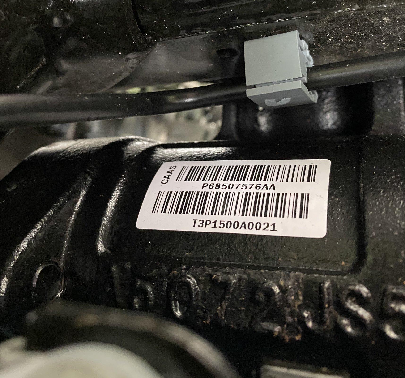

New member here. Purchased my 2020 Gladiator Sport with the max tow package in early September 2020. It appears to have the steel steering box and the manufacture date is 8-20. My steering experience always seems fine. See attached photos.
There is another # on that sticker for the day. I can see in pic "MD" at the top, that's the MDH#. It will be 6 letters long (Month/day/hour). What is it?
